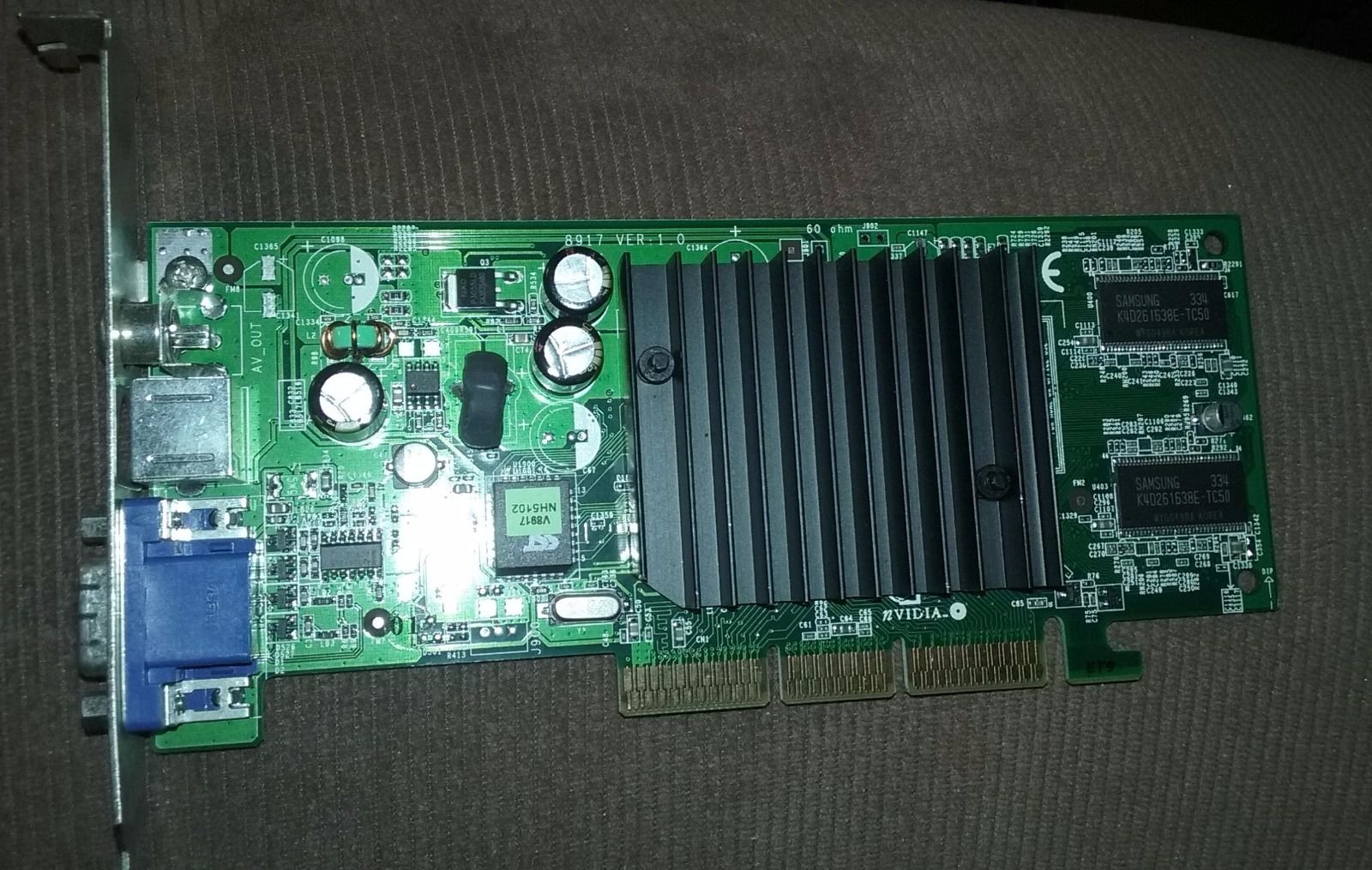

            Re: Asus P4SD-LA ver 1.06
            It's a beastly NVIDIA GeForce4 MX 440 64mb 8x. lol I have a 128mb version but it died.
            Had another freeze and wouldn't boot. Repaired grub and seems to be good now. Not sure why it's locking up though. The ram passes and is 2x 256 and 2x 512 of i think 2700 or 3200.
            The cooler is similar to what is on my amd 4200 x2 and it runs about 30c ish at idle with fresh paste. Don't have conky or anything on it so not sure what it is running.
              HDD alright? Any bad or pending sectors? Anything under Ultra CRC Error Count? Also worth checking your Even Log if you are running a Windows OS.
              Probably ran too hot for its own good. You can try a "ghetto" reflow and see if that makes it come back to life. IIRC, those use leaded solder, so it shouldn't be as hard to heat as current LF PCBs.
