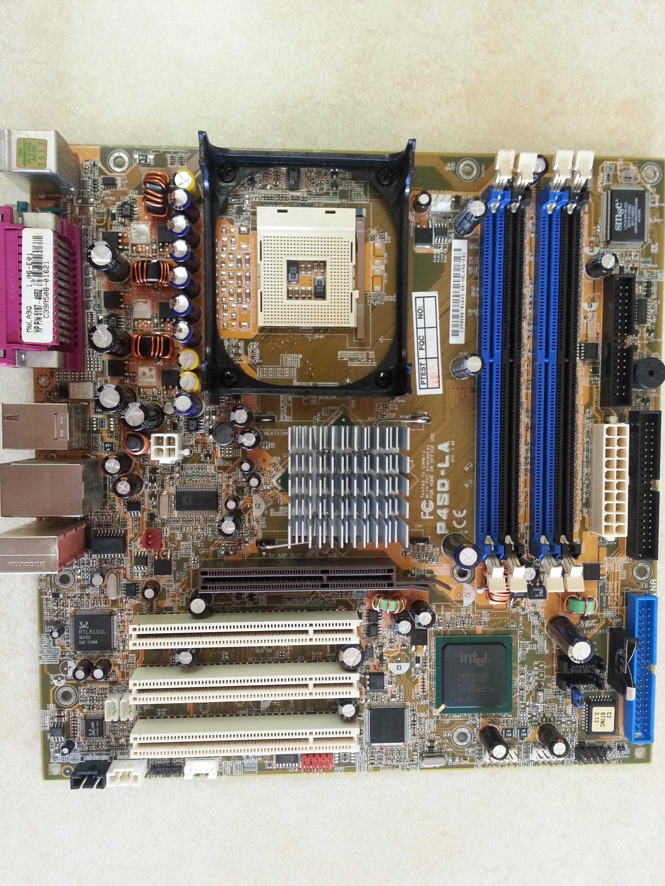

    Hey guys I was hoping you could help me out. My old motherboard has some blown caps and I wanted to freshen it up. I don't know what new caps to get or if others should be replaced that aren't blown and no esr meter to test with.
    I figure the 7 KZG 1800uf 6.3v 8x20mm caps should be replaced.
    How about the yellow 820uf 2.5v caps? Not sure what they are. Has M above 35117 and 55-105c and are 8.5x12mm.
    What you you guys think?

      in the early years when it first came out, they used a blue/silver sleeve i guess? then they changed to the rust brown sleeve we see today. kzgs on my amd s939 board (circa 2004-2005) all had rust brown sleeves. guess they changed it to match the crud we see oozing from failed kzgs. how "fashionable" of chemicon to think of this!
      anyway, suitable series to replace kzgs are rubycon mbz/mcz which can be acquired from the bcn store. nichicon hn/hm, panasonic FJ/FL, sanyo/suncon wg.
      i also notice osts near the agp slot and usb ports/headers. those have to go as well as they are silent killers. they fail without bulging or visible signs. one of our members, pentium4, also experienced glitchiness in his usb devices when bad caps were used at the usb ports/headers on his board.

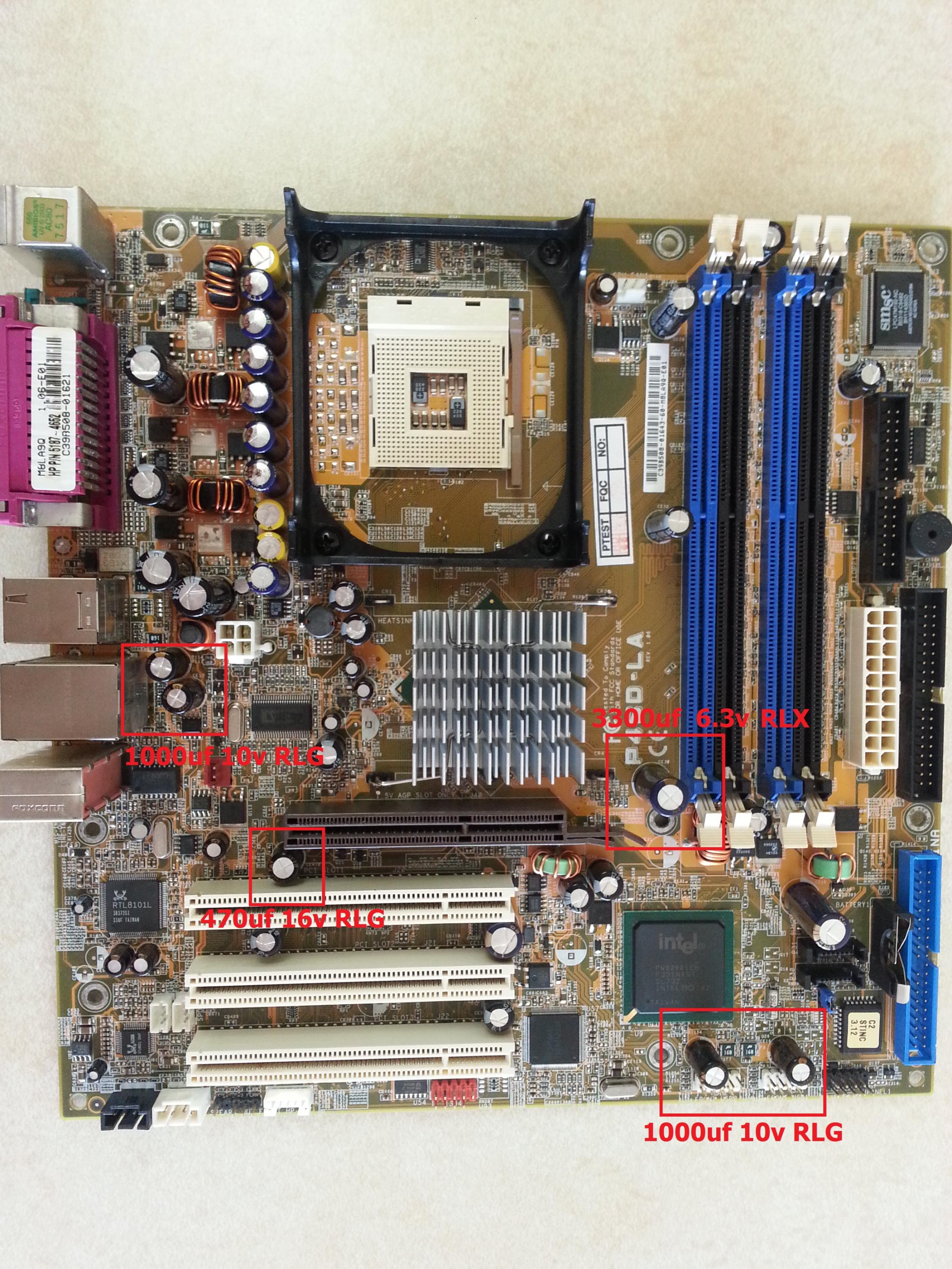

        There is a couple ost. 2 small under the realtec chip and 2 by agp and 2 by the usb plugs.

          1800uF caps in 8mm diameter are hard to find. with how cramped the vrm output area is with caps side by side, only 8mm diameter caps will fit. they dont make 9mm diameter caps. next closest is 10mm.
          btw, the yellow 820uf 2.5v caps seem to be some kind of sanyo hybrid polymer-electrolytic cap. they should be fine.
          the HMs are okay but u have to make sure they are 2006 or newer and not very old stock. the HM series has issues with its 2002-2004 datecodes.
          if there are no other caps and they are all EOL, the only way is to polymod but im not sure if the board will take kindly to polymodding from what momaka posted in another topic:

                I labeled the ost caps. The rest are rubycon or nichicon.
                I should have used a bigger font. Sorry

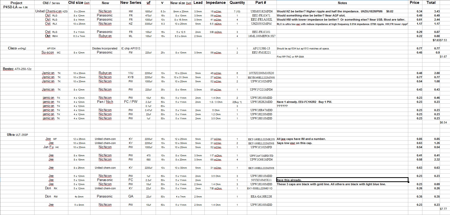

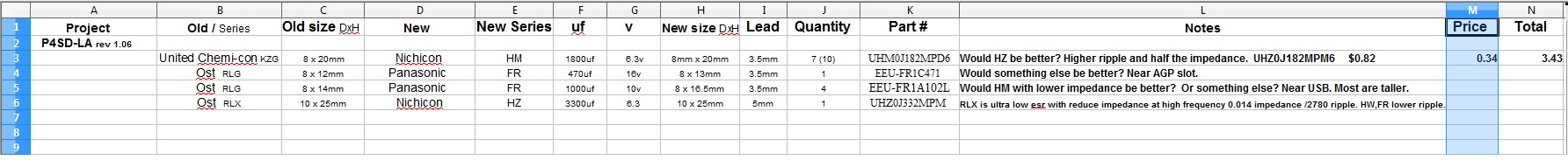

                  Do the caps look like good replacements? The HZ is the only one in stock with the ripple higher than the rlx.
                    Yes, the list you have is fine. Panasonic FR is a really good choice for misc caps scattered on the board, since FR is a long life series.
                    That said, poly-mods work very well on this board, so if you want, you can do the caps around the CPU with polymers. It wouldn't be that much more expensive either.
                    For example, for the 1800 uF Chemicon KZG caps around the CPU, you could use these polymer caps instead (that is, if you don't mind the slightly higher price of 47 cents a piece if you buy 10 of them poly caps):

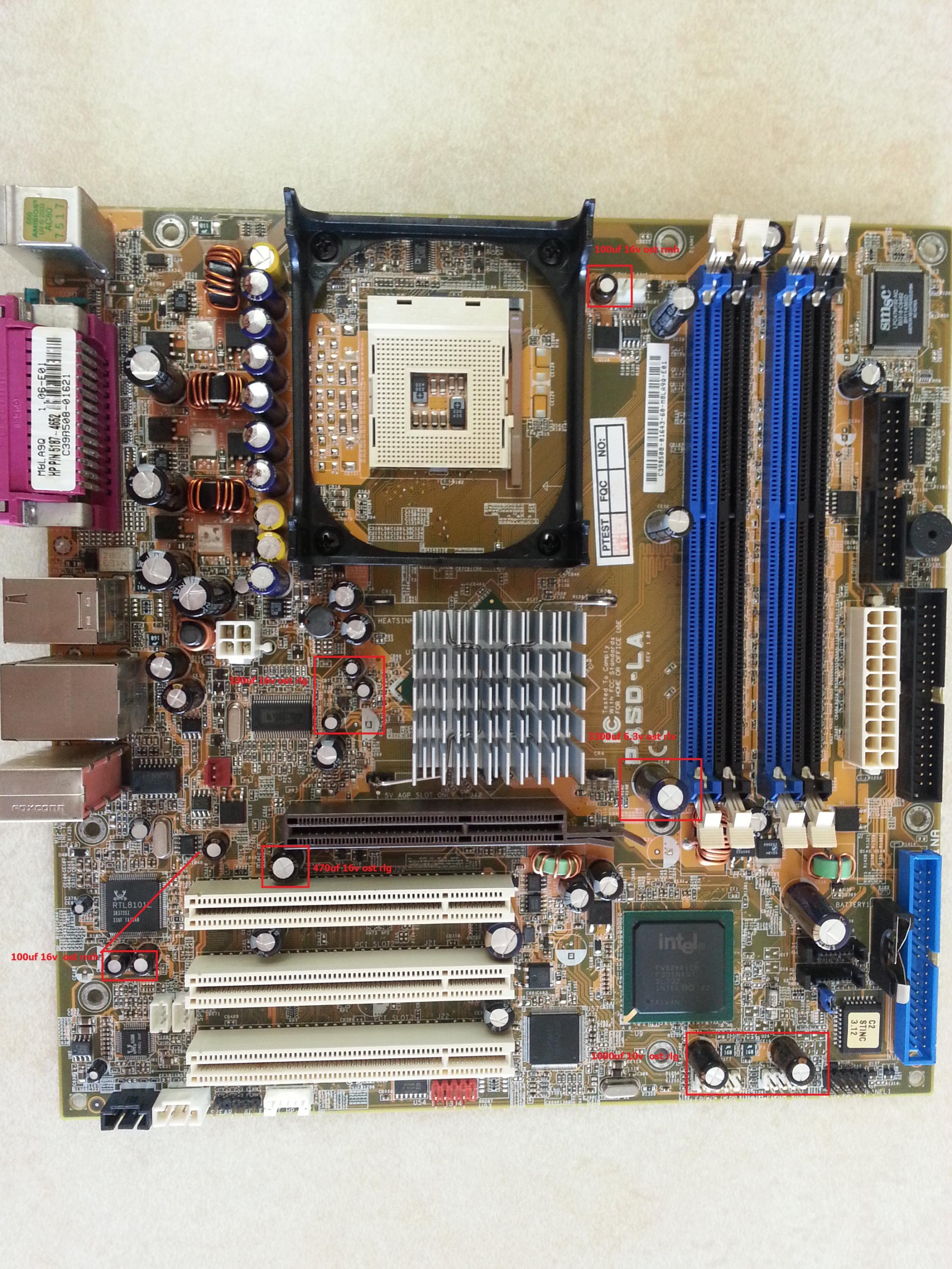

                          Ok I guess i'll go ahead and and replace the 7 100uf caps. I stuck with FR for the 3 since I had picked those on the other RLG. Or should I switch to YXG on all of them? The 4 RMH I just picked a low profile ML.

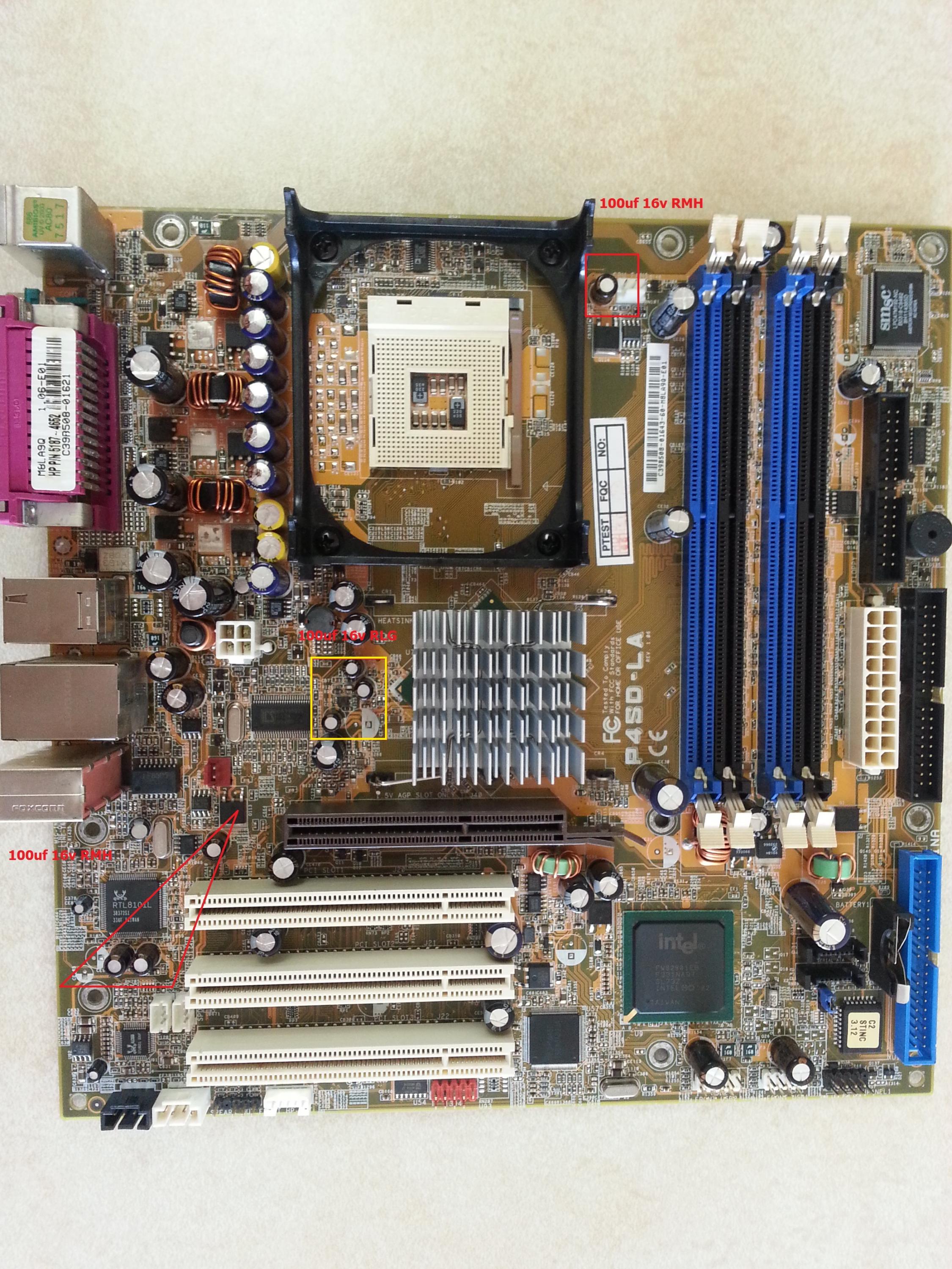

                          Does this look right?

                            Those low profile RMH caps are probably audio signal coupling caps for headphone jack, so I wouldn't even worry about them. Most motherboards typically place them in series with 10-100 Ohm resistors, so ESR doesn't even matter.
                            • junktv
                              • Nov 2010
                              • 3065
                              Re: Asus P4SD-LA ver 1.06
                              The FR are for the 3 by the north bridge that you suggested YXG in post 10. I just figured since i used FR for the rest of the rlg i would stick with them.
                              The 4 RMH are scattered around the board. 2 by middle pci slot,1 by the agp slot and one up by the ram and fan plug. These are the ones I got ML for.
                                Yes, FR is fine too.
                                I suggested YXG simply because I sorted my digikey results by price, and YXG came out as the cheapest. (Yes, I can be a penny-pinching cheapskate sometimes ).
                                The ones close to the fans and RAM are just general filter - again, ESR hardly matter there. So go for whatever you had in mind already.

                                  When i totaled this I thought why not buy a new psu. Then i thought this is 2 and a motherboard with a parallel port. I'm cheap also.
                                  Here are the 100uf's. Made the RLG yellow boxed. The RMH are red boxed. Thinking lan chip for 2 of the RMH.
