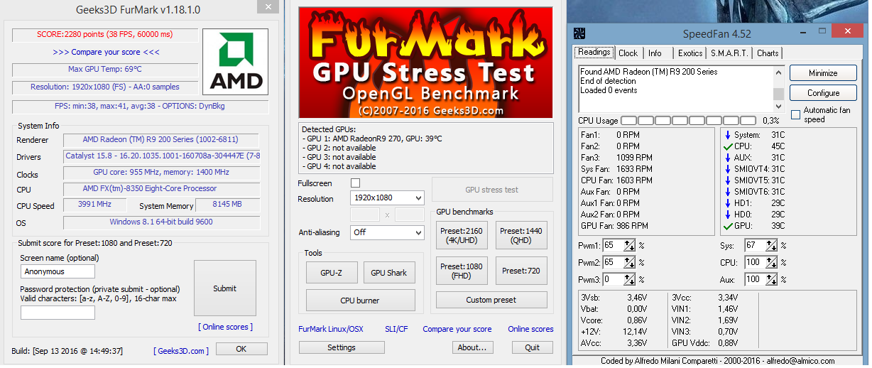

    I recently started getting random reboots on my system. By that i mean no warning, no error, just a hard reboot - black screen and then normal startup. Reasons for that could be quite a few, firstly i thought it was overheating but my CPU wont go above 71 degrees Celsius. I tried to see what conditions it doest that, i played some games like The Crew or WoW and in both cases it would happen, mostly on The Crew is 5/5 and wow 2/5. That bids me to think its high stress. I changed the thermal paste, and it didnt seem to happen for 1 night. The next day it happened on Microsoft Office 2016.
    Ram test - OK
    CPU stress test - OK
    GPU stress test - OK
    PSU - fan works, voltage not checked.
    Below are images of the GPU test and info

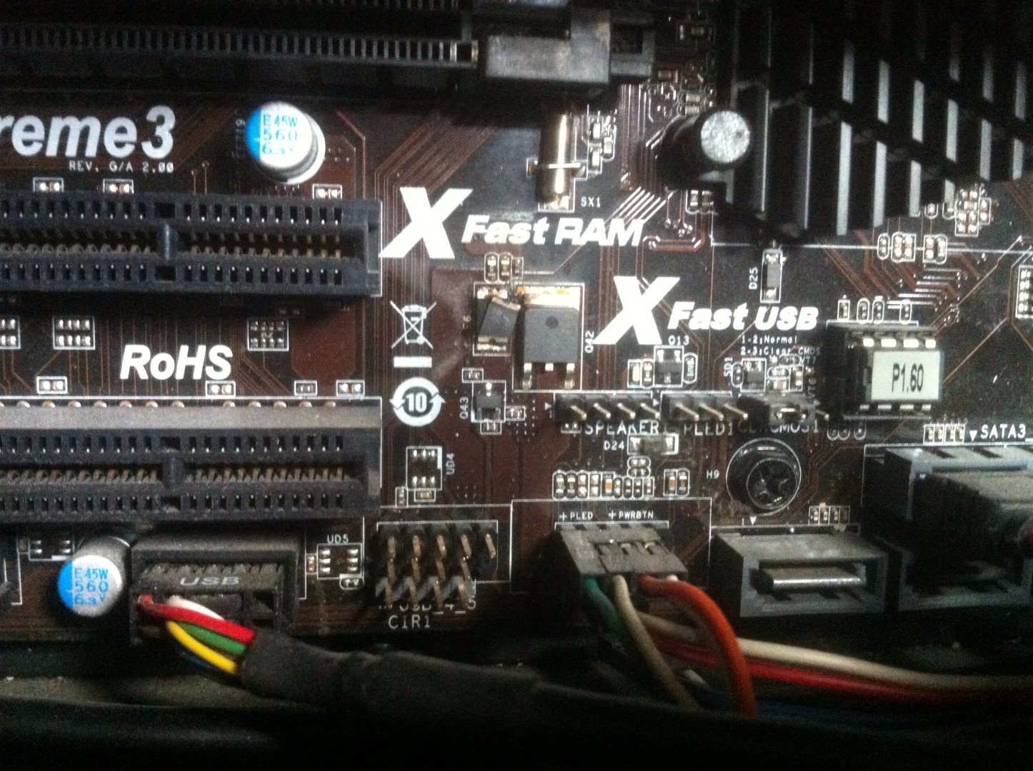

    What worries me is the fact that i have another image from my motherboard, can someone tell me which component this is and why does it look like this? There is dark brown/golden substance around it, some sort of residue.
    my knowledge is limited on this matter.
    LOCATED ON CENTER under Xfast RAM

      anyway, sudden abrupt reboots during heavy load/gaming indicate a failing psu. also, in the picture u linked, it looks like u got a burnt tantalum cap! and its almost touching and shorting the adjacent mosfet! do NOT use the mobo any further until u replace the component. tantalum caps are known to go up in flames when they fail. you do not want to fry your motherboard with a shorted component!

              the thing that is beside that mosfet is not an tantalum cap but a resetable fuse for the usb i think it is tantalum caps are usualy black or yellow and are bigger than that check for shorts/ high power usb devices that are connected

                Originally posted by dragos2009
                the thing that is beside that mosfet is not an tantalum cap but a resetable fuse for the usb... check for shorts/ high power usb devices that are connected
                +1
                That's a USB resettable fuse (a.k.a. polyfuse). Means you either have shorted +5V power on the USB to ground or had a device that overloaded the USB
