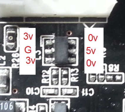

    I have some faulty Razer Naga mice I am working on.
    They have different faults from not being detected by the PC to unknown device to everything working apart from movement.

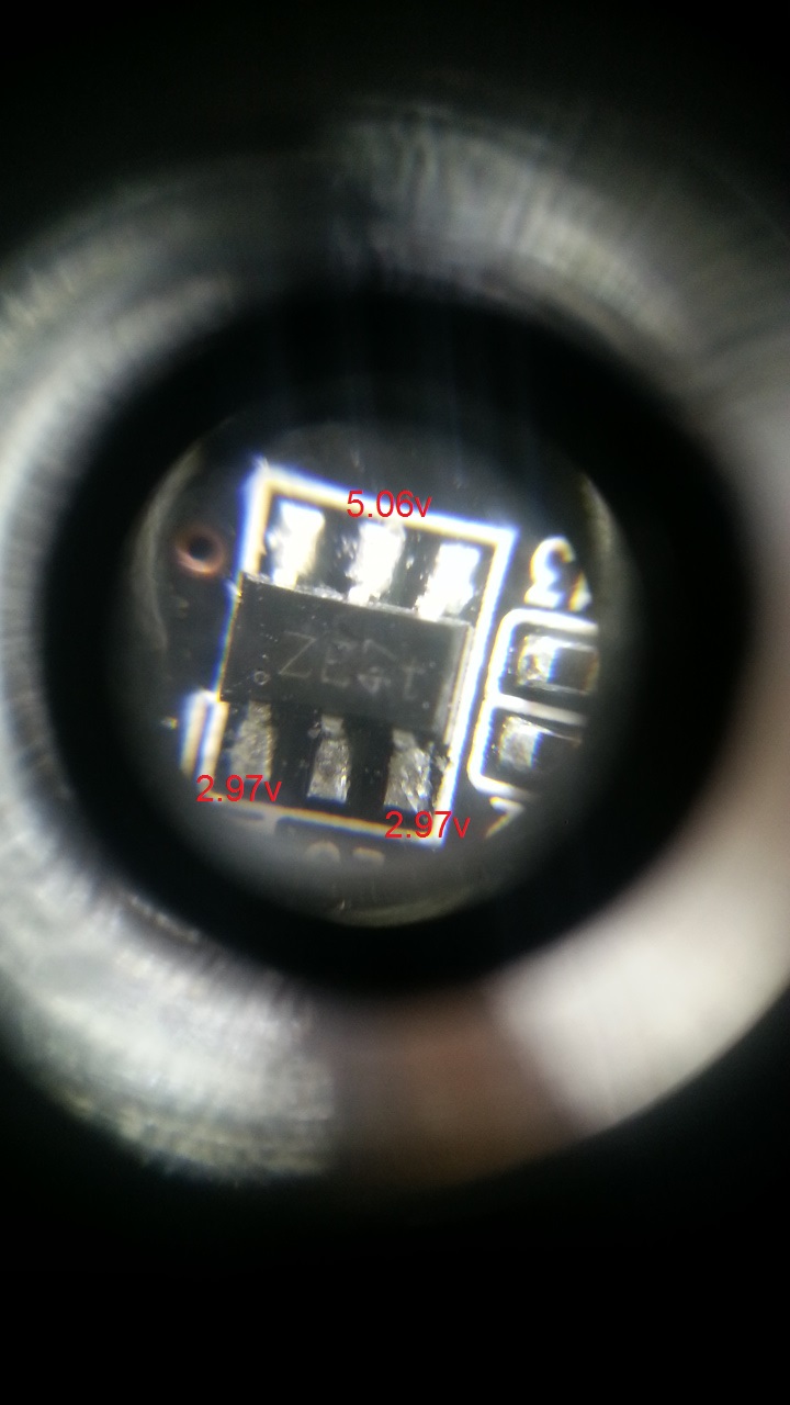

    I am trying to identify the first component the 5v connects to.
    I'm hoping you can help.
    It's 6 pins, the middle on one side has the 5v in and on the other side the two outer legs show 3v, no other voltages to speak of.
    On a mouse that is not detected by the PC, I only get the 5v with nothing coming out.
    Apologies for the bad photo, but tricky using a £2 magnifier and the camera on my phone.
    It's marked ZE then has a 47 on it's side then a t.
    Thank you.

    Re: Razer mouse component.
    3v voltage regulator
      Cheers stj, any idea on the package ? it measures about 1.5mm x 3mm
          the package is just a SOT23-6
          nothing special.
          it may be a dual output regulator from ricoh

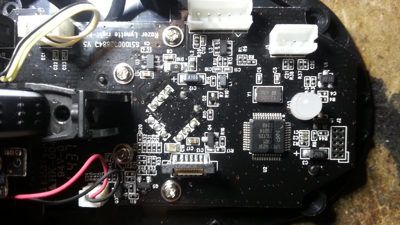

              Thanks guys, it's a Razer Naga 2014.
              The two pins with 3v on show continuity as do the pins on the other side at 0v.
              The Ground pin is opposite the 5v one.
                If the 3V pins are connected, then I would think that the part cannot be a dual regulator.
                It's interesting that the markings of both L3 and L1 have been removed in the full photo. It's also interesting that both parts are identified as Lx rather than Ux. The former is normally used for inductors but perhaps in this case it refers to LDO regulators. Can you identify the marking on L1? Is L1 an IC or an inductor?
                The microcontroller (LPC11U23F) is a 3.3V device (1.8V - 3.6V). If there is continuity between the 3V pins of L3 and the Vdd pins of the microcontroller, then this would confirm the function of L3.
                  Thank you fzabkar, I think it's just the poor lighting and photo that removed the marking from L3 in the big photo although L1 has no markings.
                  L1 looks to be an inductor, as I see little copper coils underneath the top.
                  I've tested the continuity between the 3v pins on L3 and the Vdd and the microcontroller and there isn't any.

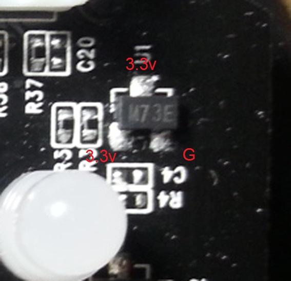

                    OK. I thought that maybe the markings on one mouse were erased, the other not.
                    Could U3 be the 3.3V LDO regulator for the micro? Could L3 connect to the optics?
                    I suspect that U1 may be a PSU supervisor which connects to the micro's reset pin. Its other pins would then be Vdd and Ground.
                      U3 is marked 3A2, two 5v inputs and a ground on one side with 3.3v on the other and a pin that's doesn't seem connected to anything. So yes that looks like a 3.3v LDO regulator something like a LP2980-N ?
                      U1 has 3.3v on two pins and also a ground.
                        I suspect that U1 might be something like this:
                        https://cdn.badcaps-static.com/pdfs/...4d9dac494c.pdf
                        https://cdn.badcaps-static.com/pdfs/...125ed7ee2a.pdf
                        FWIW, a marking code of M73 for the above part denotes a 3.06V threshold.
                                    XC6221A332, Torex, LDO regulator, 200mA, marking 3A2 = 3.3V:
