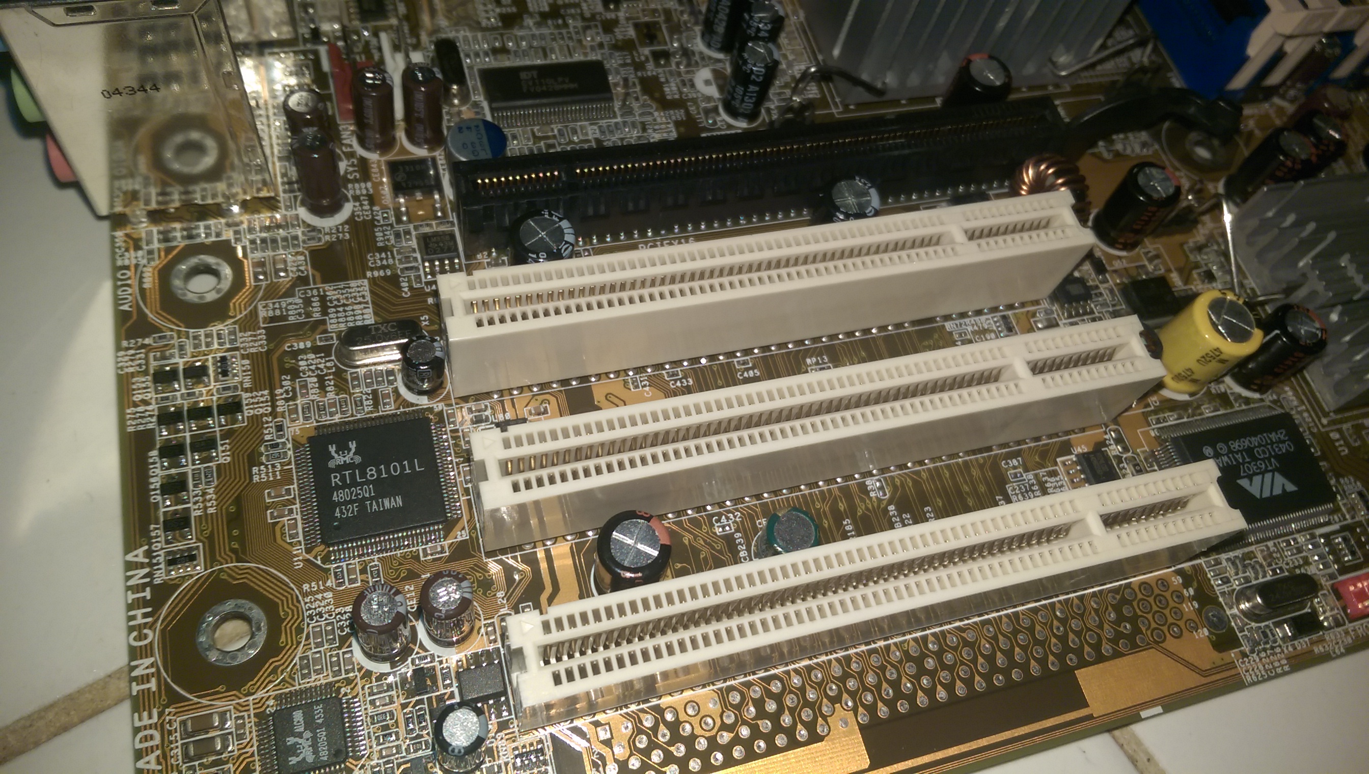

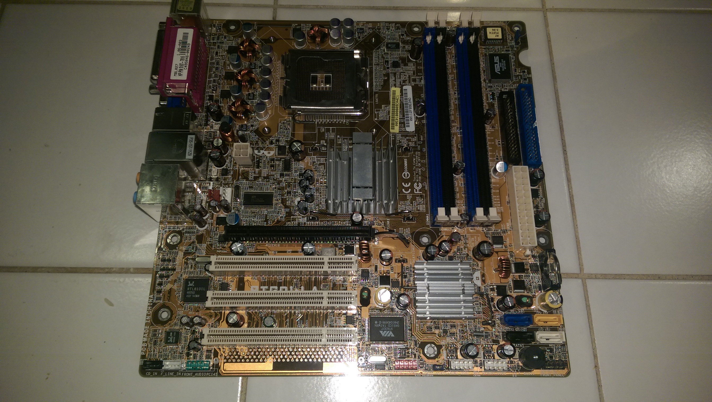

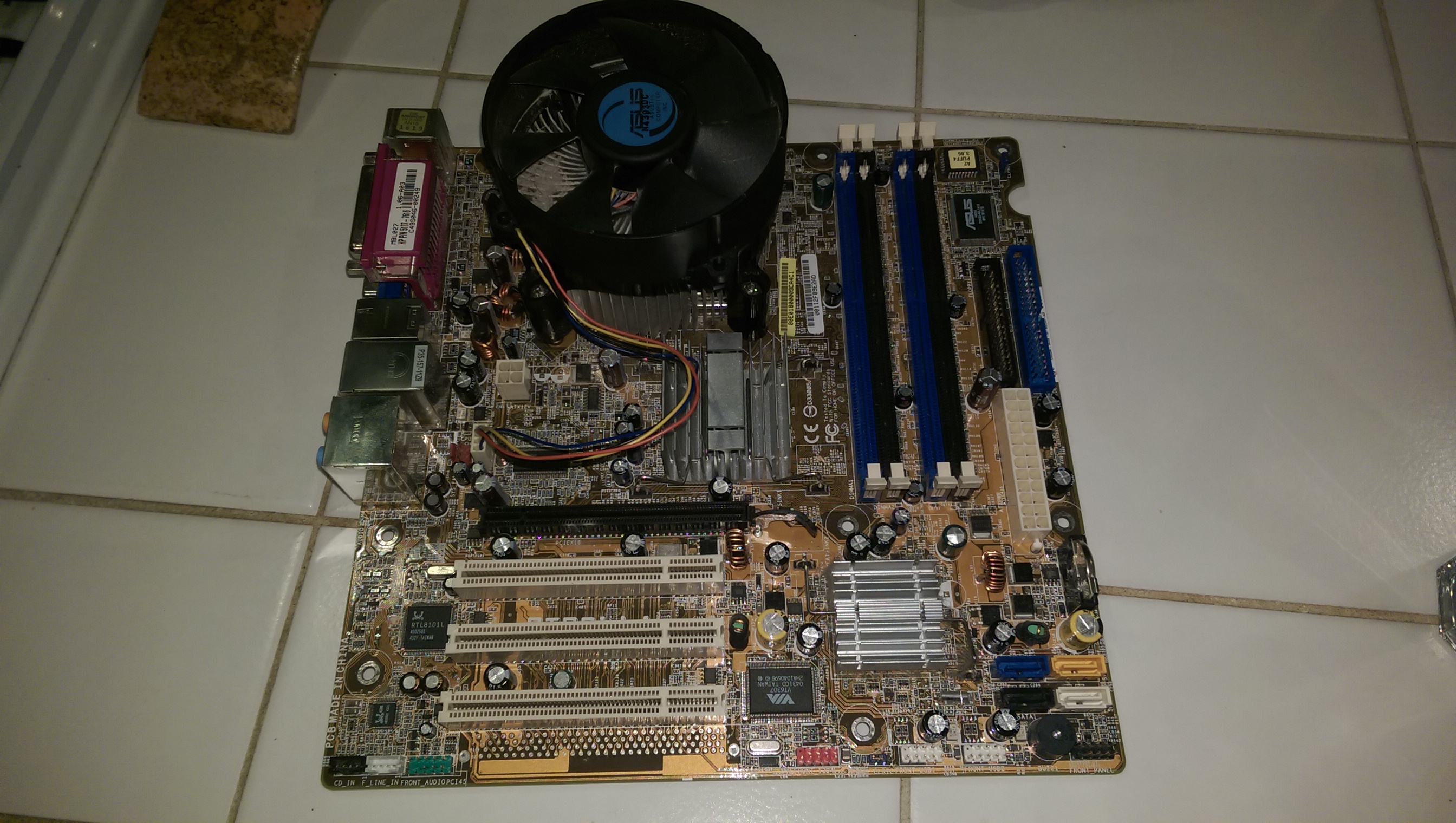

    This thing was handed down to me, I'm the third owner. The previous owners are both now passed away so this is sentimental to me now. I ran it in my file server up until March, 2012 when I saw one of the Ltec caps bulged. Since then, the other Ltec bulged just sitting since then
    I want to re-purpose this as a HTPC. It has a lot of caps on it that are from bad manufacturers. There aren't may good caps at all. There are two Rubycon caps next to the NB chip that I will leave, and two Fujitsu caps that will stay. The VRM low caps are good polymers.
    Besides that, the rest are OST, Ltec, KZG, and GSC. My question is...has anyone ever had any grief or issues from not replacing caps on motherboards in the 330uF and lower range? I only want to do this job once, but don't want to replace more caps than I need to. Last time I recapped an old board, even the 47uF GSC caps tested perfectly in spec, and they were 13 years old. Any shared experience is appreciated

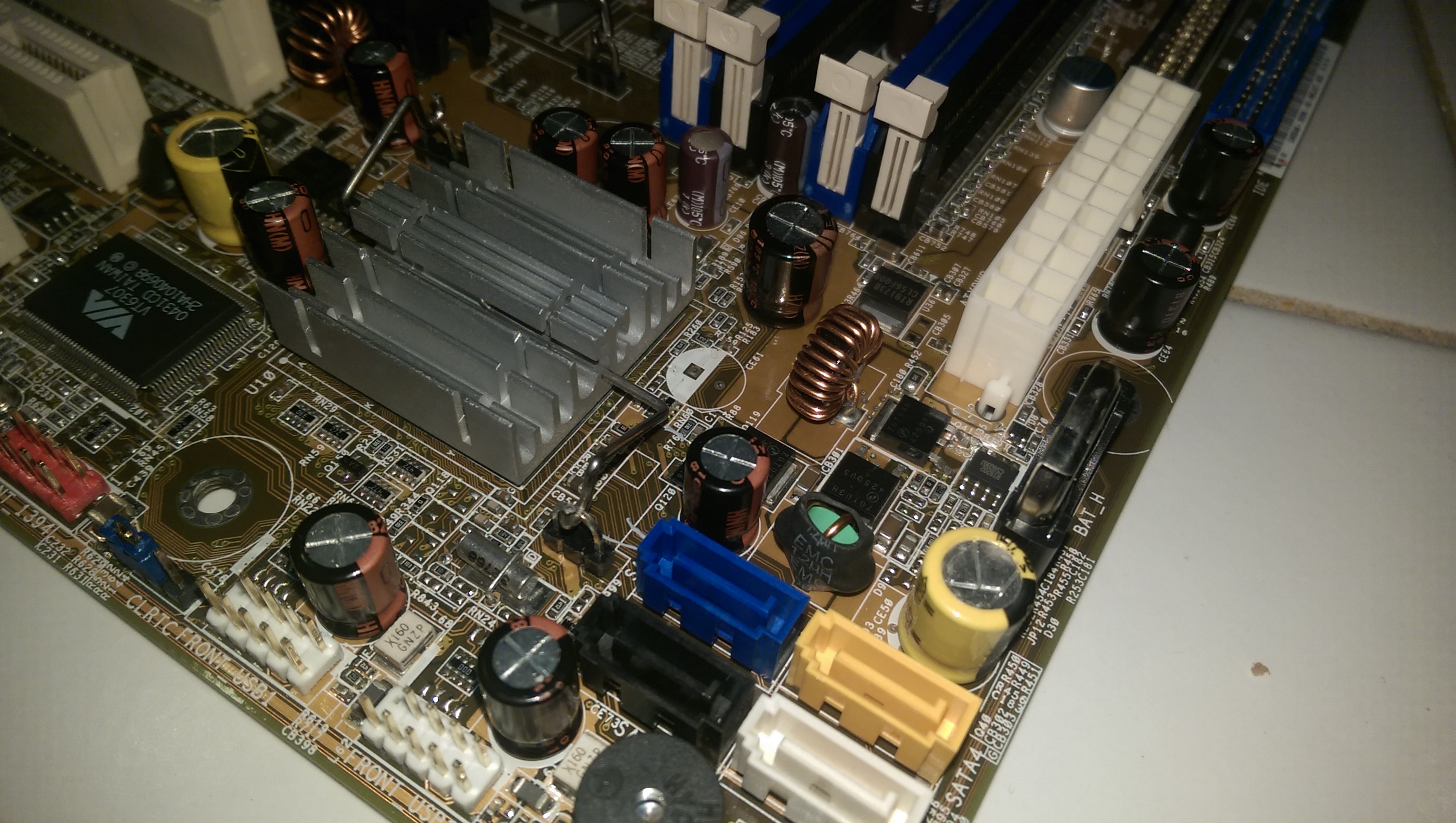

    actually, where a cap is located and what filtering its doing is more important than its capacitance value or can size.
    those 47uF caps are typically tasked with filtering the onboard sound or fan headers right? those arent stressed much thermally or otherwise so its fine to leave them. if there are any caps near the pci-e, agp or pci slot where there is going to be a hot n' powerful video card around those caps, jap caps or maybe even poly modding have to be used there. any non-jap caps or non-polys that arent jap in such a hot location will pop in a couple of years in a cramped htpc case.
    likewise, look for caps near any switching mosfets or chips (NB, SB, LAN etc.)that get very hot during use. those hot mosfets/chips conduct their heat to the caps via the thick copper traces and kill them fast. stick heatsinks on those things and modify the casing airflow over those areas to avoid this from happening.
    also try to analyse the airflow pattern in the closed case. look out for caps on board edges or airflow deadzones without moving air. ghetto mount inside the case a small 40-60mm fan to circulate these deadzones. u can also mod the side panel to mount 120-140mm fans to cool the whole board.
    moral of the story, its better to understand where the hot zones are for a particular mobo & case setup so u know where its going to get hot so precautions (e.g. recapping in the right places) can be taken...

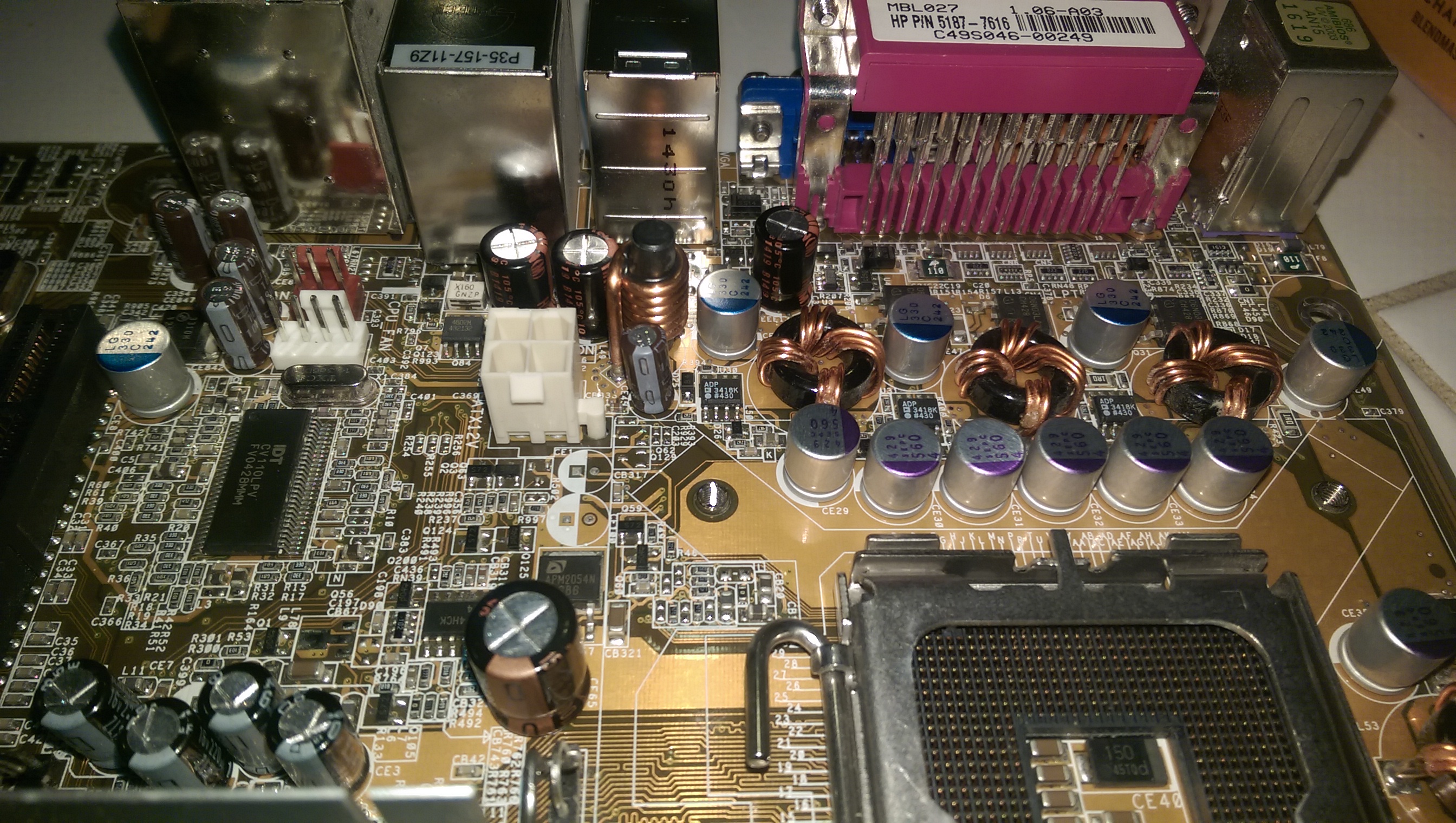

    btw, i see the cpu vrm out uses sanyo sepc polymers right? those are one of the best polys out there. i luv those on hot p4 boards and on my overclocking boards when its going to get toasty there.

      But I usually change caps based on how close they are located to sources of heat and what type of filtering those caps do, just as ChaosLegionnaire suggested.
      In general, crap caps should never be left at the input nor the output of buck-type regulators. You can recognize buck regulators since they have an inductor coil (or two) near them. On your motherboard, there are three (3) of these: one between the ATX connector and Southbrdige (likely for the RAM DDR voltage, so about 2.5-2.6 Volts), another near the PCI-E slot (probably Northbridge Vcc/Vdd, usually around 1.2 - 1.5 V), and the CPU VRM itself (CPU V_core).
      Any caps filtering the PSU outputs should also be changed (i.e. anything directly connected to the 3.3 V, 5 V, and 12 V rails on the PSU). You can use your multimeter to find those, as their positive (+) leg will show 0-1 Ohms to one of the pins on the ATX connector.
      Most of the caps around the PCI and PCI-E slots are usually used for that ^, so again, as ChaosLegionnaire suggested, you should change those if there will be a hot video card blowing air on them. I normally tend to leave them when my cap stock is low, though, since I often leave the cases in my PCs open, and I rarely use high-power cards. Never had a problem yet.
      Everything else is probably behind a linear regulator, so crap caps aren't *usually* a problem there. That said, it's still not a bad idea to replace some of the bigger caps, particularly around the NB, SB, and RAM. But for linear regulator outputs, try *not* to use polymers, unless the cap(s) will be in a very hot spot.
      Also worth nothing is that those tiny caps between the RAM slots are probably for the RAM Vtt (which is half of the DDR voltage, or roughly 1.25-1.3 V). For those, if you replace just one or two, that would be enough. However, your replacement caps need not have the same exact capacitance here. So don't feel like you need to purchase tiny caps just for that. Anything up to 1000 uF will actually be fine (but much less if you really have to use a polymer there).
      The caps that you can certainly leave alone are those that filter the audio coupling, USB power (two caps by the FP USB headers, for example), and some of the other tiny caps by the fan headers and near the LAN, sound, and LPC/super I/O chip.

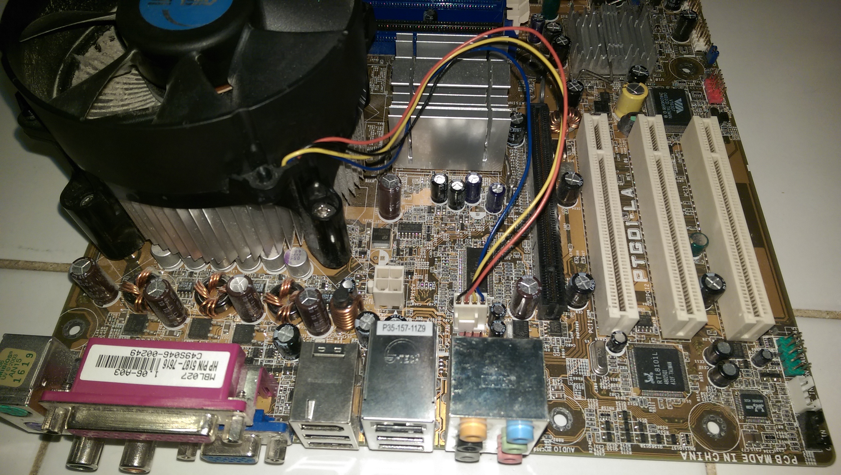

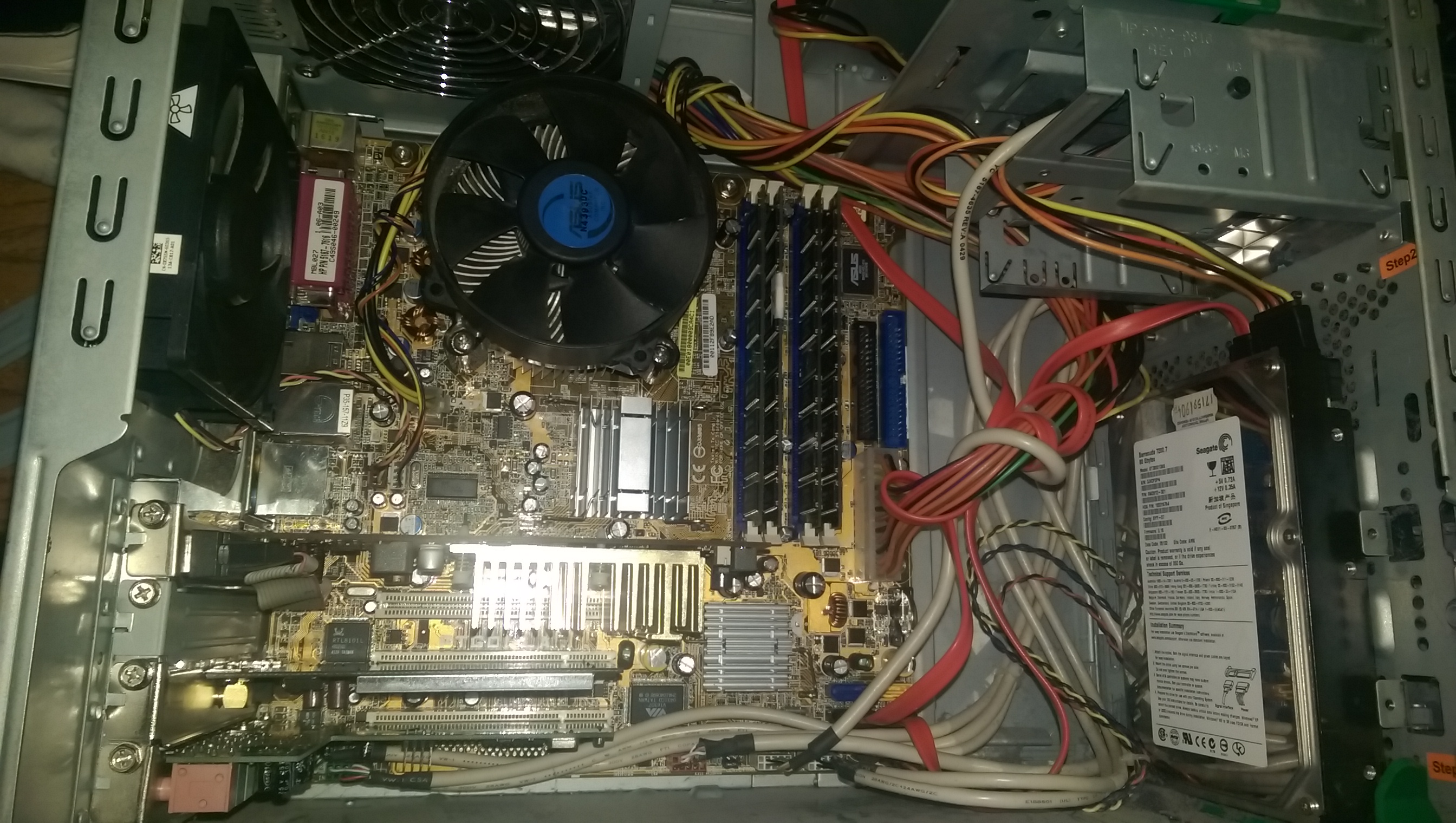

        Thanks for the replies! It's just hard to leave GSC caps even if they aren't likely to cause trouble. Even though those caps between the RAM slots aren't be stressed much, those DDR RAM modules run hot! They idle around 55C on this board.
        This board came with a Prescott P4, but I will be using a Cedar Mill P4 in place of it to reduce heat. It's in a full sized ATX case so heat shouldn't be a problem.
        And we like to view recently taken picture/videos on the big screen so that card reader on the front will come in handy.
        As for video card, this is just going to have a Radeon HD 4350 in it. This one...That I recapped almost 2 years ago, and has had 11,000 more running on it so far with no issues
        There will be a 92mm exhaust fan right above it.

        I've actually had trouble with these caps on multiple occasions. I've seen KZG, and GSC fail in this section before, causing plugged in devices to act funny. I usually replace them
        YES. Love those caps for boards like these
        You mean for those tiny caps? How important do you think ESR is there?

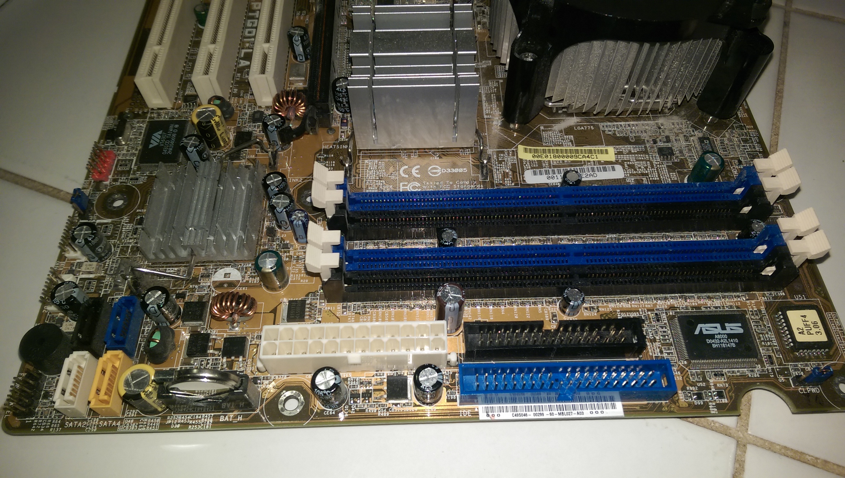

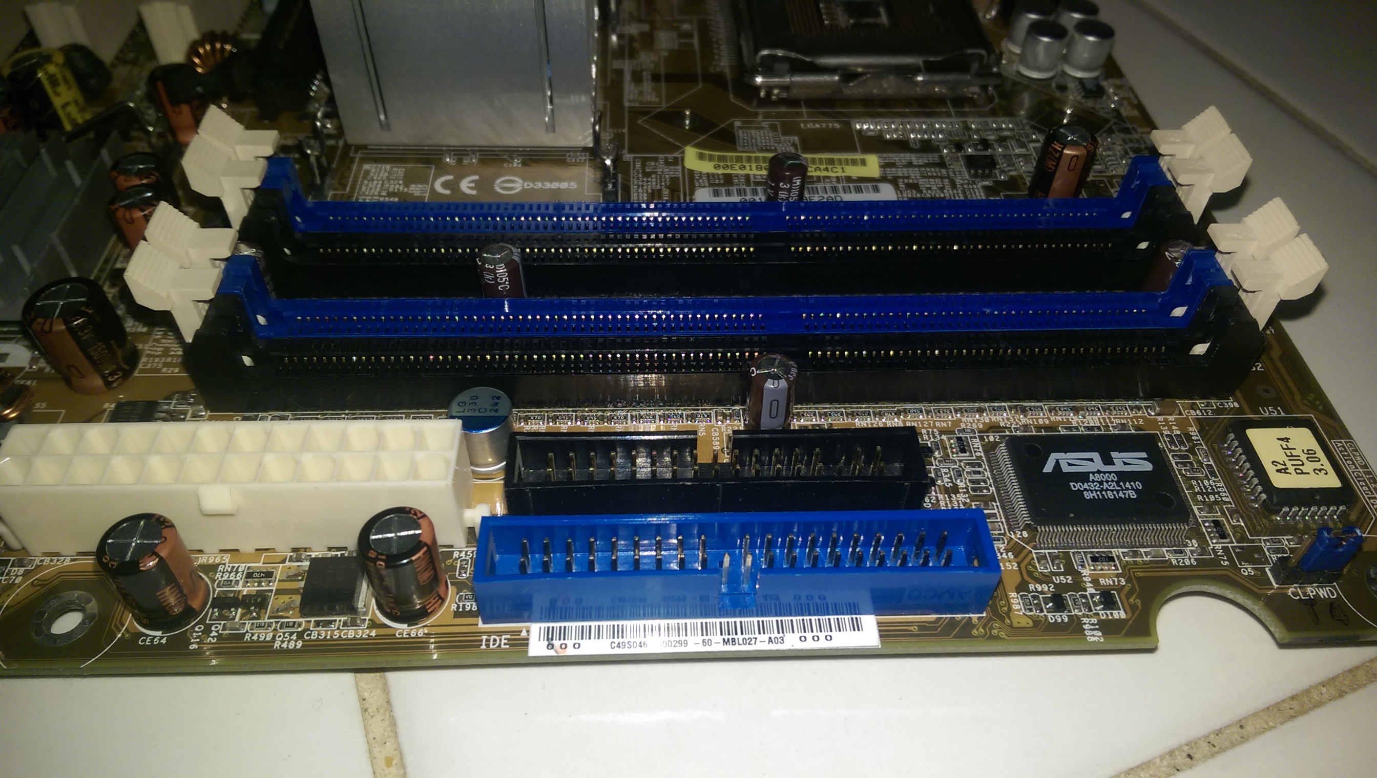

            Was that after you recapped the board or before? Because those bulged caps on the RAM Vdd buck regulator could sure have caused that.

            Not at all. Actually, it's even better if the ESR is *not* too low, because they filter RAM Vtt, which is almost always generated from a linear regulator (on your motherboard, that would likely be that 6-pin TO-252 IC between the ATX connector and the RAM slots)

              So my OCD got the best of me.... I ended up replacing every single non japanese cap. Every GSC cap tested perfect...So did every OST. The KZG were flawless as well. The four 1000uF KZG on the vrm high read 990uF, 1000uF, 1003uF, 1010uF. And all were 0.02Ω ESR. However, if you can spot those four 100uF 16V 6.3x7mm Ltec ST caps by the audio/realtek chip, one of those failed! It read 83uF and 8.82Ω ESR. These caps were old stock even in 2004 though. They were all manufactured on the 43rd week of 2001. I doubt they would have caused any major issues but it's nice to know that they are gone now They were all replaced with 100uF 16V KMG.
              Before. That explains it They didn't even get that hot while running a memtest after the recap!

              The card used to run extremely hot. While in my core 2 system, when running HD netflix it would easily get up to 77C, the highest is ever hit is 84C. I know that's well below the thermal limit for the GPU but I don't like it running that hot. With new thermal paste and that heatsink wedged in there, it dropped the temperature a little bit. After that it never went higher than 73C

              Perfect! I replaced all of those 330uF 6.3V GSC (No series) caps with 330uF 10V Chemi-con KMG.

              So it fired up no problem and ran a memtest for over an hour with no issues. So now it's time for an OS!

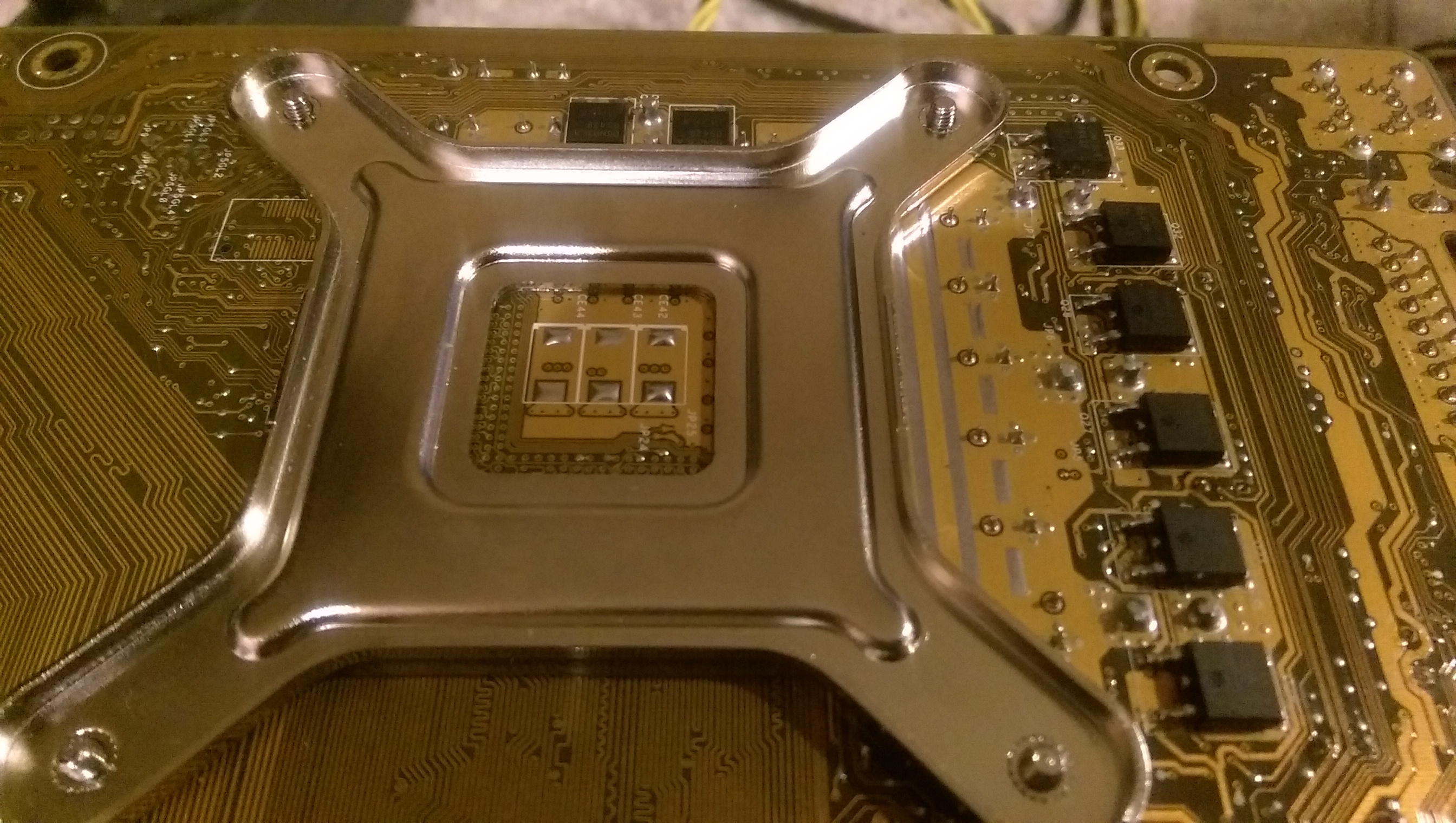

                              Here are some pictures. From the first post you'd think the VRM looked really wimpy...but 8 of the 12 FETs are on the bottom side.

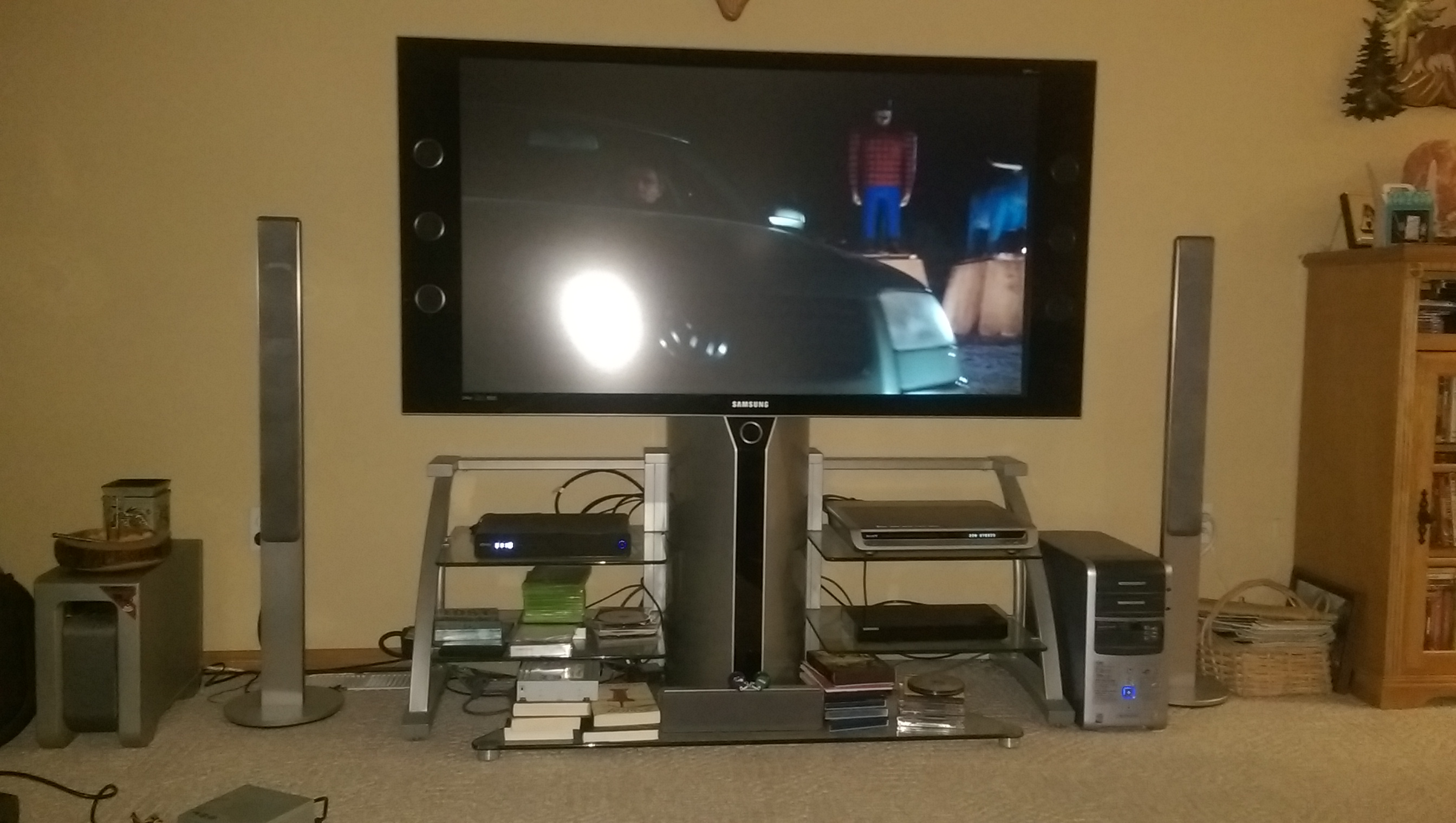

                              Here's a picture of it all assembled. I had to remove the ghetto heatsink on the video card to make room for the PCI wireless card and the Optical audio card. I almost took things too far and even recapped the PCI wireless card
                              The hard drive was later cloned to an 80GB Seagate ST380811AS with a whopping 53,701 hours on it, with no errors. It makes a very loud high pitched whining sound though, so I'm probably going to swap it out soon for something else.
                              It was streaming full HD 1080P with GPU acceleration enabled, and the CPU was averaging around 15% usage.
                                Yeah, I don't know why ASUS does that, but it does work. If there is one thing they DO right, it is CPU VRMs. The ASUS board you gave me has a 3-phase VRM with 6 MOSFETs total. It handles that 150 Watt Pentium D perfectly fine. Moreover, I check the motherboard manual, and what's interesting is that this board was actually built to handle primarily Pentium 4 and Pentium D CPUs - even the extreme edition ones. So that makes me believe ASUS really does put some good thought into their CPU VRMs.
