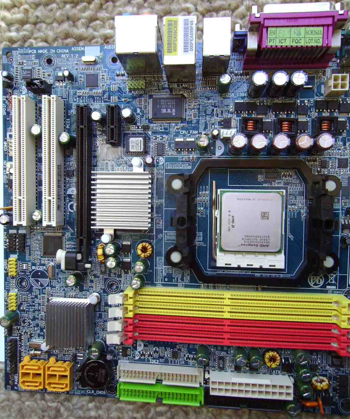

    I'm not having much luck with AM2 boards - this GA-M51GM-S2G looks perfect, but neither onboard graphics nor PCIE x16 slot work
    The board POSTs with a single beep, but I get a display only if I use a PCI graphics card - other than that, nothing
    A clean install of XP with PCI graphics reckons another, GeForce 6100, graphics device is there - but nothing shows up on a 2nd monitor connected to onboard graphics
    If I remove PCI card, and set BIOS to "Set Init Display First to onboard VGA" and "Always output from the onboard GPU", it boots with a single beep then loads XP with no display, presumably without a hitch because it does shut down with Alt-F4 & Alt-S
    I've tried both powered and non-powered PCIE graphics cards, also updated latest non-Beta BIOS F15 - both to no avail
    Any suggestions ? - or is this another nVidia dud ?

    Toss it in the garbage. Bumpgate strikes again.

      Honestly,just because a board has a flaw that doesn't mean it must be automatically thrown in the trash.
      pfrcom - tried reflowing?

        Yeah, classic case of bad nvidia chip... Reflow the die only, there is nothing wrong with the solder balls connecting the chip to the mainboard in this case. You can use anything from a hot air gun to a mini torch - these chips can take a lot of abuse. Cover everything else with tinfoil and leave only the die exposed. Hit it with a lot of heat for 2 minutes, let it cool, should work.
        Being a desktop board, it has good chances of living 1 year or 2 if there is a big cooler on the CPU or if you add a fan to the chipset heatsink. Also the use of dedicated graphics on that board is preferred. If you can keep it under 60C it will live (almost) forever.

          My thanks to Dan81 for encouragement, and Th3_uN1Qu3 for advice
          I covered the area with tinfoil, exposing just a tiny square corresponding to the northbridge die, then gave it 390c from hot air station for ~3 minutes
          Then switched hot air station off, keeping hot air nozzle on die while letting station go through its cooling down cycle to 100c after which it powers itself off
          Left board for a few hours, then reassembled with Arctic Silver 5 between northbridge and its heatsink
          And ...
          ... onboard video works
          I'm satisfied with GeForce 6100 graphics - will heed advice and leave PCIE slot vacant
          CPU cooler is stock AMD type which vents air in four directions, hoping that will suffice to keep northbridge happy - I hate fan cooled stuff

            I said dedicated The use of onboard graphics will stress the chipset more.

                  At least PCIE slot now works also
                  Although board is quirky - sometimes hangs when switching from text to graphics, or vice versa
                  For example(s):
                  Hung after I pressed Enter to accept default Y for Save BIOS settings
                  Also hung on last reboot of a fresh XP installation, at final point where BIOS hands over to OS, after it says DMI updated
                  However, considerably better than it was though

                        Well, it lasted a bit over 4 months of intermittent use, then just recently the PCIE 8400GS card didn't display anything
                        Its on-board did still work, although not for long, didn't work when I tried it the following day
                        And I'd changed the processor HSF to one of those AMD ones where fins vent in four directions, so VRM capacitors and Northbridge heatsink were both getting some airflow

                          did u try to keep it under 60°C? looks like bumpgate and being a fan cooled hater did not mix...
