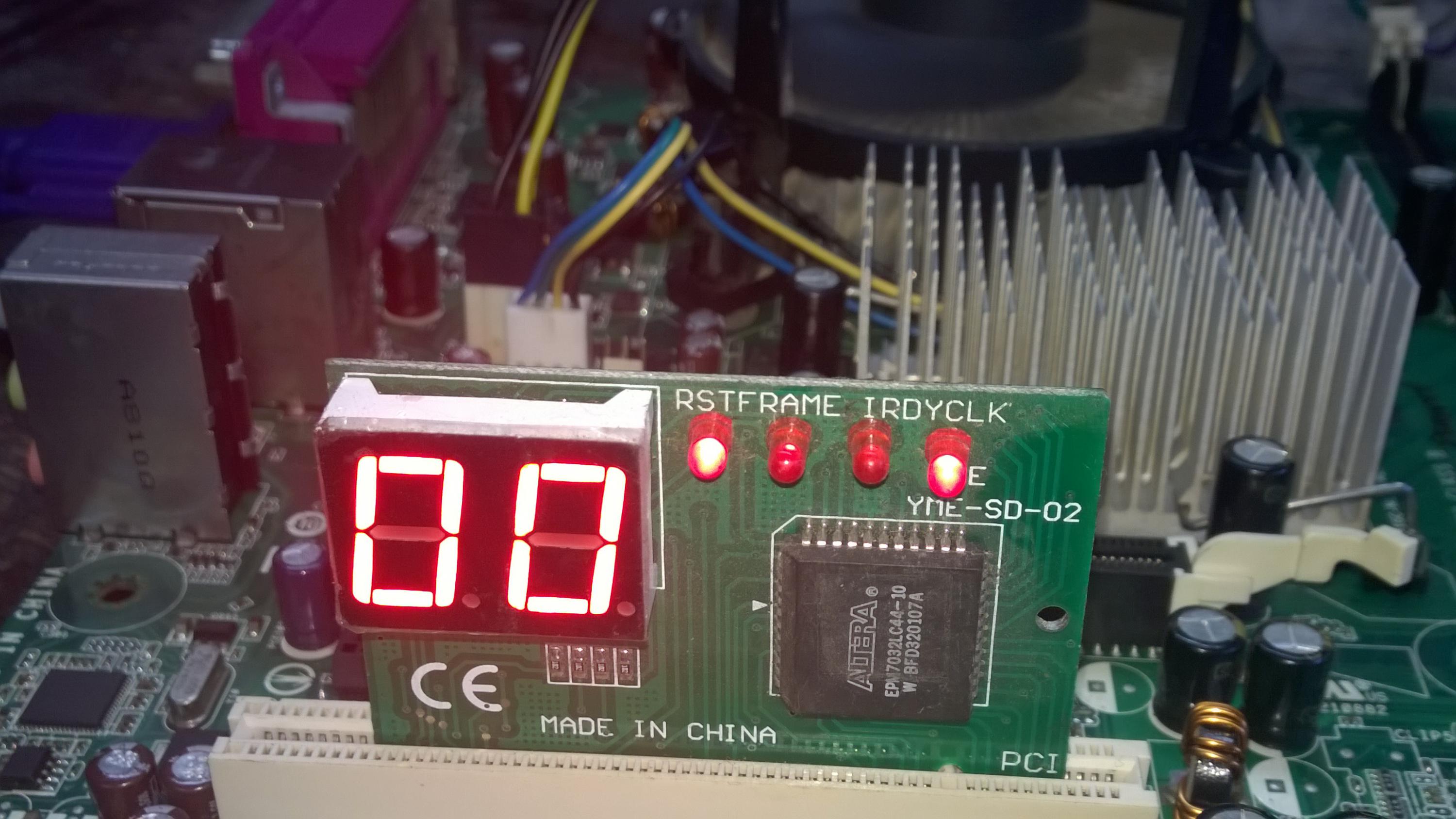

    when i power on. fan runs good processor smooth heat coming. no any beeps
    . without ram also no beep code coming .
    debug card also showing 00 code .
    NO DISPLAY

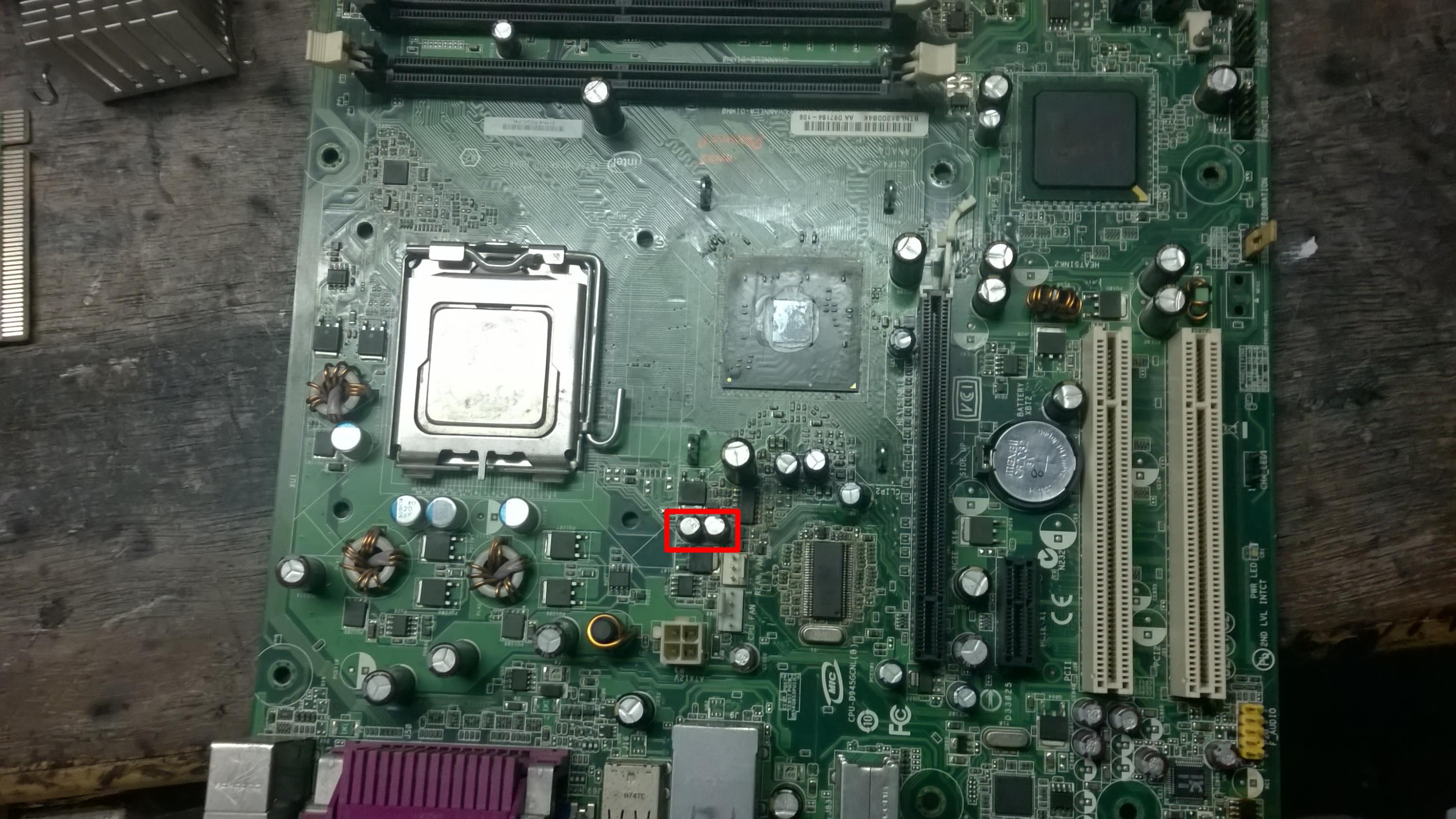

      Re: Intel motherboard [d945gcnl]
      this one
        • 31246
        that them - they probably get cooked.
