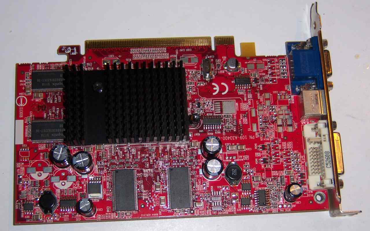

          I don't know if people would classify what I see as artifacts. This starts as soon as the BIOS lights up the display in POST. It looks to me like blocks of the framebuffer with half the pixels missing are echoed in multiples of 4 or more, but also like sync is randomly missing. It makes figuring out where a mouse pointer points difficult, because it's a rectangular blob or blobs instead of a pointer.
          The X600 currently installed looks like this one.

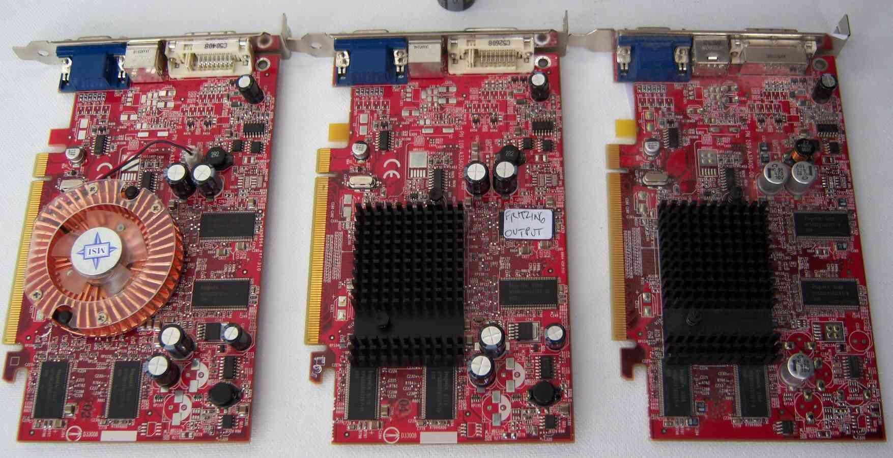

            The single pic and the middle of three is the fritzing card, which was reliable in virtually continuous use for over 6 years. The left two are MFI brand acquired many moons ago. The right I have no clues who made, and cost $8 on eBay last month. I noticed the heat transfer pad had become unglued on the frizter, so replaced it with fresh silver compound, but it didn't help. Cleaning its contacts with pencil eraser and spray contact cleaner and trying in another machine didn't help either. I bought an X800 from eBay last month too. It has the same problem on VGA output, no output on DVI, so I got a refund from its seller.
            The OS/2 machine is multiboot on a 1400x1050 display. IIRC, Linux will use more than 128M of RAM when I connect it to a 1920x1200. I once made the mistake of buying a 128M RAM card, and hope I will remember not to do that again.
            Caps on fritzer: Nich HC 470uF 10V H0524 10x13; Nich HM 470uF 16V A0447 8x12; SMD poly 100uF 16V E45 7x6. I removed the 2 HC closest to sink to check: near spot on uF, somewhere between 0 and .01 ESR. I put them back and the bad behavior that didn't always happen before warm up before began right away in cold POST.
              That be artifacts are.
              Time for reflow it. Or sell for parts or repair on eBay (or elsewhere) if you don't want to mess with it.
              My guess would be those passive coolers are too small and eventually the heat cycles cracks the joints on the GPU BGA. RAM should be fine.
