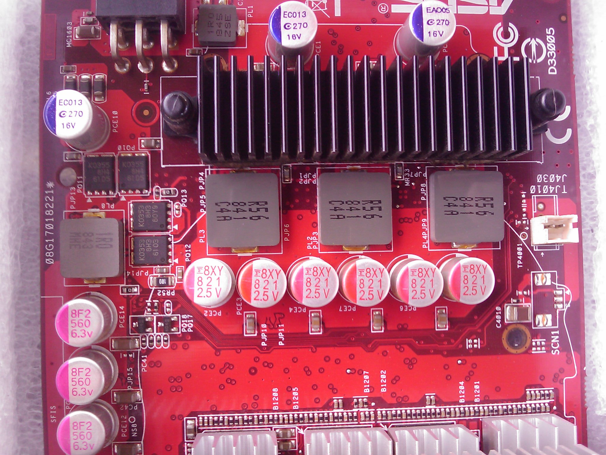

    I need help to identify the capacitors on the graphic card (Asus EAH4830)
    as shown in the picture:
    http://imagebin.org/309907
    My guess:
    - All solid polymer aluminum capacitors.
    - Those 6 in the middle: 820uF 2,5V
    - Those 3 at the bottom left: 560uF 6,3V
    - Those 3 at the top: 270uF 16v
    (please correct me if I'm wrong)

    Re: Asus EAH4830 capacitors
    the 2.5V 820uF caps are Fujitsu FPCap (They're still sold, but they're owned by Nichicon now I think. Not many people know this, but that series comes in two varieties, a 2,000 hour part and a 5,000 part. There's no way to tell them apart AFAIK).
    the 6.3V 560uF caps are Enesol, and the 16V 270uF caps are Capxon.
    I don't think you're going to gain anything by changing the caps, and it's not worth the risk or expense in my opinion, especially since the VRM is the first thing to go on Radeon 48xx cards, and it has nothing to do with the capacitors.
                Originally posted by mockingbird View Post
                the 16V 270uF caps are Apaq.
                FTFY. They not CapXon. Not that Apaq are any better, though.
