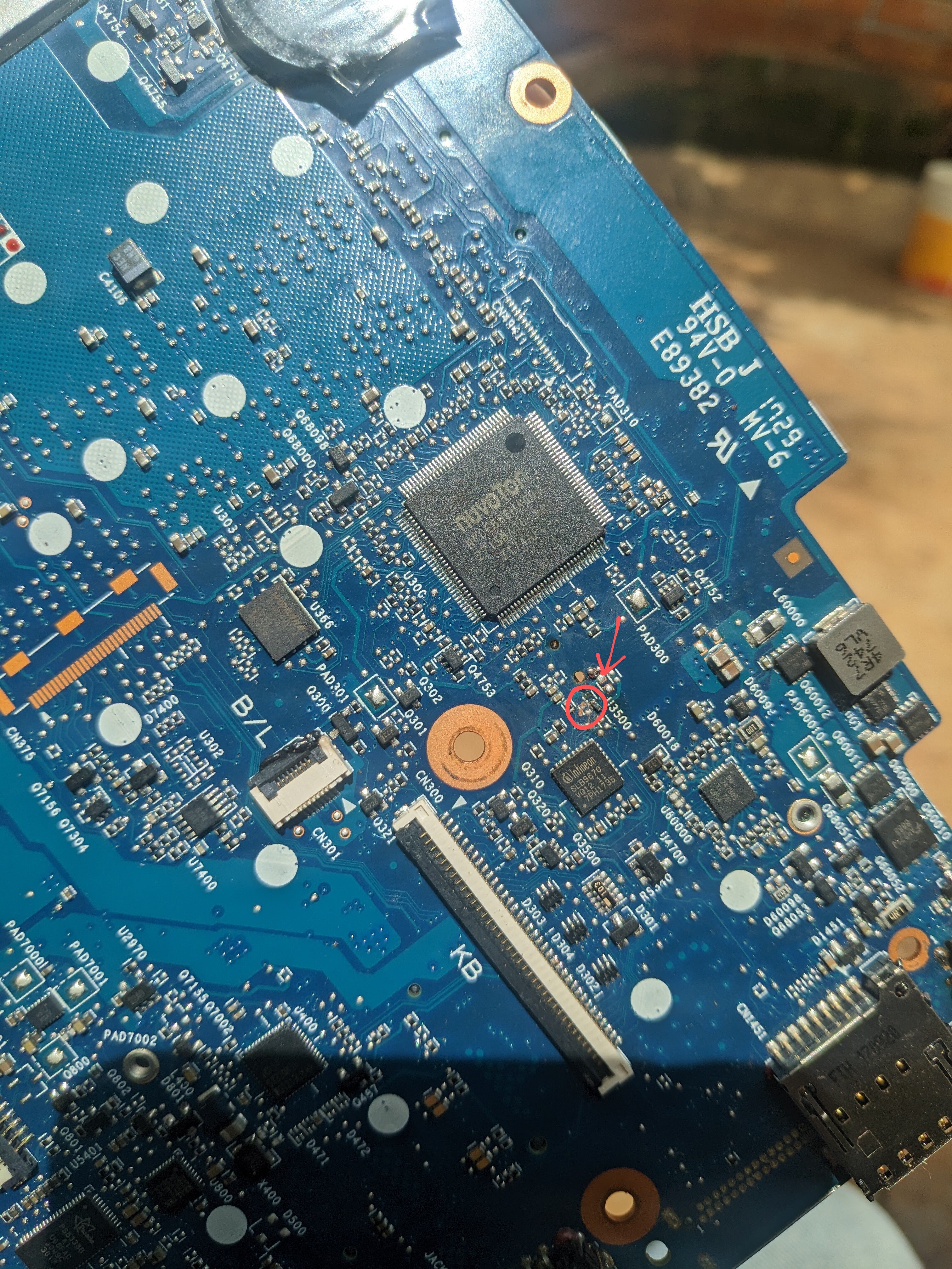

Hp elitebook 820 g3 help me measure the marked resistors
  • sarry86
    • Jun 2021
    • 90
    • Tanzania
    Someone help me measure the marked resistors for me as it has been very hard to find the schematic for this laptop, capslock and numlock blinking five times then fan spinning at high speed, wrote different bioses provided by users here to no available. Please help 6050A2892301-MB-A01
  • sarry86
    • Jun 2021
    • 90
    • Tanzania
    Anyone?? Please 🙏

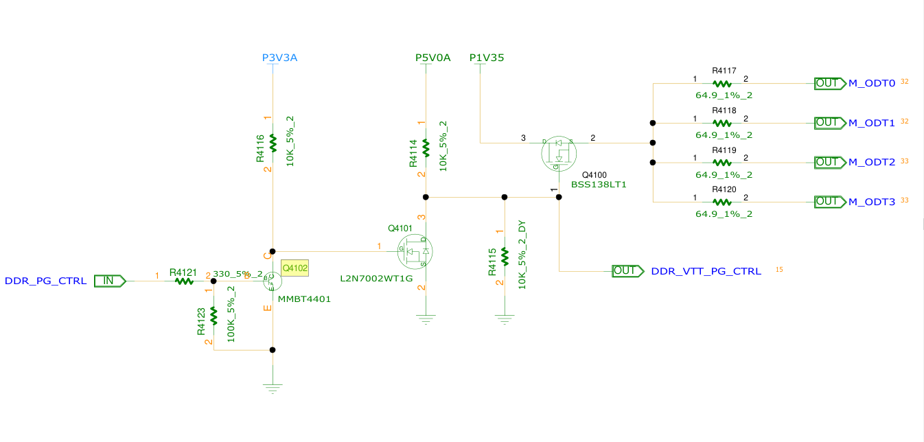

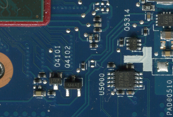

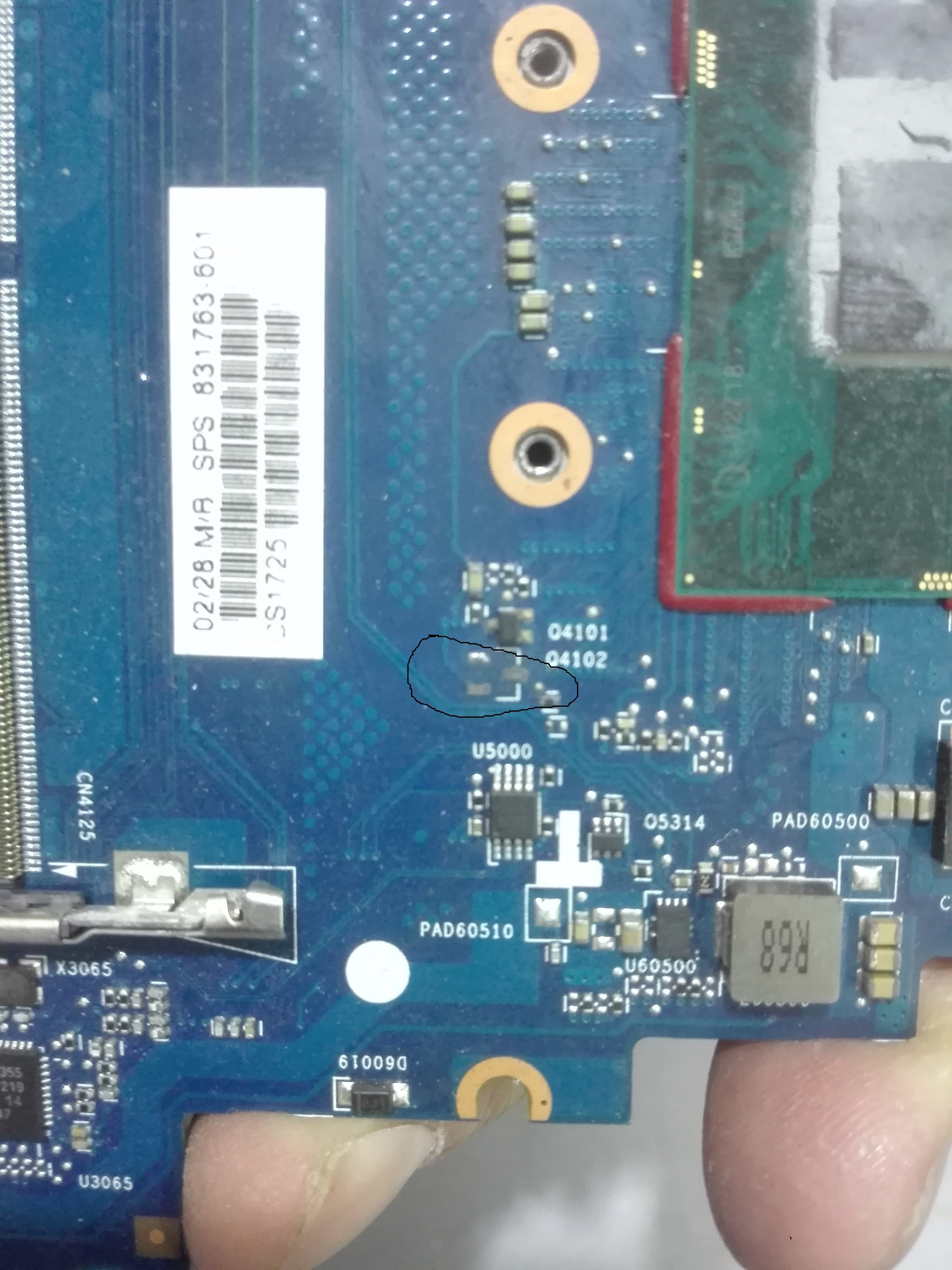

          NEED TO VERIFY THE COMPONENT number
          • Bonzas
            • 472
            • Indonesia
            On another board Q4102 using MMBT4401, you can find on 820 g2 schematic that i think some part identical
