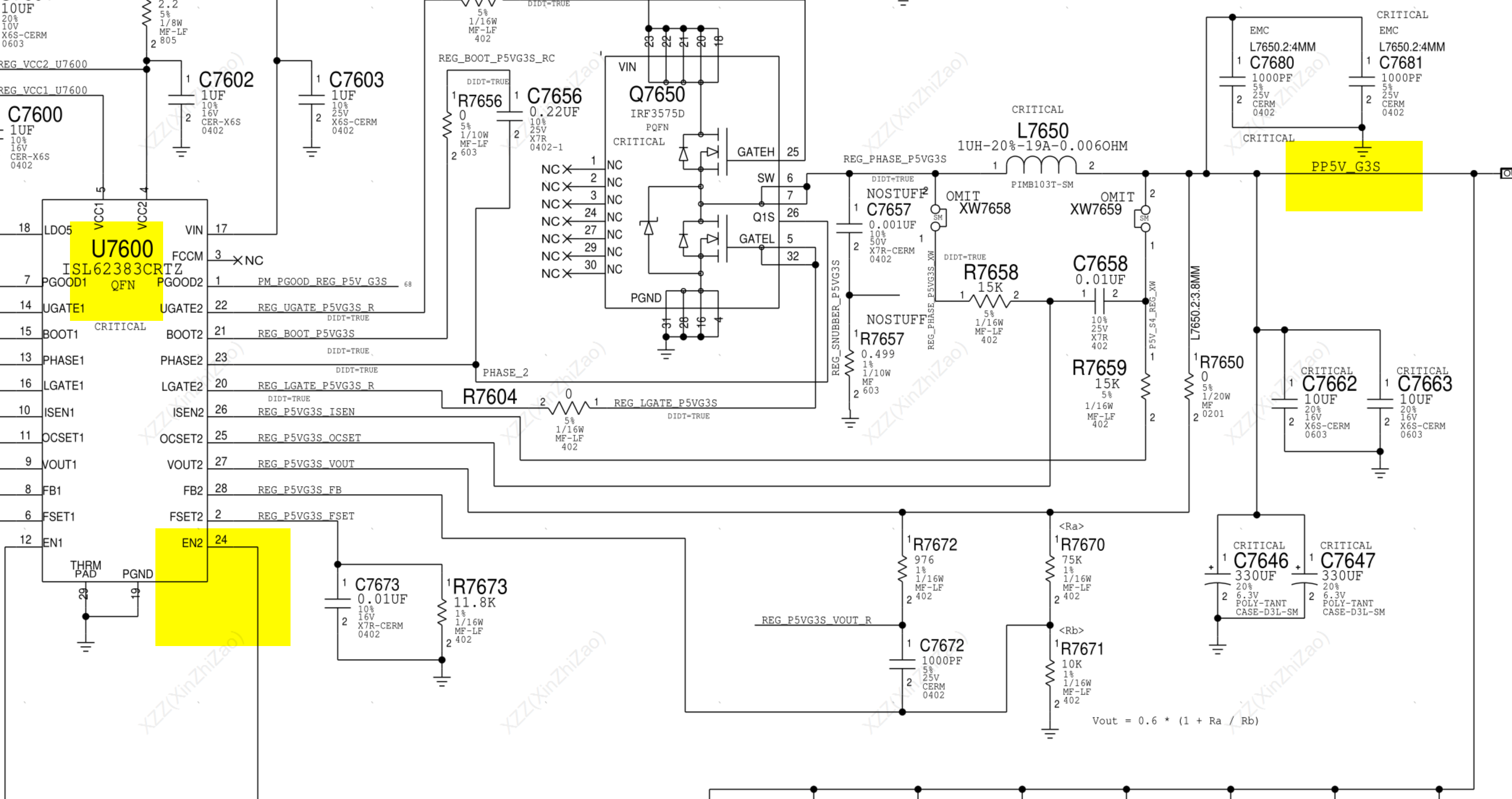

      Measure the voltage to ground of U7600 (PM_P5VG3S_EN), pin 24.
      If this pin is not a logic '1' (high) then remove all power -> meter in resistance mode. Measure the resistance to ground of pin # 24.
      Also measure the resistance to ground of L7650 (either side is ok) = PP5V_G3S. This is @ 20k ohms?
      The 1v @ 44 ohms is likely ok since it is a low voltage rail. By design, low voltage rails are low in resistance. (As stated by Locutus / Star Trek - 'resistance is futile').

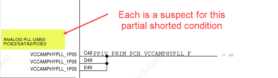

                  Ok, after some strong tea, here is my 2 bits (half a nibble) review on this case:
                  1) you are the 2nd poster with exactly the same fault so this is a common issue.
                  2) the PP1V_PRIM has a rather low resistance to ground so suspecting an indirect or partial short on this line but not a direct one which would be < 10 ohms. This places us in a pickle as we cannot really inject voltage and enough current to cause the shorted component to be identified. Prefer a harder short than 44 ohms to ground.
                  3) in reviewing the netnames, PP1V_PRIM is used to power the analog components of a number of required functions including: USB3 / PCIE2 / SATA2 / PCIE3.
                  Each of these are now suspects for the partial short condition that has caused this power rail of 6A to turn OFF.
                  Click image for larger version  Name:	PP1V_PRIM_consumers.png Views:	0 Size:	35.3 KB ID:	3273247

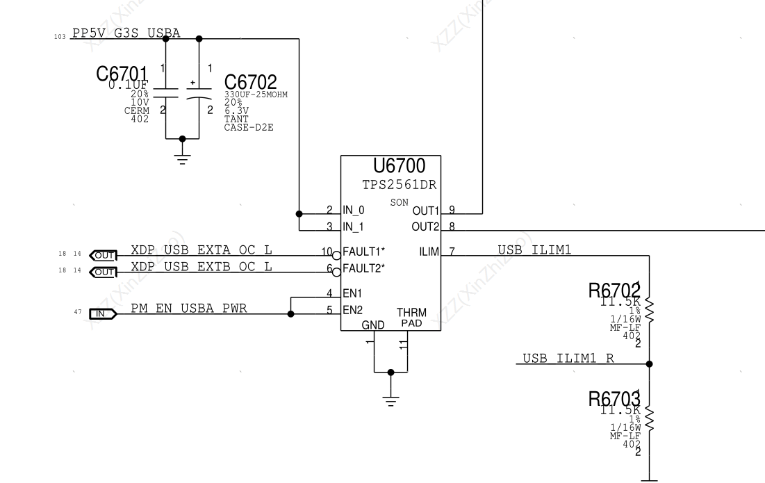

                  4) Moreso, in the first post, you have observed that you are also missing: PP5V_G3S.
                  In tracing who is a consumer of this power rail? It is the USB interface.
                  Copied below is 1 port on the mac mini - there are others as well.
                  Suspects are:
                  PP5V_G3S_USBA
                  PP5V_G3S_USBC
                  PP3V3_G3S_WLANBT
                  Click image for larger version  Name:	U6700_USB.png Views:	0 Size:	83.3 KB ID:	3273250
                  5) Based on experience, the USB port load switches fail often. Given that a burning smell was observed, do inspect the board for burnt out components and especially the USB A / USB C regions of the board. The USB load switches are supposed to be like a multiple use electronic fuse but they often just fail by burning out. If true, they will tank the interfaces on the USB which will include the ANALOG USB PHY and power rail components. It will be best for you to review the board or at least clear and zoomed up pics of these regions of interest. My bet at this time is that the USB interface has raised this fault.
                  Do ask the owner if they were making use of the USB A interface. USB C interface?

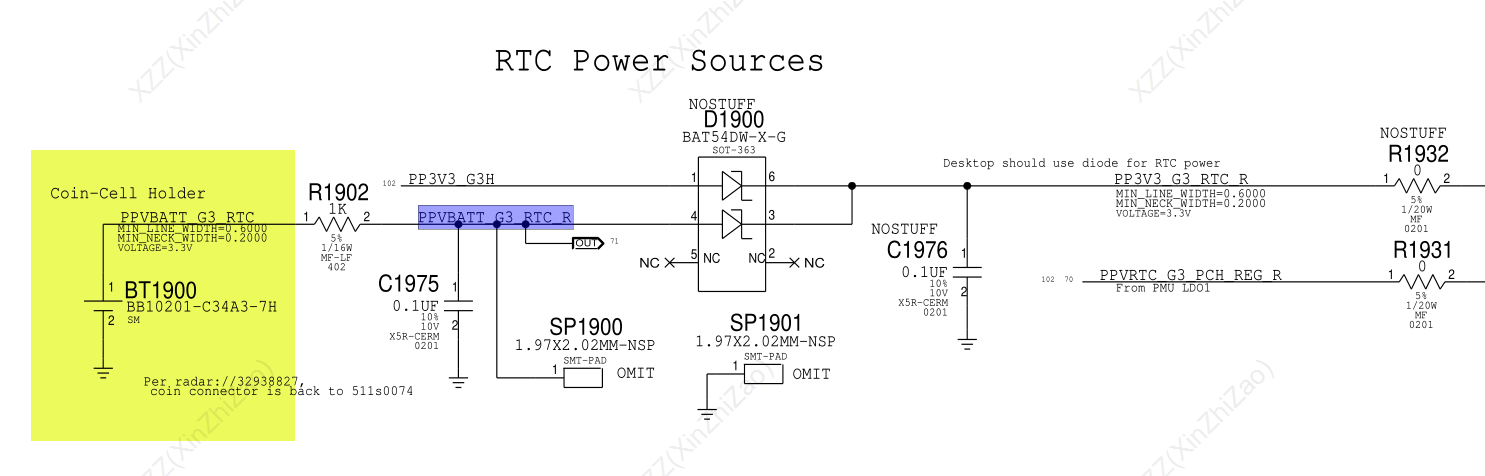

                          Do review the voltage to ground of:
                          I2C_PWR_SCL
                          I2C_PWR_SDA
                          PPVBATT_G3_RTC_R
                          Post the measurements.

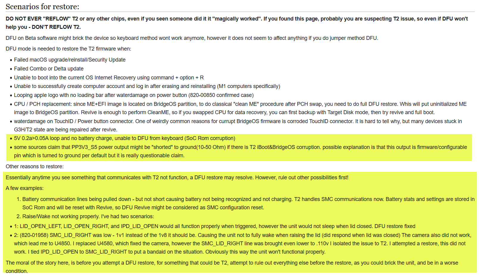

                          If the above are ok - then for both cases, attempt DFU with Sonoma. Can these boxes enter DFU ok?
                          See the DFU link and the positive feedback here:
                          https://www.badcaps.net/forum/troubl...-liquid-damage
                          * use the above thread to gain the feedback of a very similar fault
                          * use the following webpage to review the need for a DFU:
                          DFU Mode Restore (Macs) - LogiWiki
                          Click image for larger version  Name:	DFU_cases.png Views:	0 Size:	253.2 KB ID:	3274433

                            I finally have the mac mini !
                            I2C_PWR_SCL 1.8V
                            I2C_PWR_SDA 1.8V
                            PPVBATT_G3_RTC_R​ 2.92V

                              Just plugged mac mini on my hackintosh and it is in DFU mode.
                              Try revive without success (error 9)
                              • sauce
                                • Sep 2013
                                • 146
                                • France
                                Unbelievable DFU revive with a real mac (I bought to repair it) worked !
                                The mac mini is alive.
                                So DFU and hackintosh even if device appears in DFU mode the revive does not work.
