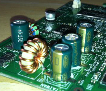

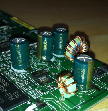

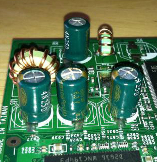

    I was so inspired by the help I received here that I decided to go through my sons comp - all the MB caps looked fine, however, this video card looks like it's getting ready to take a crap on me. Any advice on good replacements is appreciated.

    Your pictures do not show enough of the required information to suggest good replacements. Please list all the printing on the capacitors pictured.

      Written down the side there is: LMB105*C(M) That asterisk is actually a degree symbol on the cap. Then there is: 4N25D
      820 uf
      6.3 v
      There is some sort of logo in an oval but even with my specs on I cannot make out what it says. Seems to start with a capital L.
      Hope this helps. Thanks again.

        Brand is Lelon.I recognized it from their hand writing logo.

          https://www.badcaps.net/store/produc...roducts_id=163
          Use those
