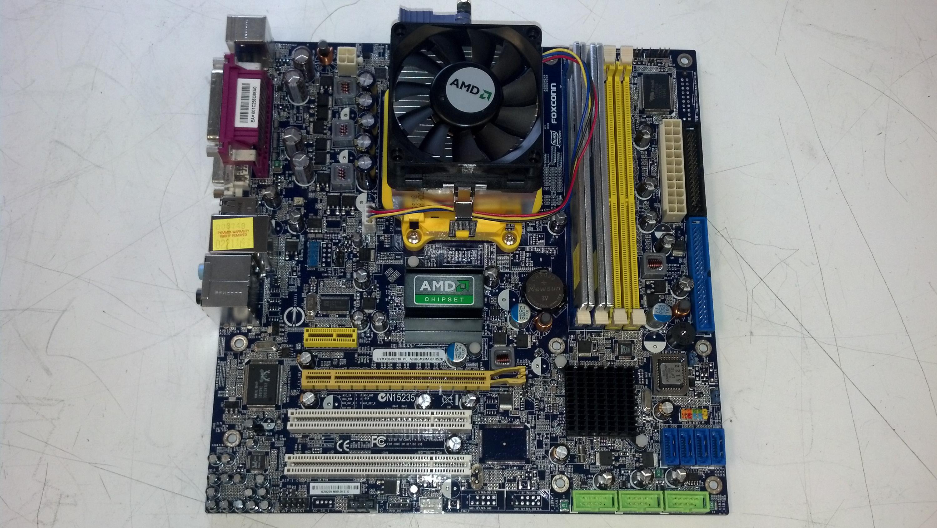

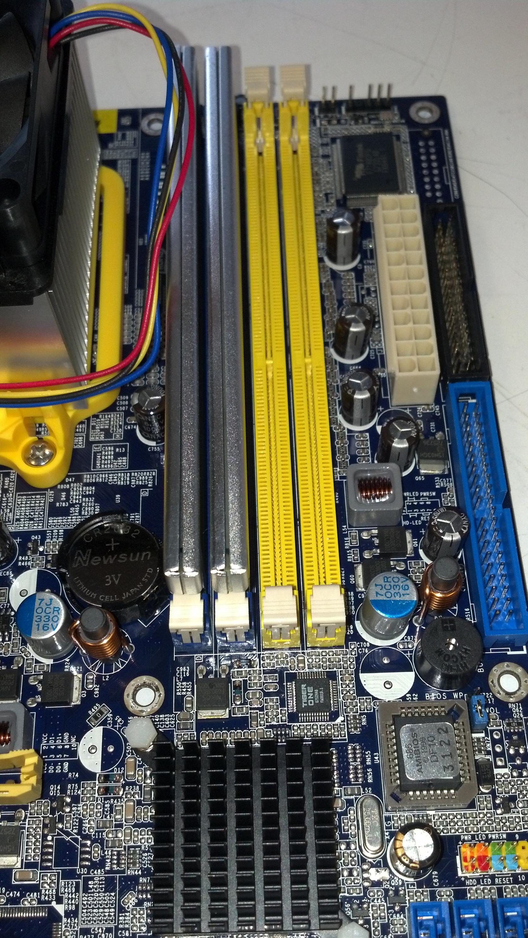

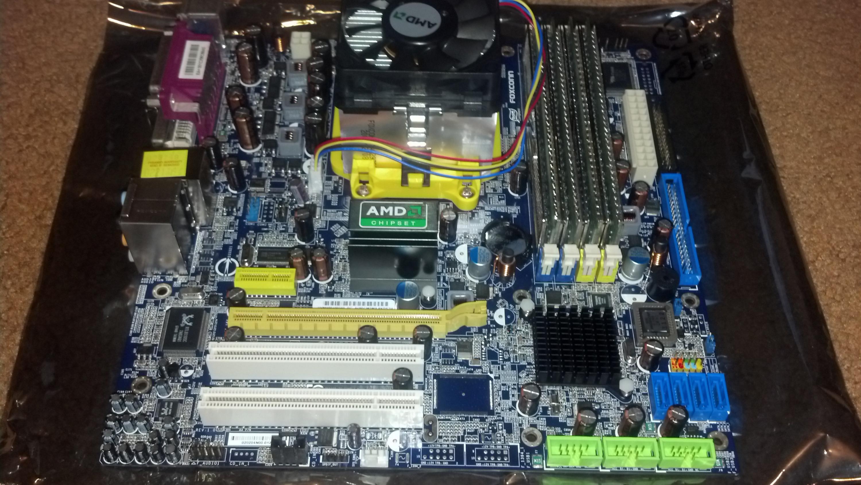

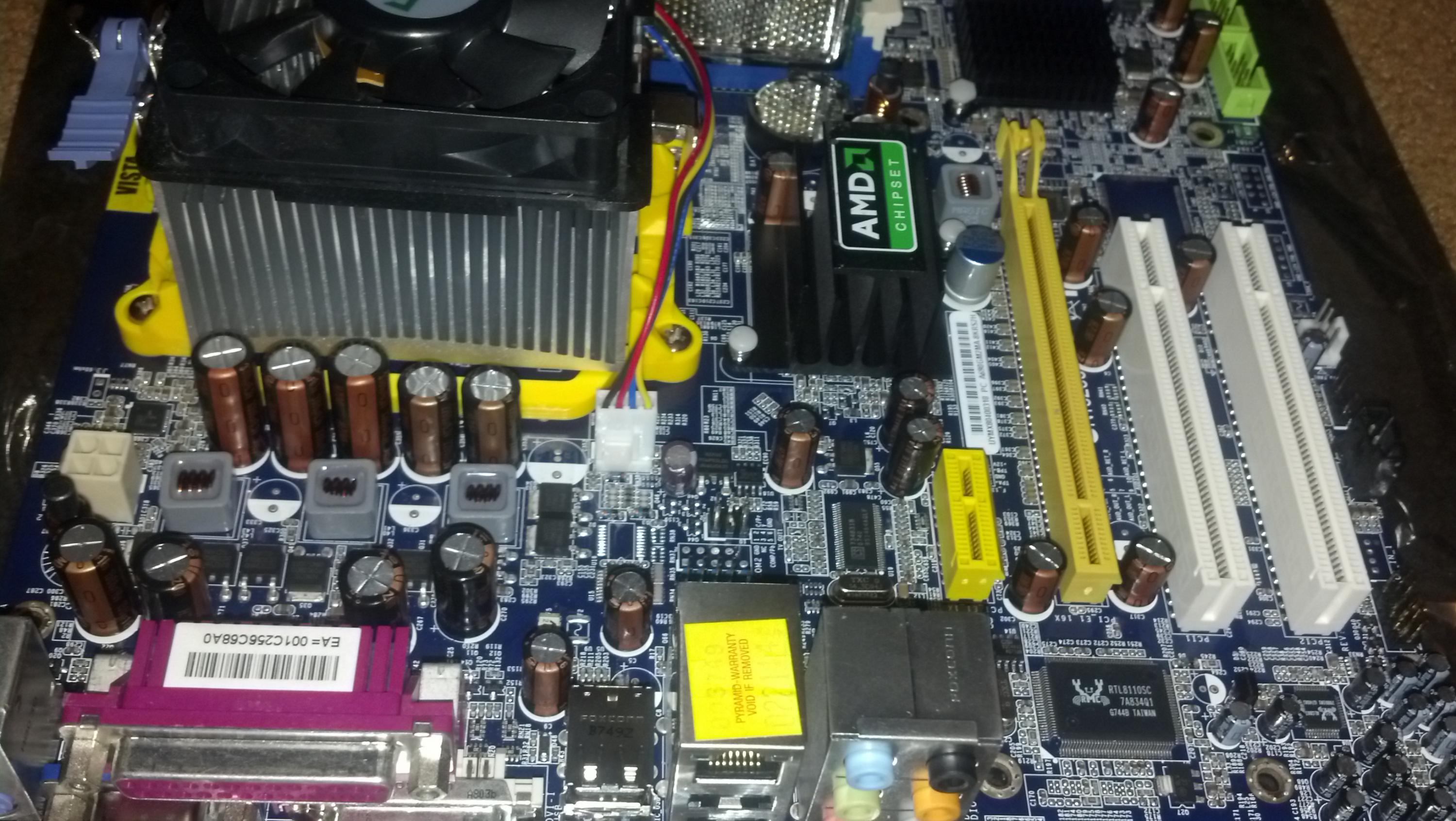

    Here I've got this Foxconn board that I obtained for free and I want to recap it. The caps on the VRM are KZG and OST RLX (Going to replace the KZG with nichicon HZ, and the OSTs with Sanyo SEP polymers) None are bulged surprisingly, probably because it was using a piece of crap low power 45W Sempron LE-1200. Plan on putting an Athlon 64 x2 in there. The rest of the caps are SAM YOUNG NXC and Evercon LE. The Evercons are definitely getting replaced.
    My question is, are Sam Young caps reliable enough or should they replaced? They're all 1000uF 6.3V. If they're fairly reliable, I will leave them, if not I'm hoping that 820uF 6.3V nichicon HN caps would be adequate enough as a replacement. Anyone had experience with these Sam Young caps on motherboards?

    I had two 1000/16 Samyoung NXC bulgers on TV Digital board... I would replace them.

      I have no experience with Samyoung caps but I would replace them if they are in stressed circuits and/or powering a high-speed IC or BUS like CPU, RAM, NB, SB, PCIe or AGP. However that board seems to be made between 2006-2007 (judging by the AM2 socket), so unless you know for sure it hasn't been abused with crappy P/S or poor cooling you better replace those caps IMHO.

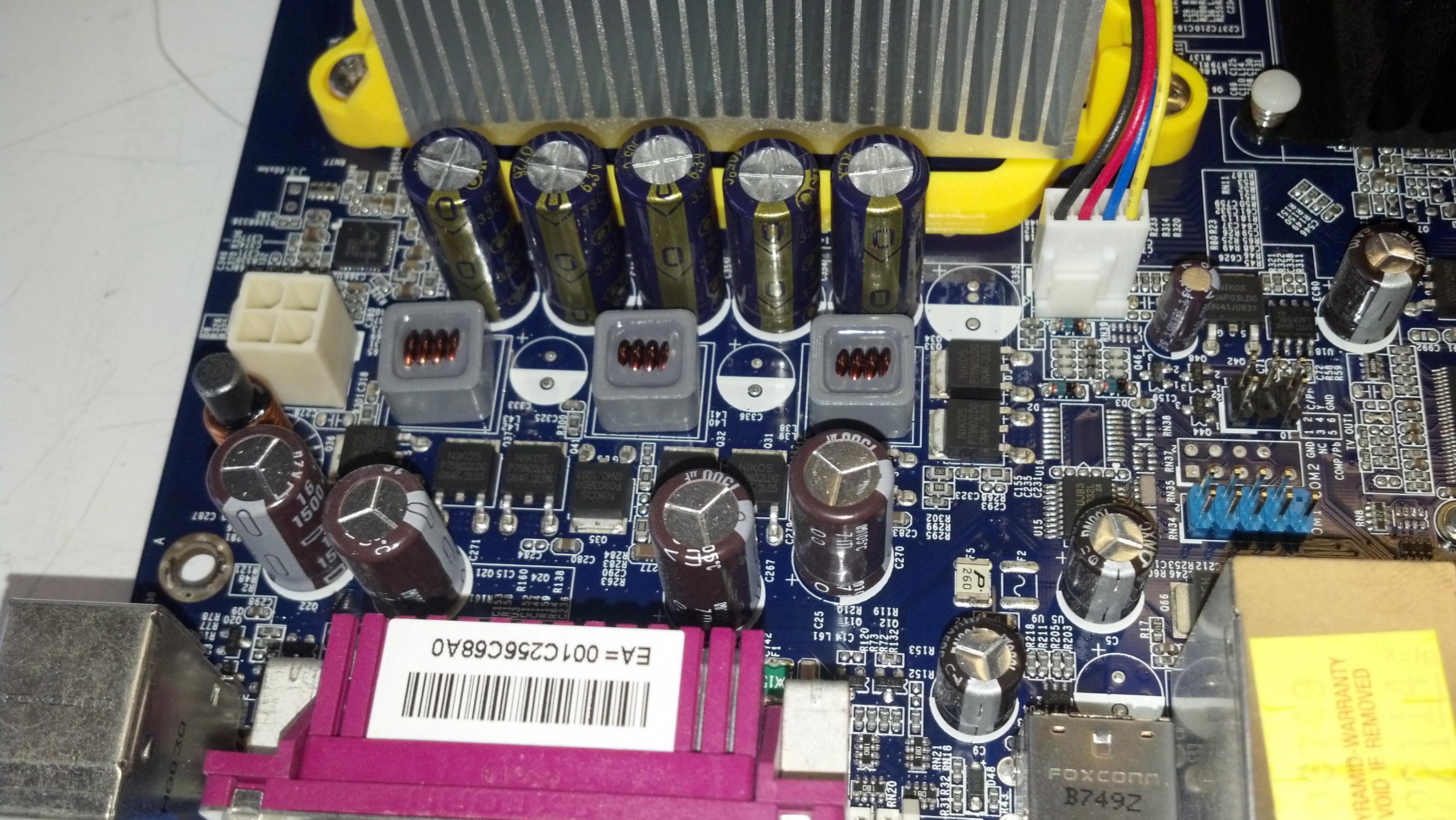

        Samyoung caps... I would replace them if they are in stressed circuits and/or powering a high-speed IC or BUS like CPU, RAM, NB, SB, PCIe or AGP.
        Agree.
        If they are general filters for 3.3V, 5V, and 12V rails or 5VSB and USB +5V, you can leave them. May also be okay on low-power linear regulators (any 1117 parts). Definitely replace if they are on a buck regulator.
        For example, it looks like MOSFETs Q60 and Q61 by the bottom of the rightmost RAM slot form a buck regulator. The OCR 330uF 16V cap is probably the input filter for that buck regulator, and above the square coil are the filter caps for the output. If I'm not mistaken, those are Sam Young - and if they really are, I'd say replace them. Maybe not all 4 of them are in parallel, though, so you'd have to check. It's possible that some of them are on the RAM Vtt, which is a very low stress rail.

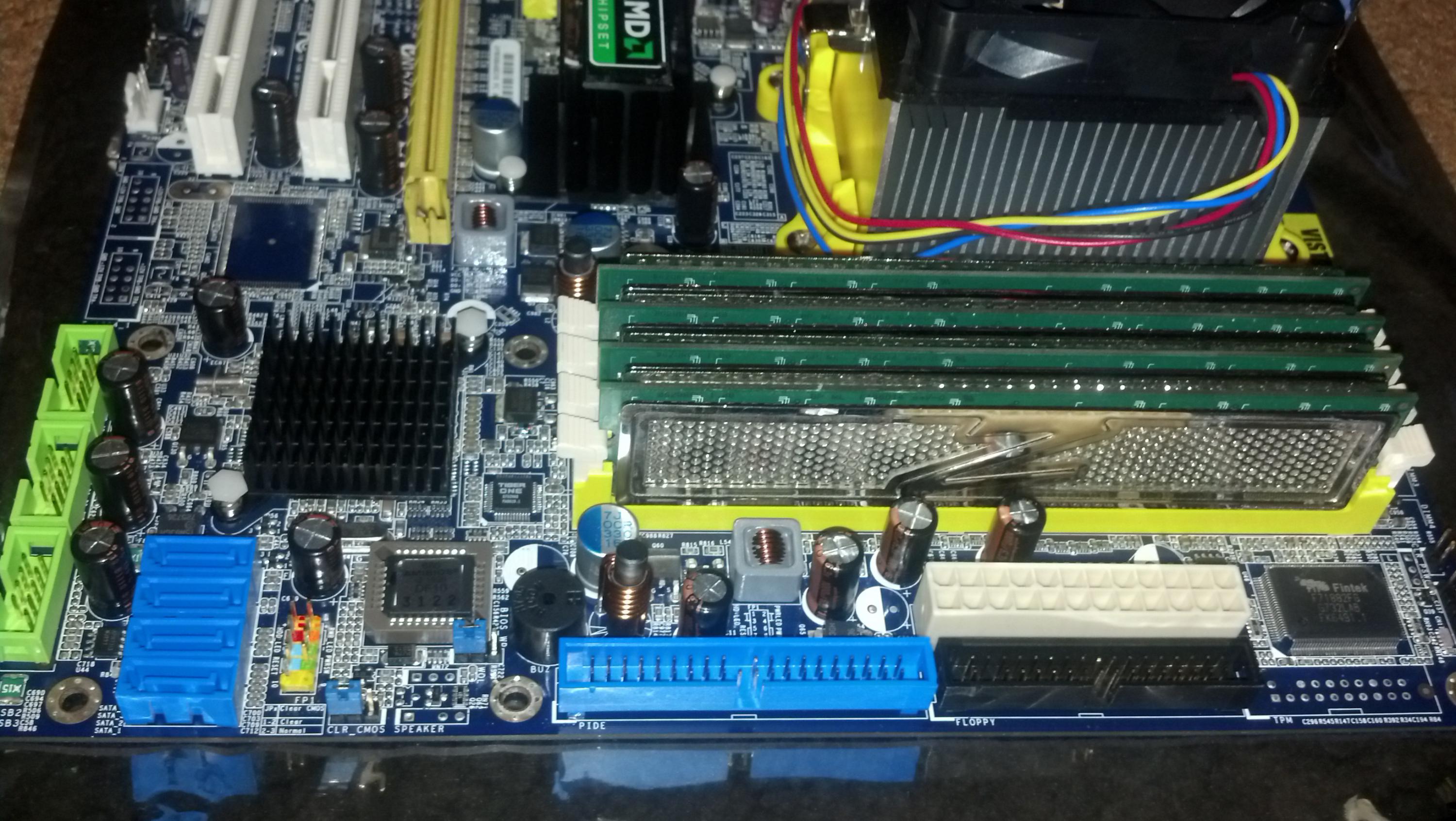

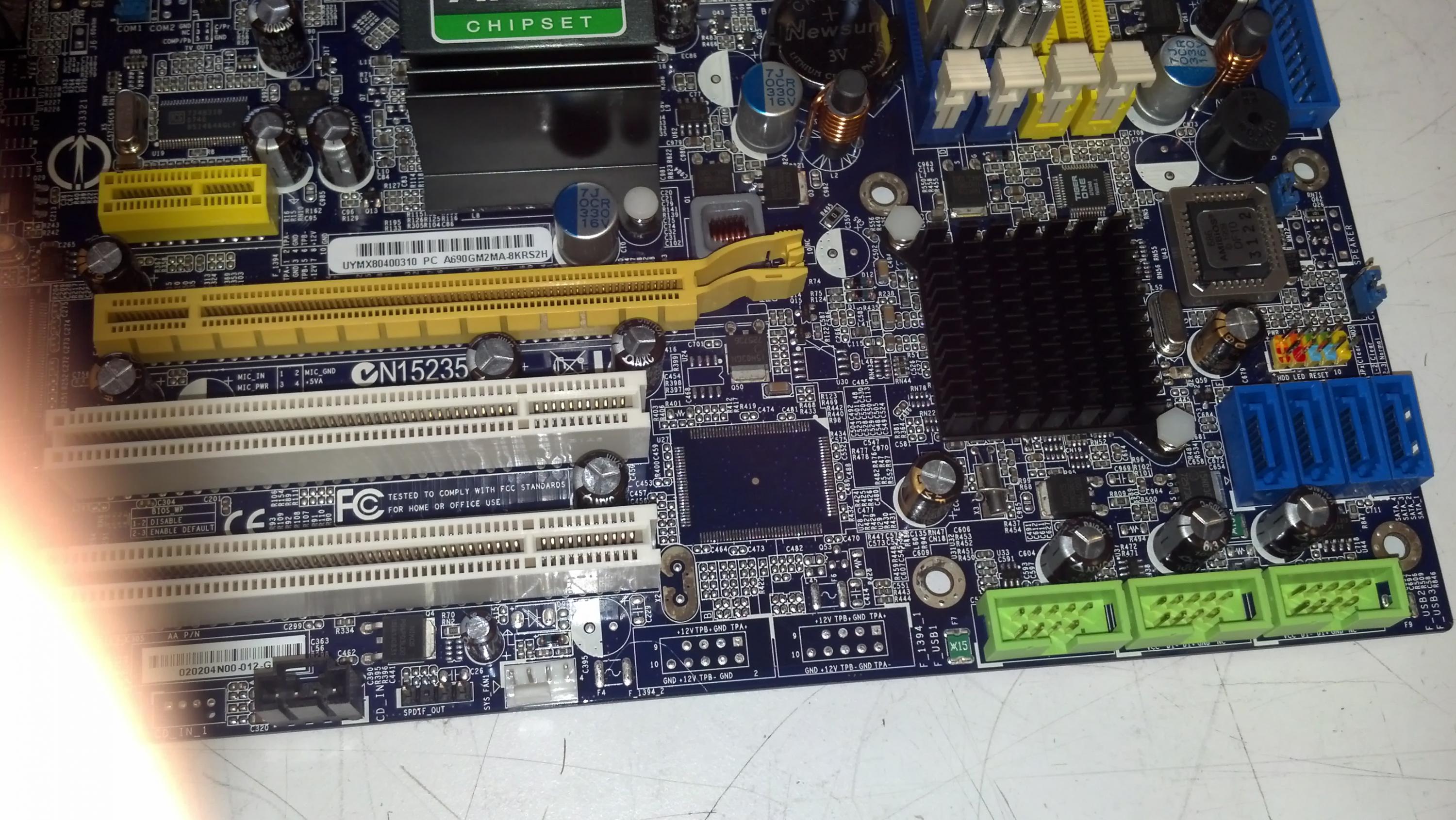

          I'm OCD about caps, so I replaced all of the Sam Young's. And...Good thing! They all read over 1250uF! Some even as high as 1375uF. So I'm guessing they had a lot of internal leakage. I also noticed that it was extremely easy to pull the legs out of the Sam Young caps. Abnormally easy.
          The four 470uF 16V Evercons on the other hand...all read between 463-475uF. Well played Evercon
          It looks so much better now! Purely nichicon HZ, except since I was paranoid I replaced the 100uF 16V Teapo SEK that filters the CPU fan power with a 100uF 25V Chemi-Con KY cap. Mainly because it was sitting just a mm away from a voltage regulator.

            Nice job. Excellent example of a proper re-cap (Assuming your soldering on the bottom of the board is good). Absolutely always replace Teapo SEK. I would consider them an unreliable series, bearing in mind that the higher diameter versions may be somewhat reliable. The Evercon caps may be reading in spec, but you don't know their ESR.

              Thanks for the kind words mb. My soldering job I would say was slightly above average. I was a little picky about some joints but didn't want to spend too much time on this board. I prefer Intel, but this is a nice board now that it's recapped. It uses the 690G chipset. The ESR of the Evercon caps were 0.18Ω, 0.18Ω, 0.20Ω, 0.22Ω Either way they were going to get replaced. The two healthier ones were the two next to the PCI-E slots, which never got used which is probably why. I've seen Evercon/GSC bulge just from sitting, so apparently just having voltage applied kept them "healthy"

                Interesting. So the Evercons were indeed in spec. Do you remember the ESR of the Samyoung caps that were reading above their rating?

                  Yeah, the Sam Young caps were between 0.03Ω-0.06Ω with most being 0.04Ω
