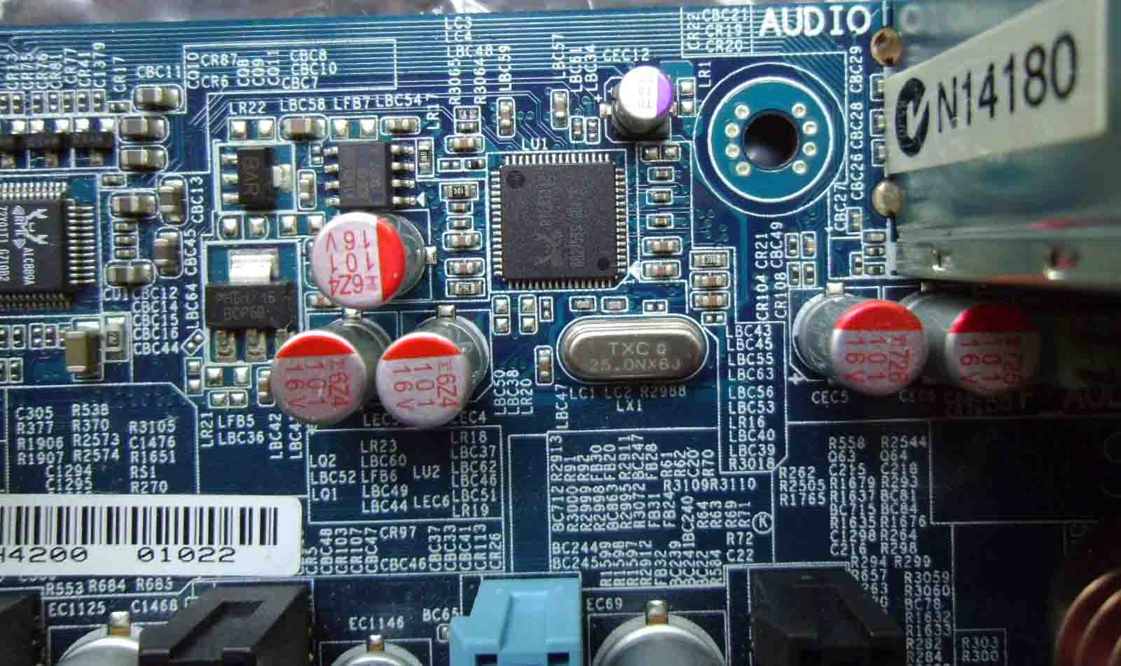

    I can't work out what's happened to on-board Ethernet with this GA-P35-DS4 board
    Doesn't even show CMOS setup option "Onboard H/W LAN" Enabled/Disabled
    So I surmise its Realtek 8111B SMT chip isn't working, even though it appears undamaged, as pictured
    Any suggestions, apart from PCI card ?

      Was it working before, then just disappeared? Or did you get it like this?

        I got it like this
        Board does boot OK, and other on-board stuff, like Firewire, seems to work
        Although on-board sound has a bit of crackle

            Now as far as the OP's topic... was the BIOS ever flashed on this board?

              ... when I got it, was using F11 - seller said "Refused to boot on F14 (BIOS). Downgraded to F11 and works but network card is not detected"
              Seeing fools rush in where angels fear to tread, I re-flashed it to latest F14 and got a boot loop
              Downgraded to F13 - boot loop
              Downgraded to F12 - after some trying, got stability - so I treated it to a new CMOS battery, and left it at that
              BTW, I quoted seller's exact words - however a generic Realtek 8169 PCI card works fine, so I presume he meant on-board network

                I may have found the problem
                LC3 shown in original pic, near the edge of the board, appears to be a component broken off, not just empty solder pads
                Now to find a replacement

                  I'll never know if missing LC3 was the problem - tore off a pad while trying to solder a replacement into place
                  At least the board still works
