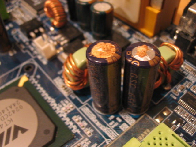

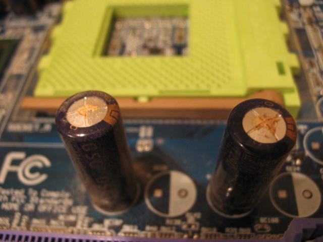

      • Inspected MB closely. HELPED! Found all four 3300uF GSC crapacitors were bulging and leaking. No other caps showed sign of damage.

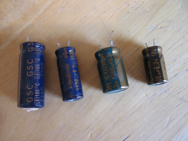

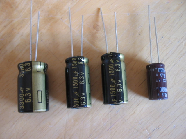

        OK, I can't justify doing a reinstall of Windows until I get the hardware fixed. And if I'm going to pull this system apart to replace the caps, I might as well do some other stuff while I'm at it.
        Decided on Digi-Key, because it's one stop shopping. Mouser, Newark, and Arrow didn't have all the components I needed in stock. From Digi-Key's capacitor offerings, I chose to use the Panasonic FM series for 3300uF, 1500uF, and 1200uF. The FM series specs are excellent, and they are on the GOOD LIST. For the 1000uF, I chose the Chemi-con KY series because they are the only 8mm 1000uF caps Digi-Key offered that are on the GOOD LIST. I had to have 8mm because the 1000uF caps go in some tight spots.
        Digi-Key Shopping List:
        • 10 3300uF Panasonic FM series
        • 10 1500uF Panasonic FM series
        • 10 1200uF Panasonic FM series
        • 25 United Chemi-con KY series
        • Desolder braid
        • No-clean solder
        • No-clean flux

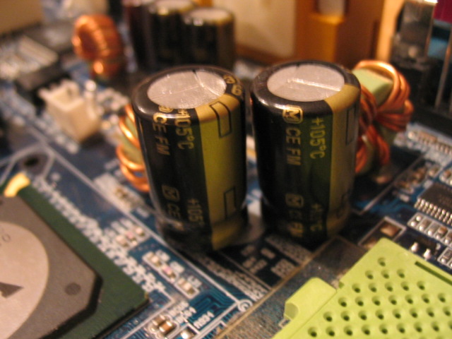

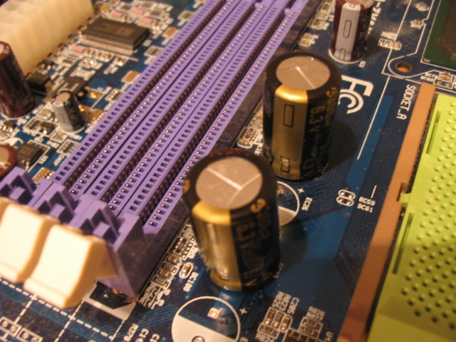

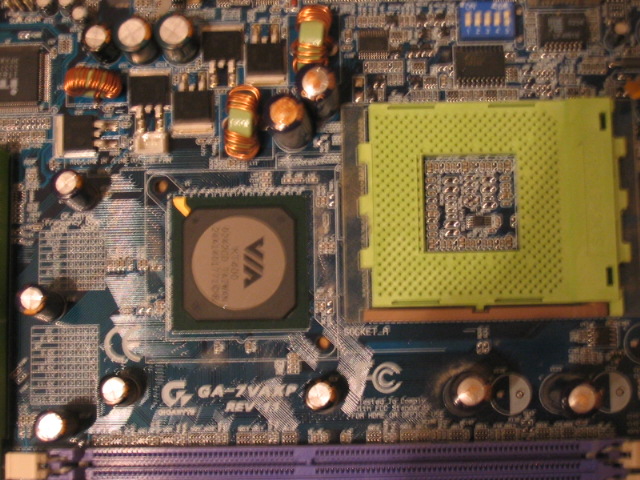

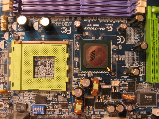

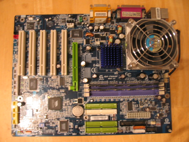

          Re: Gigabyte GA-7VAXP Recap
          Man, Digi-Key and UPS rock. Had order in less than 48 hours using UPS 3-day shipping!
          Below are some pics of the board before and after recapping. I started the soldering iron about 8pm. I used a Radio Shack 40w left over from college, although I had to give the tip some love before I could use it. The 3300uF Panasonic caps were 12.5mm whereas the original GSC's were 10mm. I had to do some bending on the leads to get them to fit the space correctly, but it turned out pretty good.
          I heated the cap leads with a "wet" tip from the back side of board and gently wiggled old caps out. No real problems doing this. Trimmed the leads of new caps to something more reasonable before I installed them. Once I got new caps in, using the heat-and-rock procedure, I trimmed excess from leads leaving about 1.5-2.0mm protruding from board. I fluxed the solder area, then touch "wet" solder tip to the tip of the cap lead. The solder flowed down over lead and onto pad. Any excess solder on tip of cap lead was trimmed off. Once done, I viewed backside of board (from the side/profile) to make sure that none of the new cap leads extended farther from board than any other component leads. Cap lead touching chassis = BAD!
          To finish, I gave each cap a wiggle and closely examined the solder joints for movement. Next I closely examined the areas around the new solder joint to ensure that no solder had gotten onto adjacent areas - good thing I did this - I found 2 spots that I had to use the desolder braid to remove some solder. Next I examined the adjacent areas to ensure that I had not removed solder from any other part of the board - by the way, this is something you should REALLY be careful of when you do your solder job. Though I used no-clean solder and flux, I went ahead and used some board cleaner and lightly scrubbed each of the new solder joints. Finally, I put machine back together.
          1:30am ... Houston, we have POST!
          Next, will post more on the initial performance of system after recap.
