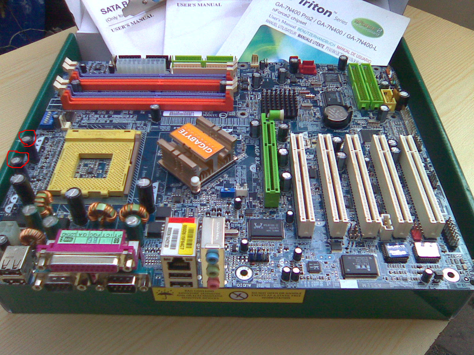

    Please help identify these two caps
    I was hoping that someone who has the same motherboard could tell me what the values of the two caps circled in red in the pic are. The board I have is missing these two.
    The motherboard is a Gigabyte GA-7n400 pro2
    Thanks.

    If nobody gives you a better answer, based on the images I see on Google Images and the size of the capacitors in the pictures compared to the others, they're PROBABLY 1500-1800uF 6.3v - this is typical values for that time.
    The larger capacitors (in diameter) are probably 3300uF 6.3v or 16v capacitors.
    For testing purposes, it should be OK to use 1500uF 16v capacitors there, better safe than to find yourself with exploded capacitors.

      Re: Please help identify these two caps
      I was thinking the same thing. And after reading your post I just thought what the heck and soldered in two 1500uF 16v and It now works!
