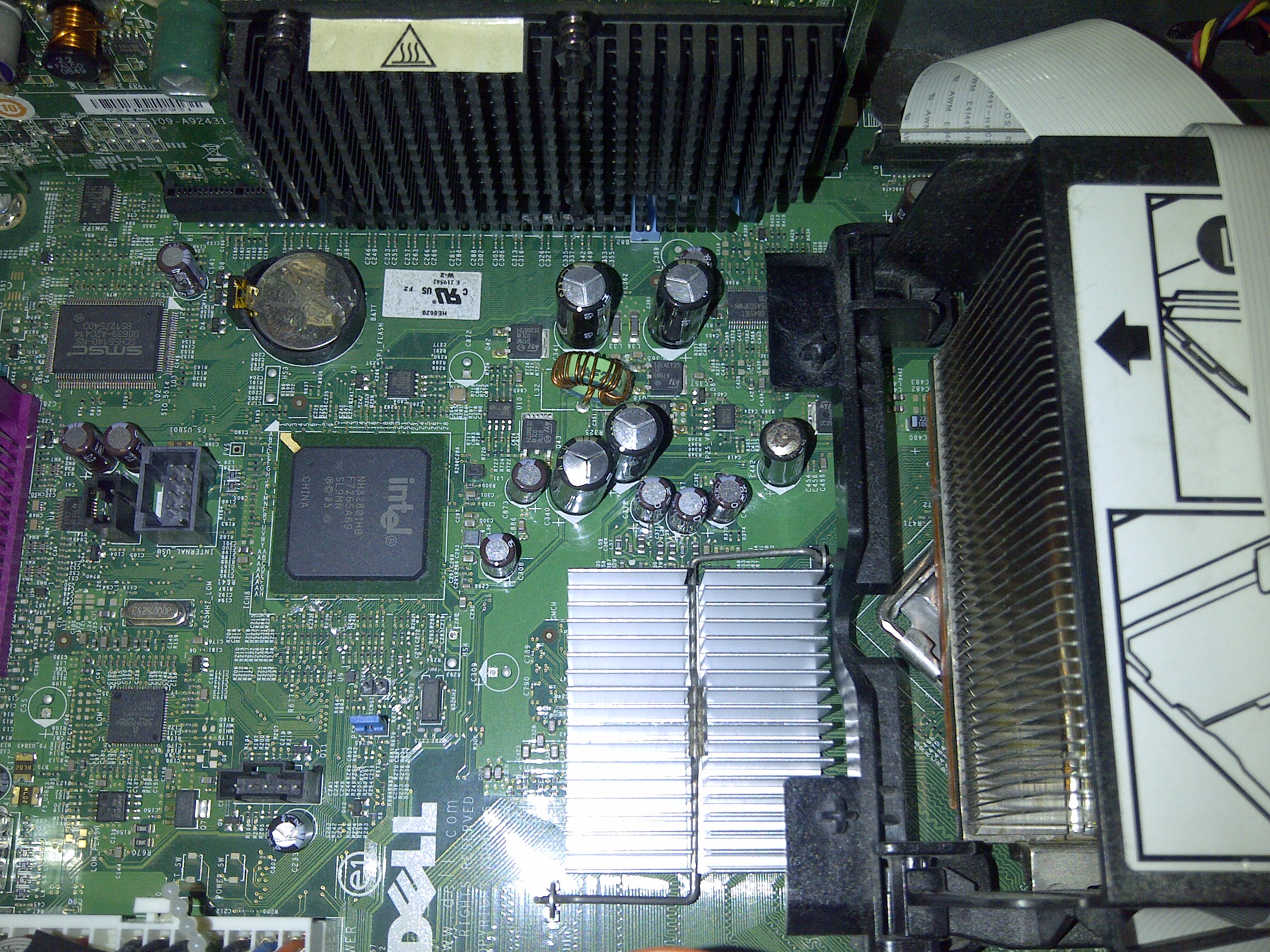

    I want to know if HP is doing any better than Dell in the last 5 years for getting 6 years out of a system without having cap guts splattered all over the inside of the PC? Maybe another major brand is doing well?
    I have been through the pain of swapping GX270 boards out, then the video cap popped, and finally other caps near the NIC popped on the 3rd go around. All the 270's and 280's have been purged from our company, but, the issue continues...

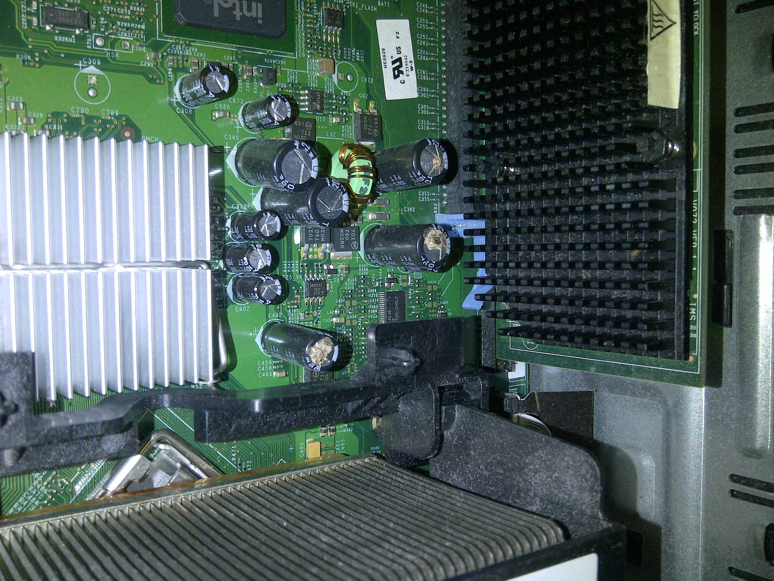

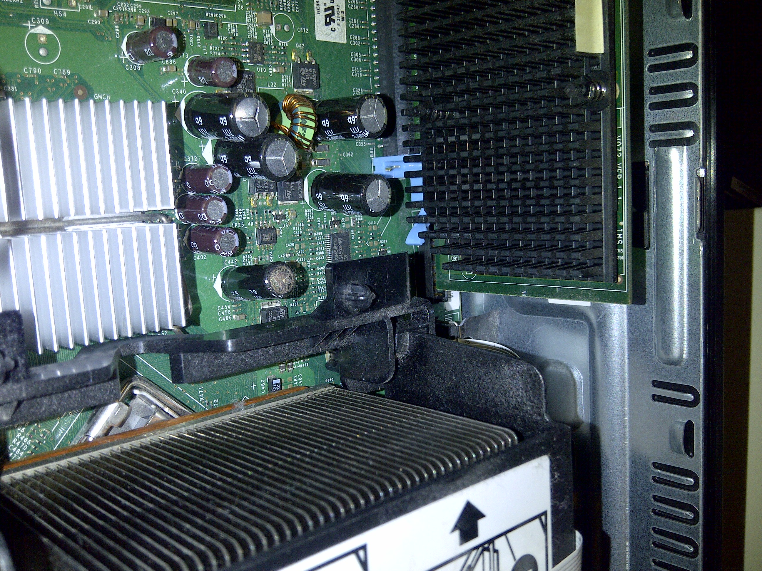

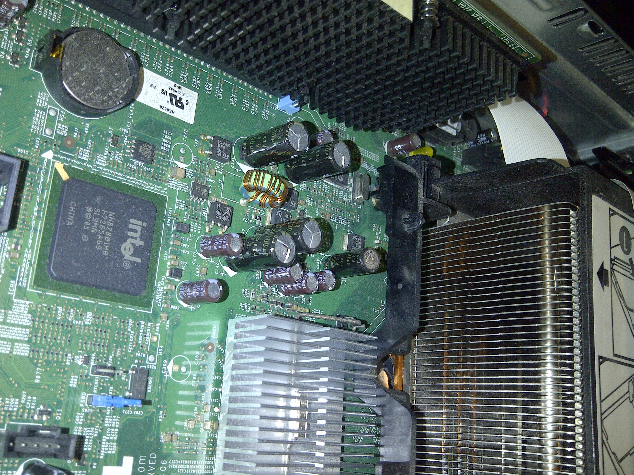

    The bad news is the Ultra Small Form factor "microwave oven" systems that replaced the 270's also failed with blown caps around 3 years. We quit going with that small case and still have popped cap issues with Optiplex 620, 745, 755, 760, 520, and Precision 490. The failure times are 3-6 years on these systems. I would like to see 6 years out of the systems without the 50% or greater failure rate the damn Dells give us. Even with a 5 year warranty I really can't get the 6th year out of the Dells. We are hitting an 80% failure rate on visual inspection on anything over 5 years old.
    Our systems are powered on 24/7 to get updates, however, most are not used very hard. Office, internet, etc.
    Pics of the 620-745-755 systems below that are 5 years old.

      They make cap kits for these models for a reason... So it isn't luck: it is the shoddy Dell cooling design and cap selection. Lets take hot air off the CPU to cool most of the MB...
      The CPU fan needs to exaust from the case (rather than intake like most systems are) or be completely separate airflow without heating up the rest of the PC case.

                The caps in this these Dell PCs are rubycons, which are normally very reliable. The problem is that they just run far too hot and cook them. The only way you're gonna stop it getting bad caps is if you polymod it.

                        Well, with the huge scad of failures Topcat found with select batches of Rubycon MBZs and with EIBM's Rubycon MCZs failing before the (well-cooled) KZGs and MBZs on those boards, I believe there are in fact bad batches of MCZ/MBZ out there. They might not be quite as bad as KZG but I do believe they will eventually fail, but some batches are probably worse than others (there was another thread about MBZs failing in the VRM circuit of an eMachine on here, I believe it was MSI-7207 version 1.0, or K8NGM2-L). The fact that all low impedance Rubycon capacitors are completely aqueous doesn't help - that sort of electrolyte wears out considerably with heat and added to that all three series of those capacitors are rated for a load life of 2,000 hours @ 105*C, so they do have rather finite life even without faulty electrolyte.

                          Looks like the plan of Minitower cases or one step below that, still larger cases sizes, is the best solution for longer life simply by running cooler. At this stage of the game it is has to be a heat related end of life event. High hours and high heat esp. with the additional heat from the video card. The minimal life components do not help.
