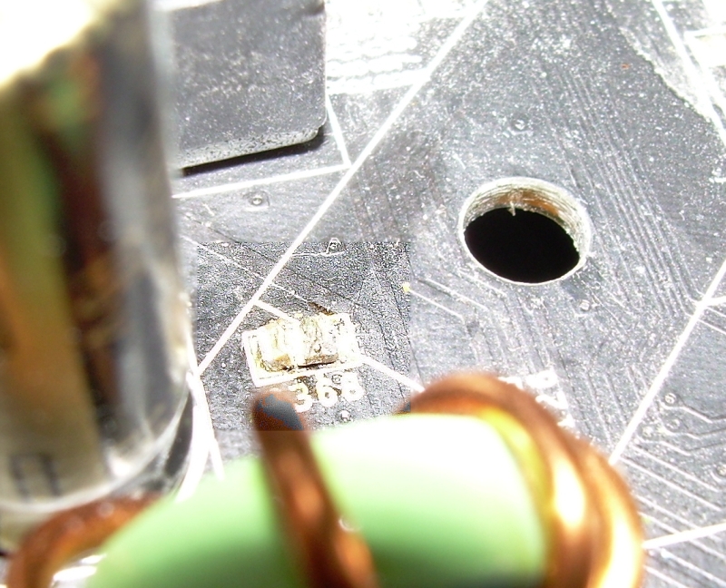

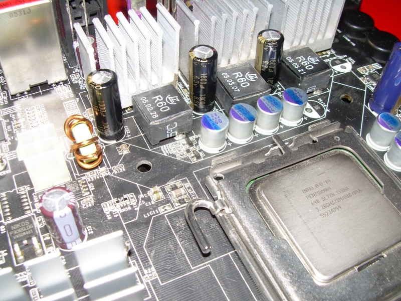

Msi MS-7028 915P Neo2 smd cap blown
  • Gabriel
    • Jan 2010
    • 620
    • Norway
    Replaced the Ost Rla with Sanyo Sepc and Kzg with Mbz.
    Still had a very high frequency noise, board works but almost impossible to be in the same room.
    I noticed that smd cap C368 had blown, any of you have a similar layout 915P neo2 board and can measure this cap ?
    If not, what should I replace it with ?
