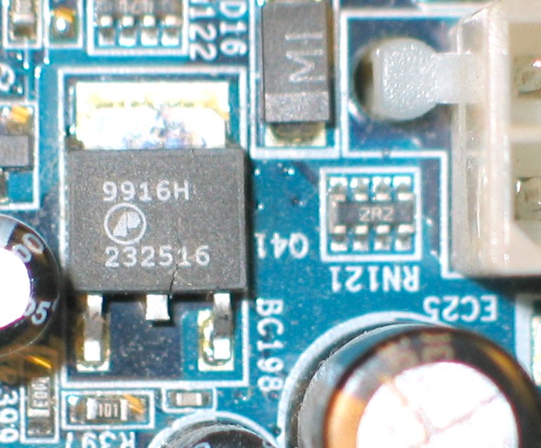

Ga-7va
  • Rainbow
    • Aug 2005
    • 1374
    Ga-7va
    Caps were not bad, Vdimm was missing. Closer look revealed cracked MOSFET. Replacing it fixed the board.
