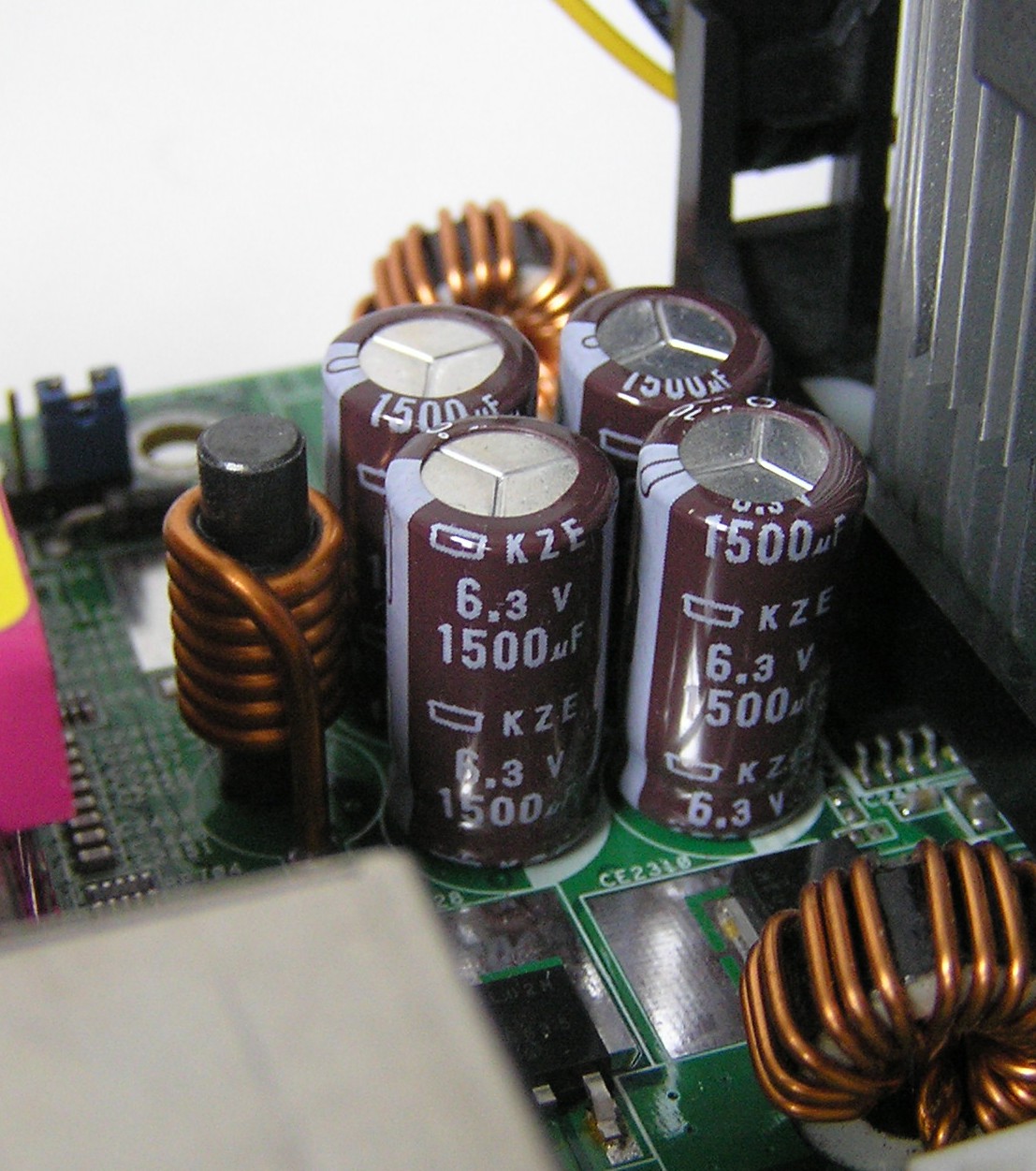

    I have recapped the 6.3v 3300uF KZG series already.
    The other capacitors are from OST.
    Is it an good idea to recap the 6.3v 1500uF KZE series?

    The KZE is a good series, it doesn't go bad often and I doubt it causes the problems.

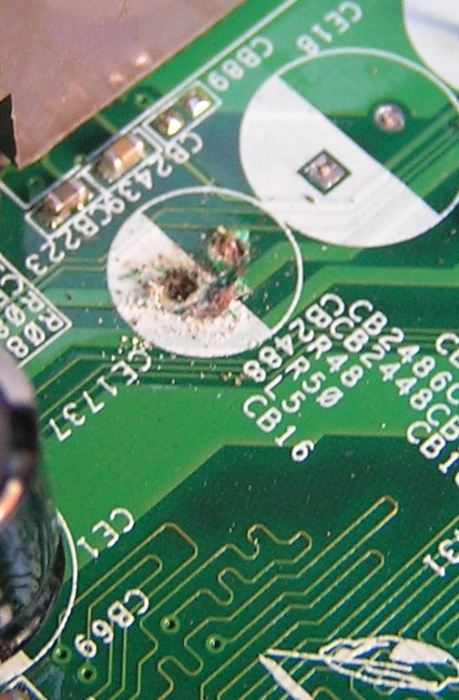

                There's several things that can burn, it can be just the silkscreen or the think transparent layer above. You might be able to fix it by soldering that capacitor a different way on the board. Usually capacitors with leads are through board so you could just solder it on top of the board and it would work.
                Could you post some clear pictures with the area you damaged? Maybe we can give you some tips to recover it

                  Yes, I melted a trace as you can see in the picture I added.
                  I don't have professional tools to fix it, I only have a cheap soldering iron, a desoldering pump and a hot air gun. I tried to fix it but it was even worser.
                  The motherboard goes to the trash after I removed some useful components like the BIOS (battery). Thanks for your help, maybe you can give my some tips how I should remove (and replace) a small capacitor next time

                    It can be saved... see that thick trace going left and under the text R08?
                    That's the + rail. Asrock and Asus boards have the silk screen on the board the other way around, the filled section of the circle points to the + sign of the capacitor.
                    You can carefully scratch away the clear layer of insulation and silk screen over the trace and simply solder a wire on that trace.
                    The other hole is the negative or ground... on the other side of the board it probably goes into a large ground plane like that copper filled surface at the top right.
                    You could follow the trace on the bottom of the board from the hole and see if it goes to one of those ground planes.
                    So you could try to squeeze a wire through that hole and at the bottom of the board and solder it to one of those ground planes the same way, scratching out the layer of insulation and silkscreen to get to the copper pad.

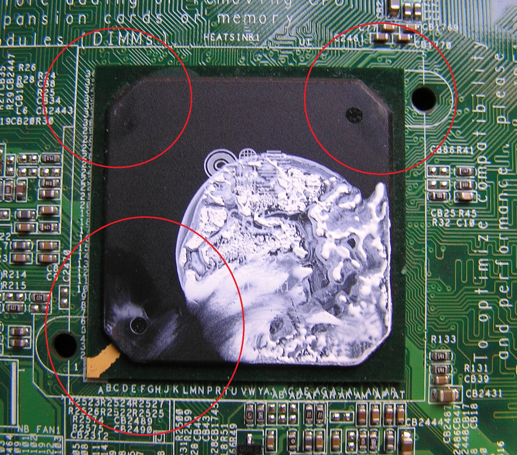

                      I dont think that I have the soldering skills for that. Im scared that if i solder a trace again, it will short another component. After removing the heatsink, I discovered something new: the northbridge chip was a little burned (I added a picture). I don't trust this motherboard anymore. It was already a bit unstable.

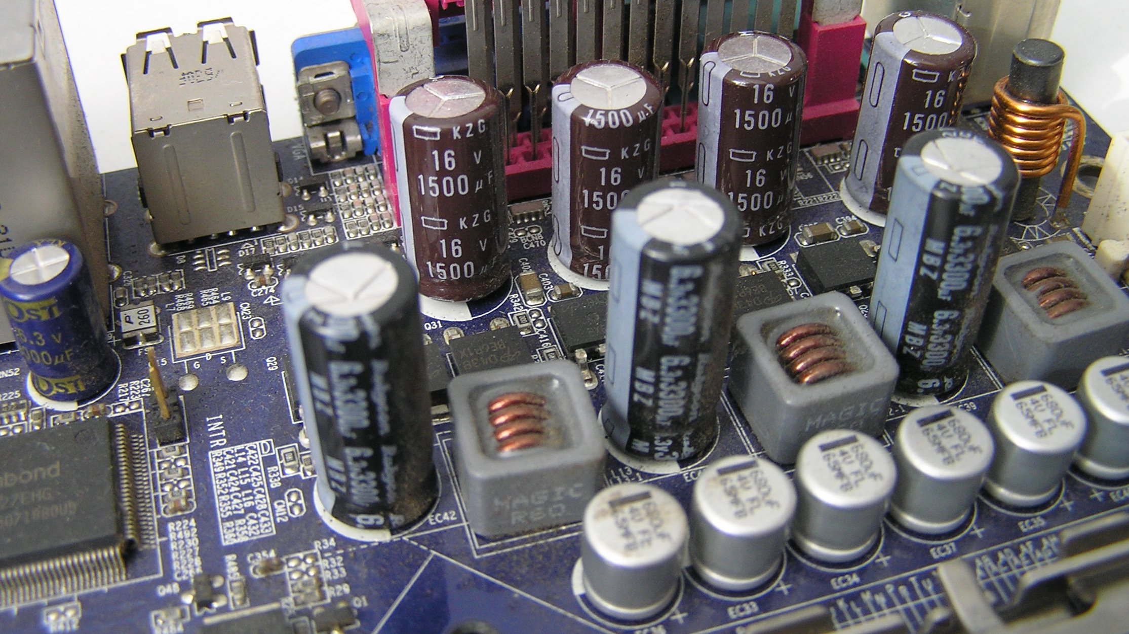

                      Another question: I have a foxconn P4M800 which doesn't want to boot. It will boot if I short the power connector, all the fans working but no display. Also an AGP or PCI card doesn't work. Is it an good idea to recap the KZG 1500uf?
