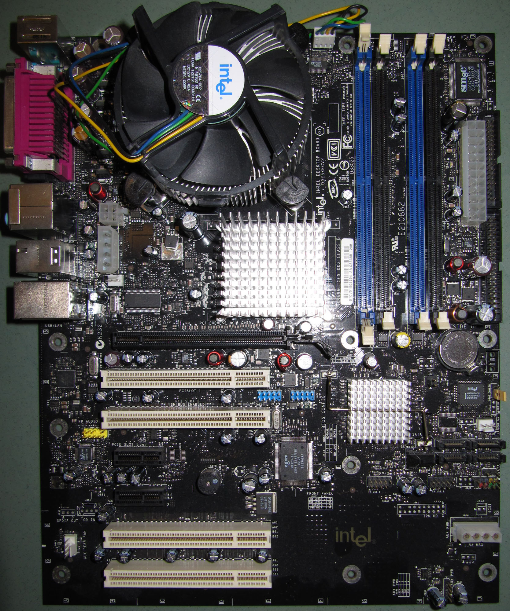

    That motherboard posts and beeps normally.

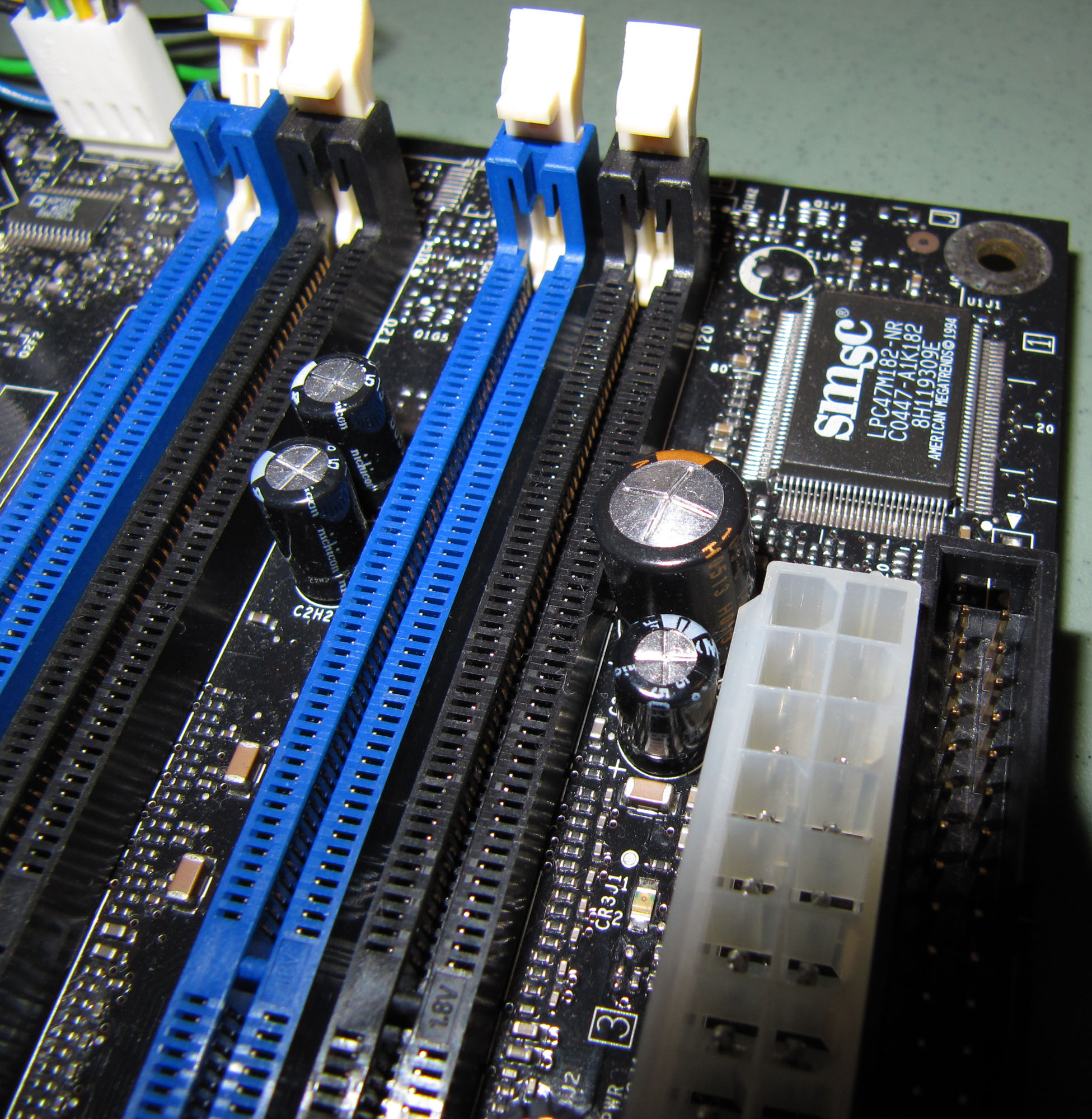

    The only obvious problem is a bulging Nichicon HN 1000uF 10V 10mmx12.5mm that is placed next to the 24pin ATX connector.
    The datecode on the capacitor is H0513. Correct me if I am wrong but doesn't that mean that the cap was made after Nichicon admitted the problem and corrected it?
    If the above is true then what killed the cap?

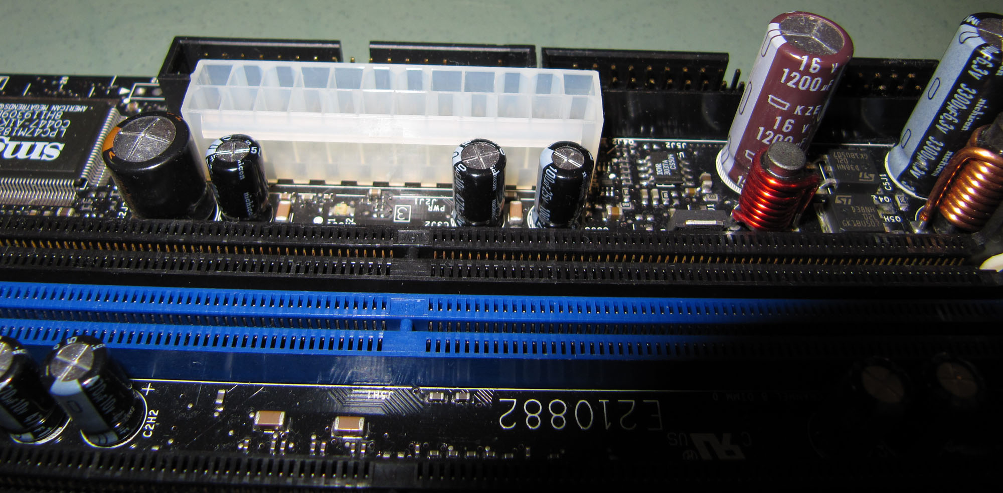

      I replaced the bad Nichicon HN 1000uF 10V 10mmx12.5mm with 1000uF 16V Panasonic FM 10mm x 20mm.
      There is another Nichicon HN 1000uF 10V not bulging. I would replace that too with Panasonic FM, but the extra length of the Panny would block the PCI-E graphics card...
      The board works like a charm

        The second Nichicon HN bulged and I had to find a way to make the Panny FM fit. I placed it horizontally, thanks to the long leads. I forgot to take pics though.
