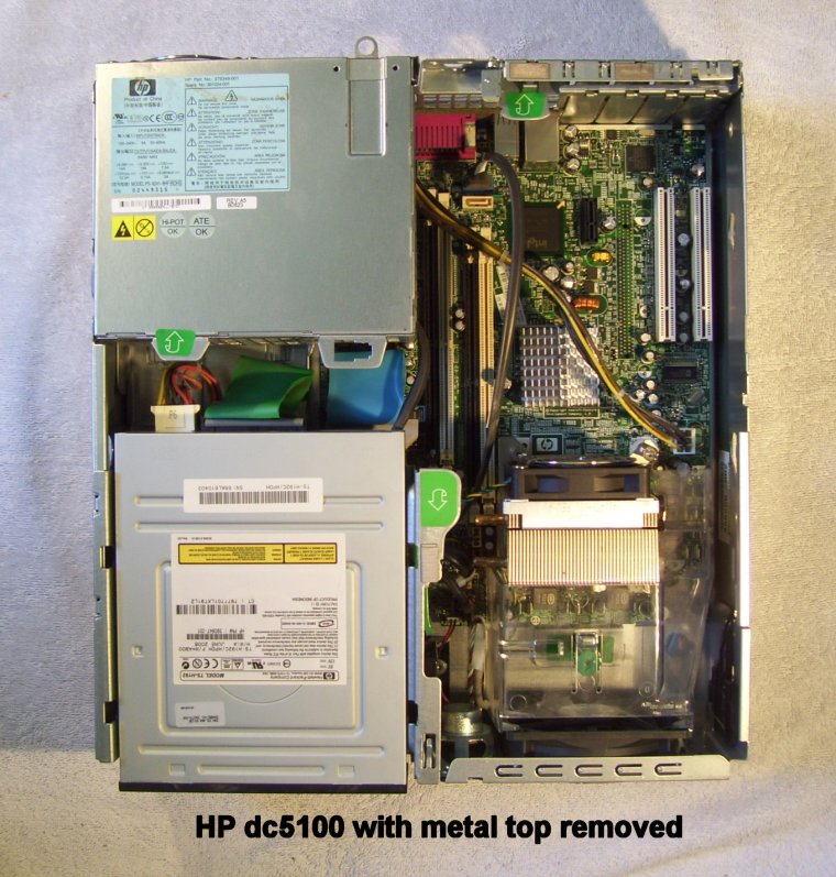

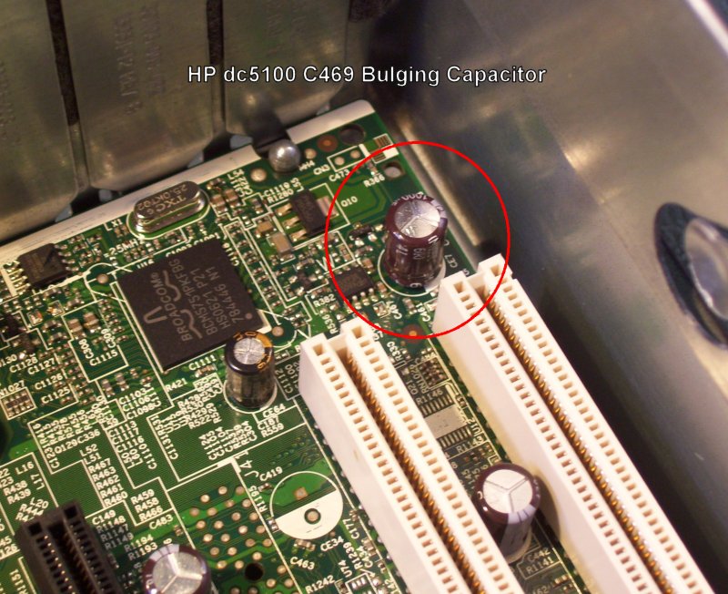

          I have repaired many of the HP dc5100 motherboards. The worst machines are the ones that are clogged with dust and no not ventilate well.
          The most troublesome capacitors I have seen on these motherboards are the 1000UF 6.3 Volt. Especially C469. When that cap goes bad, the fan goes to high speed. As it deteriorates further, the machine will stop booting. I have seen lots of the 220UF 16 V and the 470UF 6.3V go bad as well, but those smaller cap do not appear to be critical. I have had motherboards with 7 or 8 of those caps swollen, but the machine continues to run normally. Just to be sure, when I pull a motherboard to replace C469, I go ahead and replace all the other swollen caps as well.
