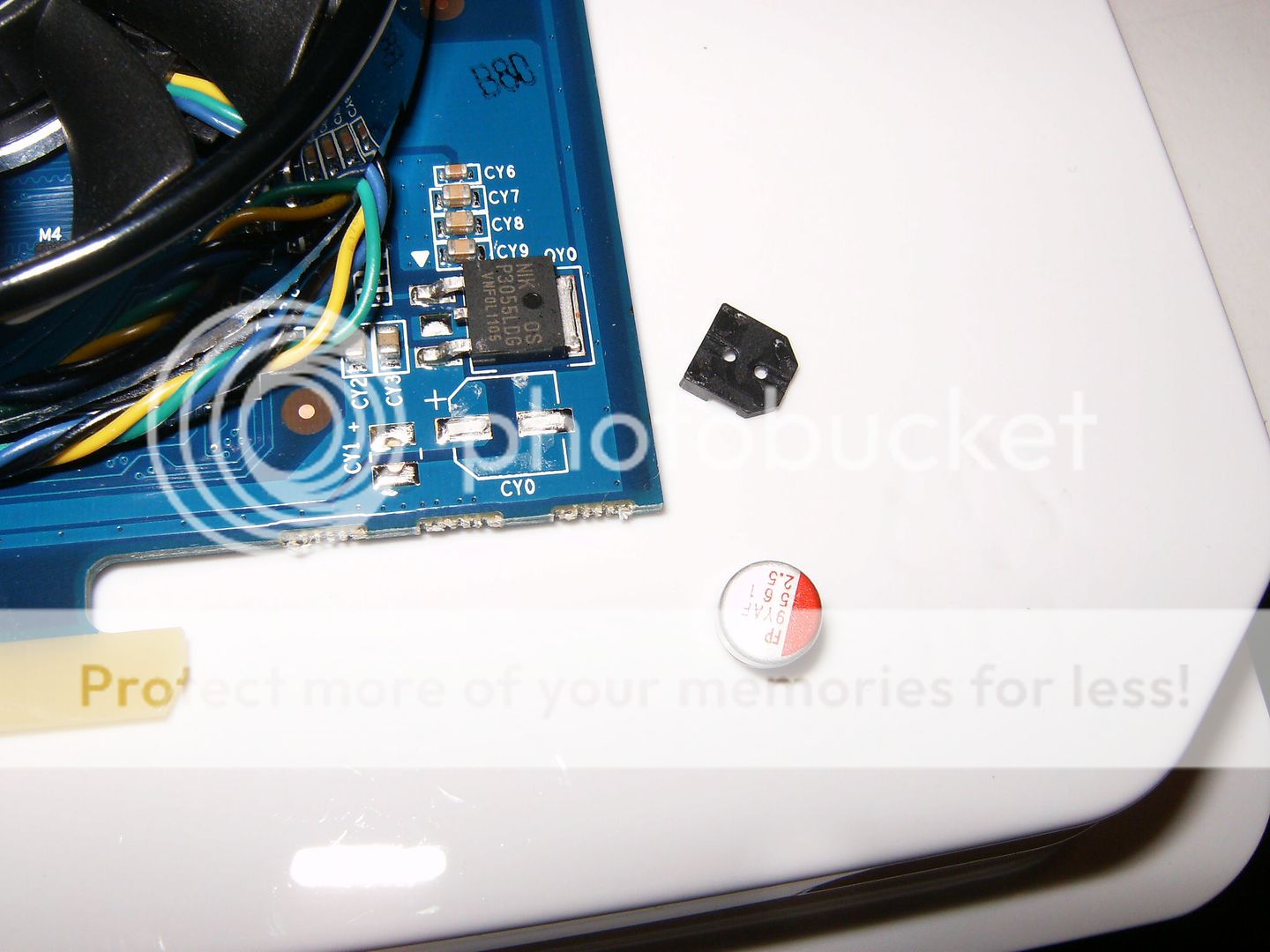

    PNY geforce 240
    Long story short
    Bought this on ebay, but the card was lose in the package and the capacitor broke off during shipment
    I want to solder it back but the legs were borken and are too short to make contact
    I want to find a replacement, but I have no idea how
    here are some pictures.
    The capacitor are about 6 centimeters in diameter
    any help would be great

    Most any small SMT E Lytic would do the trick.
    Just tack something on, watch the polarity (the notched graphic on the card and the cap base) and see what happens.
    Could not be any worse than the situation as it stands now.

      After some quick research I think I know the spec of the capacitors
      i think its
      2.5V 560uF
      am i right?
      what is a good place to find one of these

          It's a Nichicon FP-CAP 2.5v 560uF [Functional Polymer].
          9YA is a date or batch code.
          The F after it ID's the series but at the moment I can't find my cheat-sheet.
          The FP-CAP line used be owned by Fujitsu and was bought out by Nichicon.
          Older [Fujitsu] FP-CAPs will have a stylized F with a bar above and below as a brand trademark.
          Place to start:
          See page 3.

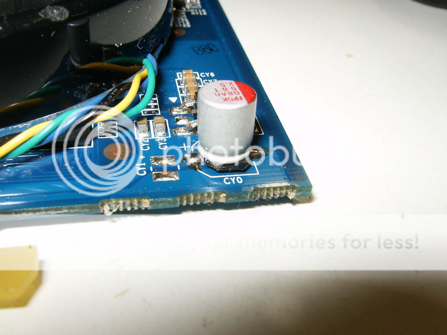

                              Okay, this one is a radial that has a 2mm lead spacing so the leads will line up correctly with the old base.
                              Do what you were thinking about and stick the leads through and bend them over to make it an SMD.
                              The ESR is also .007 ohms so it's consistent [in range] with the better spec'ed FP-CAPs.
                              The Ripple is 4200 mA [4.2 amps] which is pretty healthy.
                              It's 5mm so it should sit all the way into the base.
                              The one you mentioned earlier has a wider lead spacing [3.5mm or 5mm] and won't work out very well for that.
                              That one might even end up being too tall after assembled because the cap won't sit all the way into the base due to having to bend the leads to fit.
                              http://search.digikey.com/us/en/prod...7-1-ND/2239202
                              If the spacing on the holes is actually 2.5mm [or you want to enlarge them] there are other options in 6mm with a 2.5mm lead space.
                              The advantage would be that you could choose a cap with little a higher ripple rating.
                              [From what's available at digikey the ESR would be the same.]

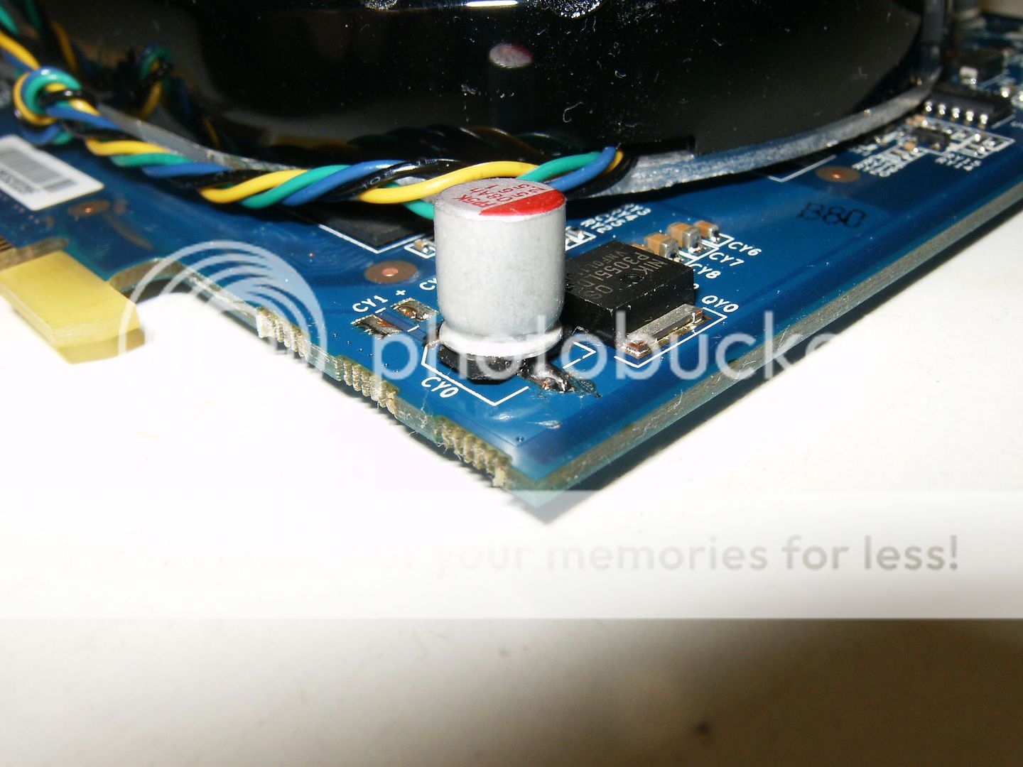

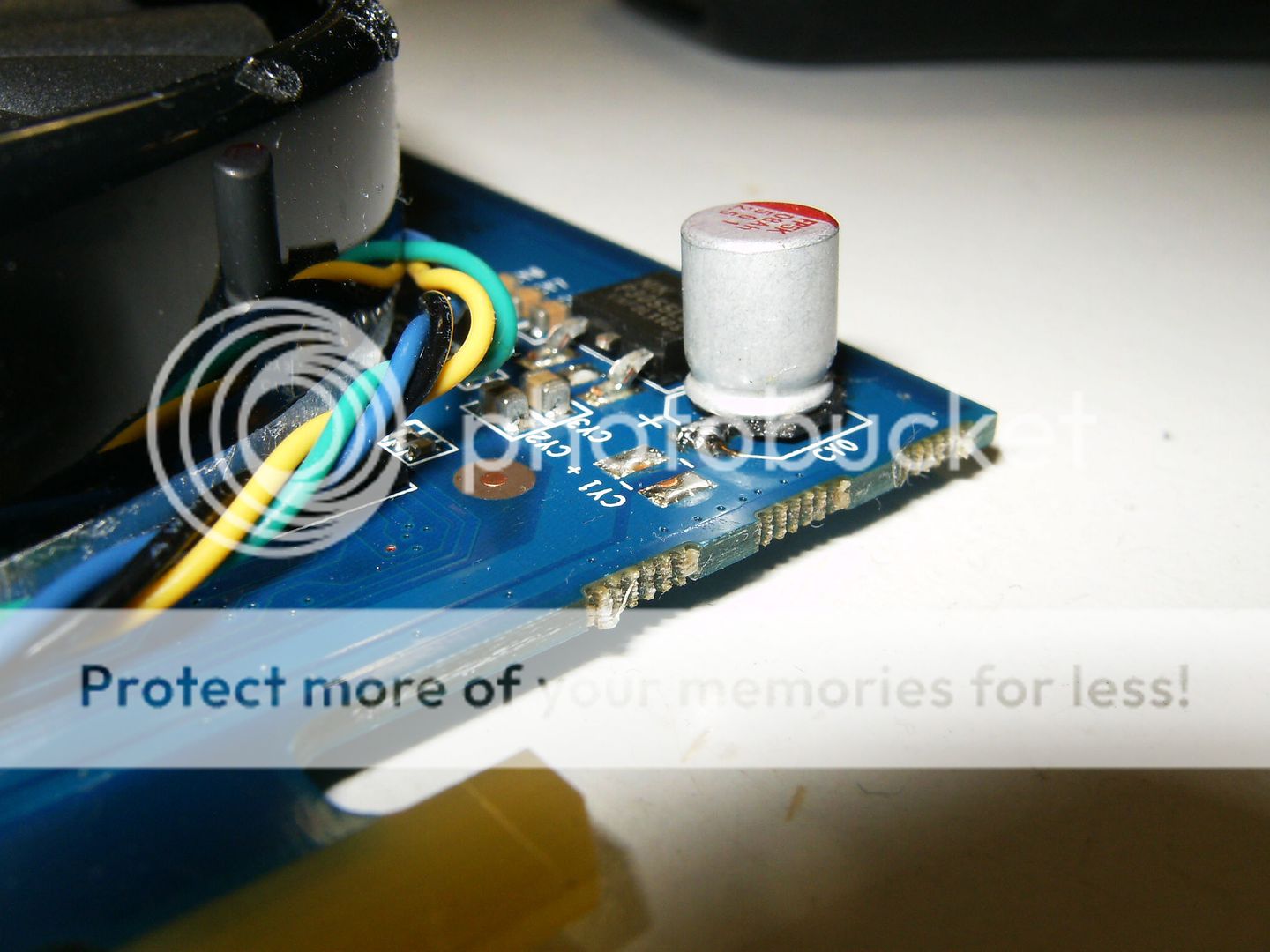

                                    Re: PNY geforce 240
                                    This is when it was new, a different card but same model
                                    RECAPPED
                                    can't say it was the cleanest job but it will do
                                    working perfectly, ran furmark to test stability as well
