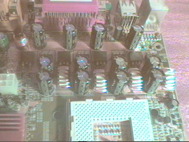

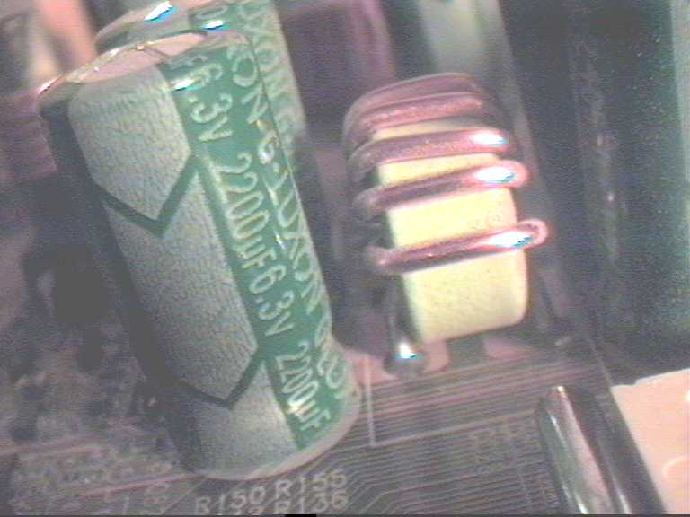

    This is ECS K7VZA/PC Chips M807 board version 1.0 (light PCB, non-A KT133). v3.0 has dark PCB and KT133A, although there are exceptions - dark boards with non-A KT133 north bridges marked as PCB 1.0.

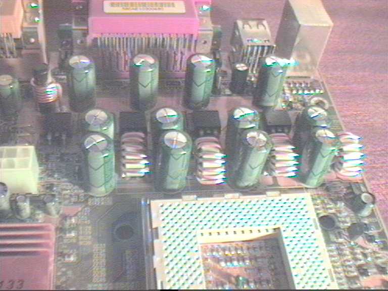

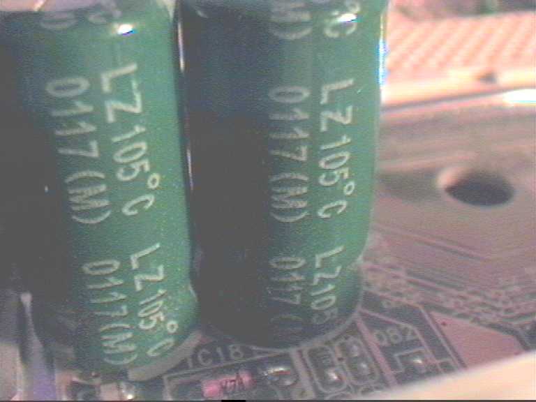

    The bad caps are G-Luxons - this type fails on many ECS/PC Chips boards. No MOSFET damage. The board is now recapped and works fine (no photos yet).

        Looks better now

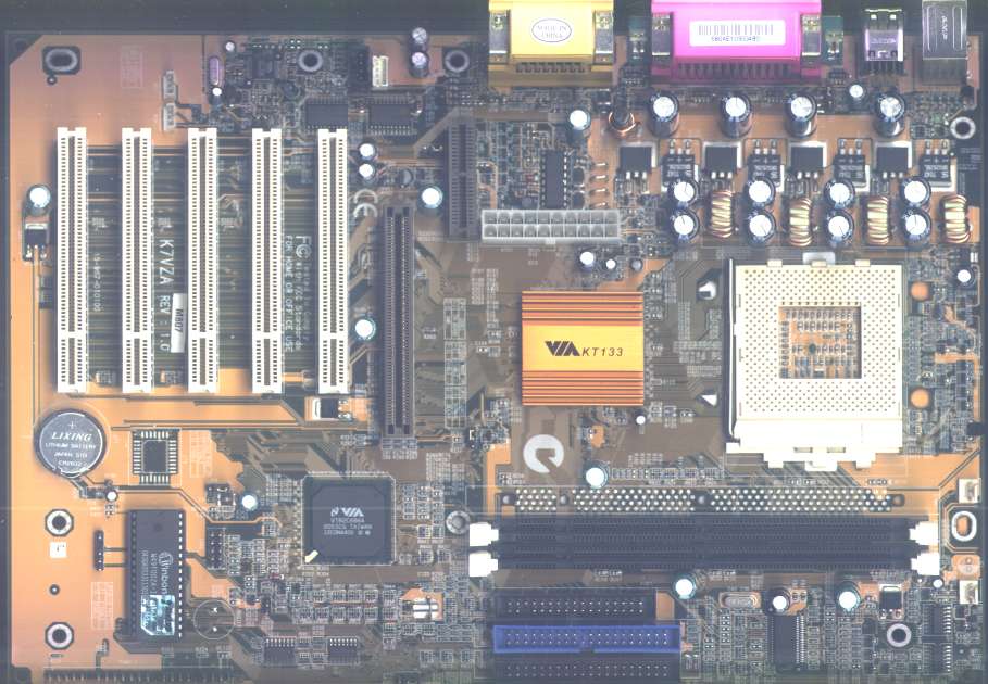

          And complete scan of the board, featuring moved M807 sticker
            Re: ECS K7VZA (PC Chips M807)
            I see an empty spot for a 3rd SDRAM socket, wonder if that can just be soldered in?

              Maybe. I've tried google search for pictures of K7VZA and all of them have 3 slots. Then searched for PC Chips M807 and they all have 2 slots. So maybe they saved one slot to reduce the price.

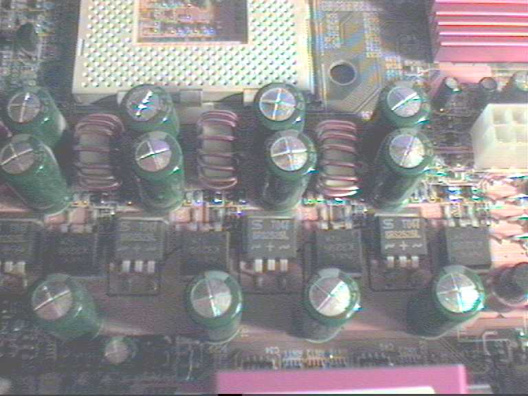

                          The Caps are getting realy hot, may be due to that bad ECS layout, may be this is the real problem of those ECS k7XX boards. The cooling copper area of the mosfets and the coils are not seperated from the caps. So heat will transfered direcly to the legs of the caps. Even with an Duron 700, considering that those boards are desingt for an Athlon 1400 err

                            And the VRM is not multi-phase - the 4 MOSFETs are all driven by one signal from TL494 - each MOSFET through its own set of two small transistors. On newer boards like K7S6A, there are only two transitors (but TO92 instead of SMD) that drive all 4 MOSFETs.
