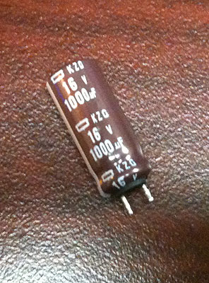

    Need ASUS Capacitor KZG 16v 1000uf
    Wondering if anyone knows where I can get about 5 Capacitors.
    The information on the capacitor is:
    KZG
    16v
    1000uF
    Included a picture just to help a little. I have about 4 that are on a ASUS motherboard that swelled at the tops. Causes all kinds of computer issues as you can imagine.

    Re: Need ASUS Capacitor KZG 16v 1000uf
    The cap is made by United Chemi-con, part # EKZG160ELL102MH20D-ND
      Use these https://www.badcaps.net/store/produc...products_id=45 and they do not have to be swelled to be bad. I would replace all the KZG series caps swelled or not.
        Are they 8mm or 10mm?
          8mm. I can tell from the pic

            Hi everyone
            I'm new here and found this post which is exactly what I was looking for. I have a question : I can't find this specific capacitor but the next reply after you Jetadm123 has a link to a similar one by Rubycon. In the specs the Ripple Current @ Low Frequency and high frequency are different then for the United chemi-con one would this pose a problem?
              For PC motherboard use, no, this wouldn't be a problem.
              Those 16V 1000 uF KZG caps are typically used to filter the 12V rail for the CPU VRM. So if yours are somewhat close to the CPU heatsink, that's probably what they are used for too. In which case, the Rubycon ZLH series that brethin linked to should work just fine.
                i recommend nichicon uhz 16v 1000uF which you can sometimes find on mouser.
                  So I went with the ZLH. Searched for hours for the original one and looked at others too in case but ZLH is the only one that fits the specs.
                    Those should work too. But just keep in mind Nichicon no longer makes the HM, HN, or HZ series. So anything you find on those will be NOS (new old stock.) If these are over 5-8 years old in storage, they may benefit from a voltage reforming treatment before use.
