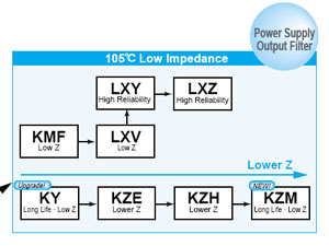

            The two series use somewhat different electrolyte technology. KY is lower Z, rated for higher ripple current, and longer life. I'd go with the KY and suggest smiling as you write the check.

                  The KY has lower ESR and higher ripple current, but the endurance is comparable (6000 hours vs. 5000 for the LXY) for the 10 mm diameter. I'd agree that the KY is better for motherboard use.

                    I was commenting to a co-worker yesterday about the cultural thingy wrt the KY series name. I think the LXV and LXZ series cover a wider range than the LXY.
