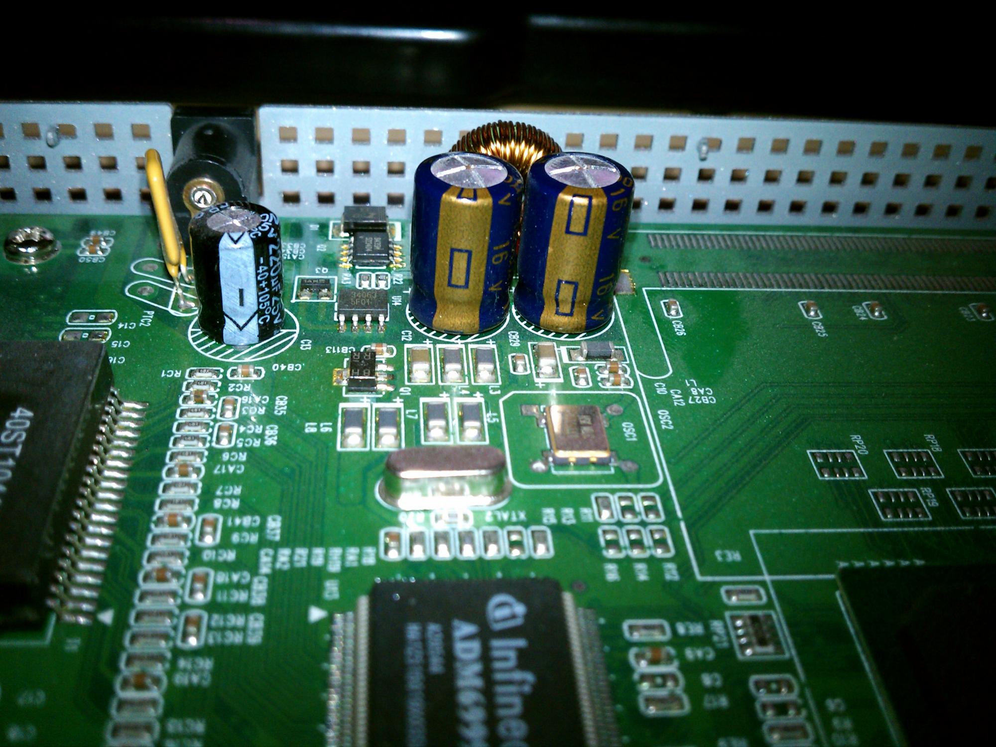

    Need help indetifing cap sizes.
    Hi I have a Linksys RV042 router with some bad caps. I'm trying to figure out what sizes I need there's two different sizes on the caps I need here's a picture maybe somebody can help me who has much more experience in this field than I. The two on the right are 1000uf 16v and the one on the left is 220uf 25v.
    http://img97.*************/i/img20110121151016.jpg/

    Re: Need help indetifing cap sizes.
    Assuming 16mm height caps will fit (i.e. not too tall), you can order them from badcaps.net to support this site. Both are high quality low ESR Rubycon caps.
    https://www.badcaps.net/store/produc...products_id=44
    and
    https://www.badcaps.net/store/produc...roducts_id=117
    PS. For the future, please use the manage attachment button to upload pics to here.
      Thanks for your help I planned on buying them from here.
      I'll use the attachment system in the future.
        Attached it for you
