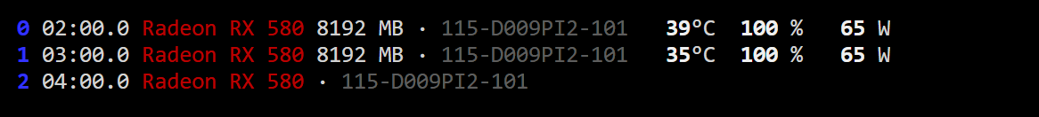

    Hello
    I have a rig of 5 ASUS dual rx 580, suddenly 3 of the cards stop to be working. it look like OS is not able to recognize memory size . 3 cards at the same time ot of 5 cards. the attached picture show the problem in one of those cards. the last one in the list. i try to flash the bios from a working card and from https://www.techpowerup.com/ , but no luck the card still show same problem
    What could be the problem ?

    bad vram chips

      Or vram power supply
