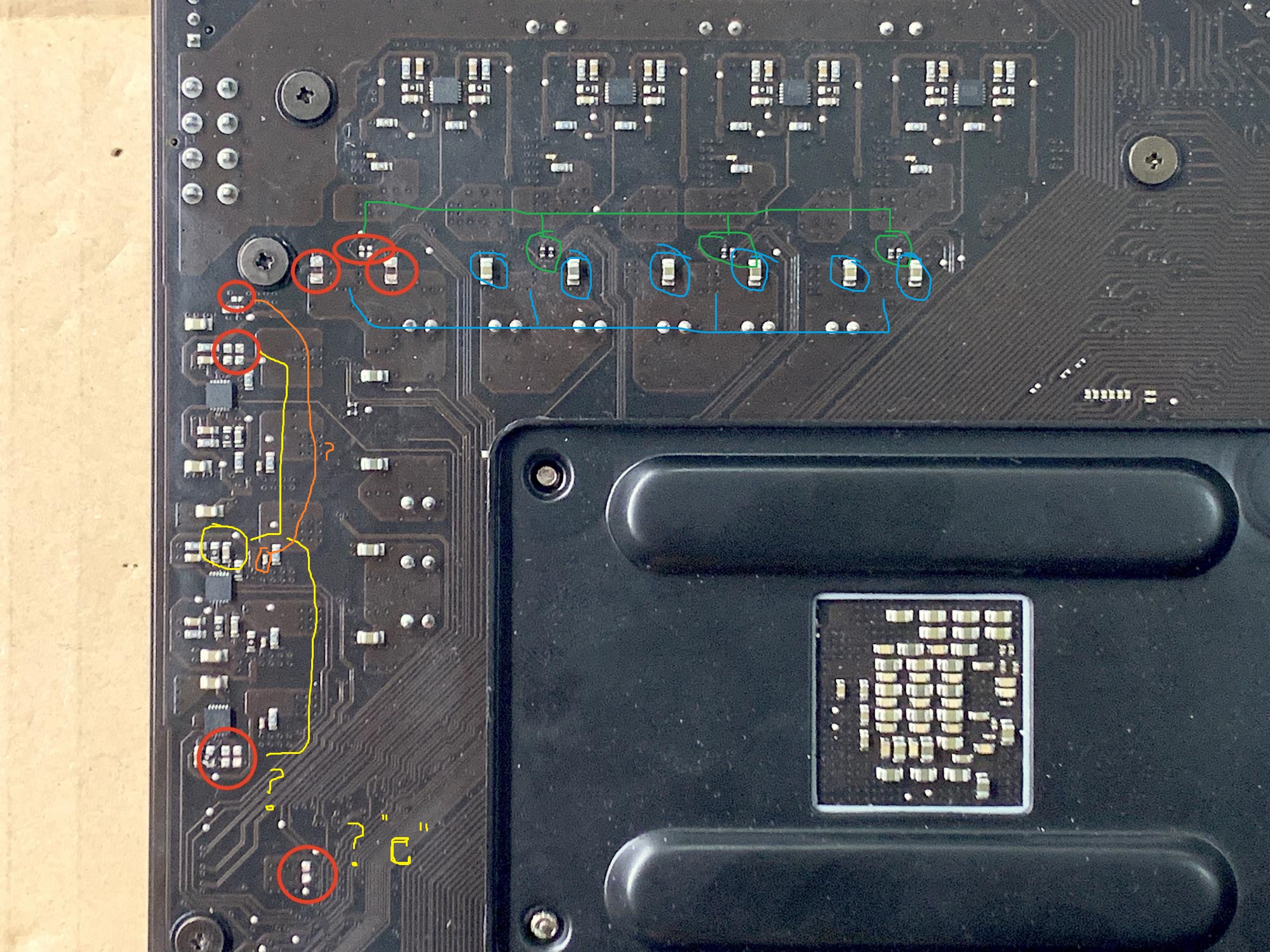

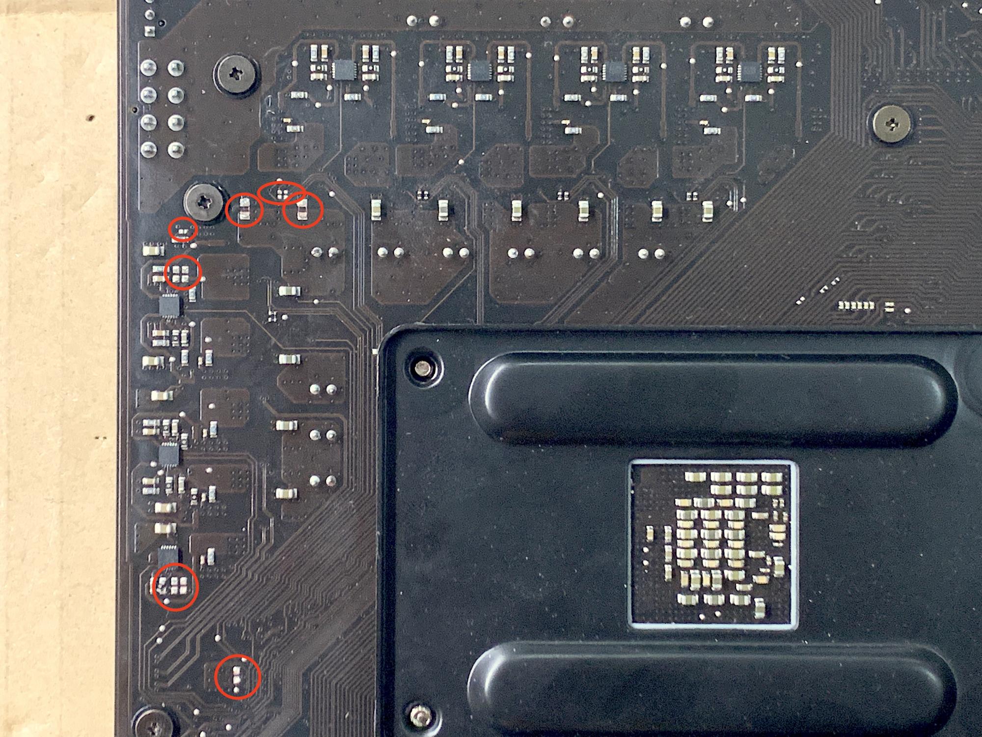

    Hello, just wondering if anyone has the same board to help or have a schematic/boardview so I could restore its VRM circuit, a lot of knocked off components here on bottom side of the board and any mistake would probably burn either CPU or VRM circuit to ashes.
    Mobo is Gigabyte B550 Gaming X V2 rev 1.1
    Here are the pics and I did mark everything I am missing
    Thanks in advance

    Re: Gigabyte B550 Gaming X V2 knocked VRM components
    You have everything you need on the MBO.
    The patterns are repeating.
    Desolder the parts measure them and put new ones on missing pads.
      Possibly like this:

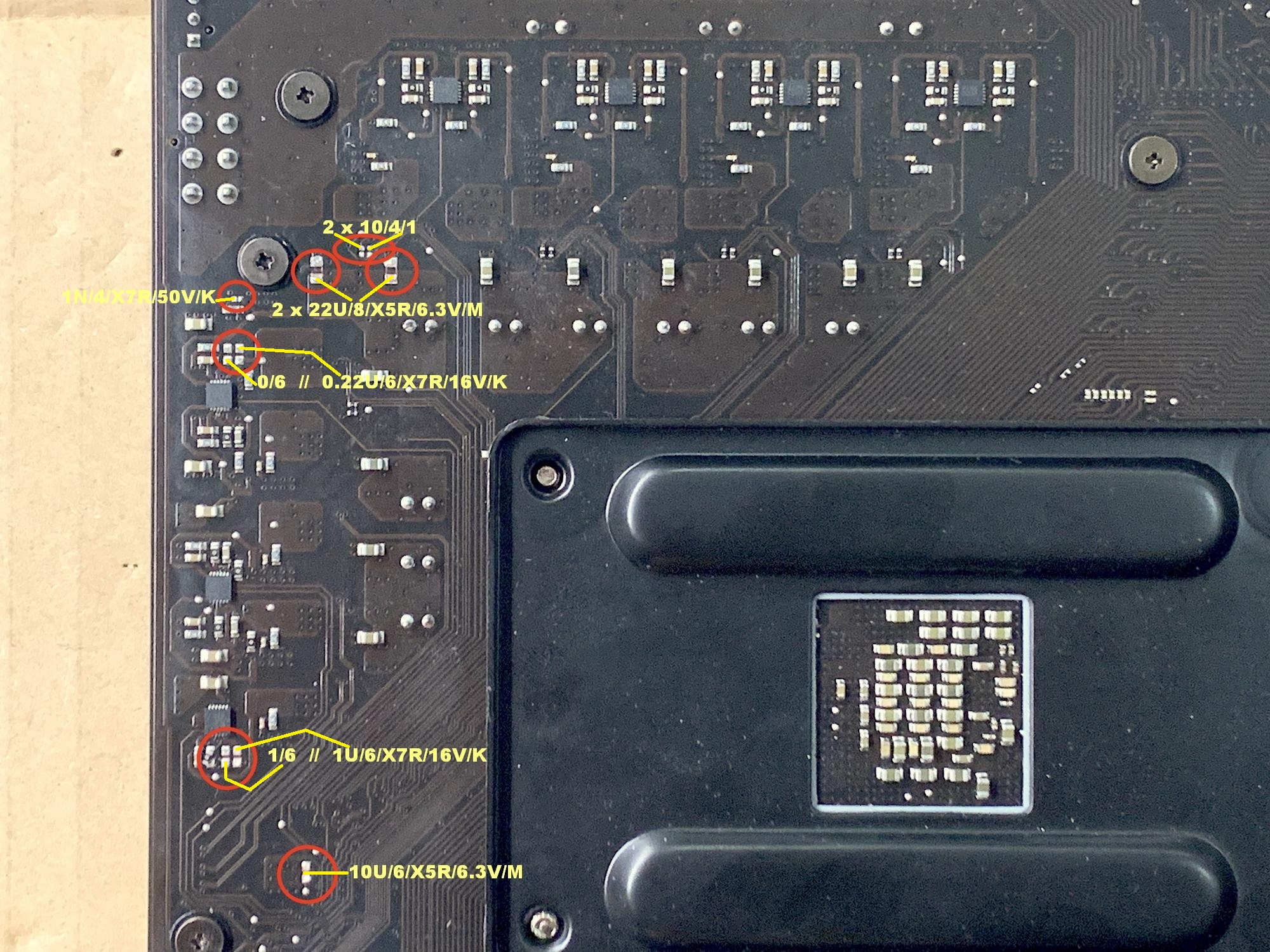

        Here you have the exact values:
        eg. 1/6 - means 1 ohm, 6 is probably the case size or maybe power handling, rest is selfexplanatory.
          thank you so much guys, I will try to get this looked at soon and report whether it has blow up or work
            thank you again, especially @DynaxSC. i replaced all the components as you specified on your picture and motherboard works just fine and all phases has good oscillograms!
