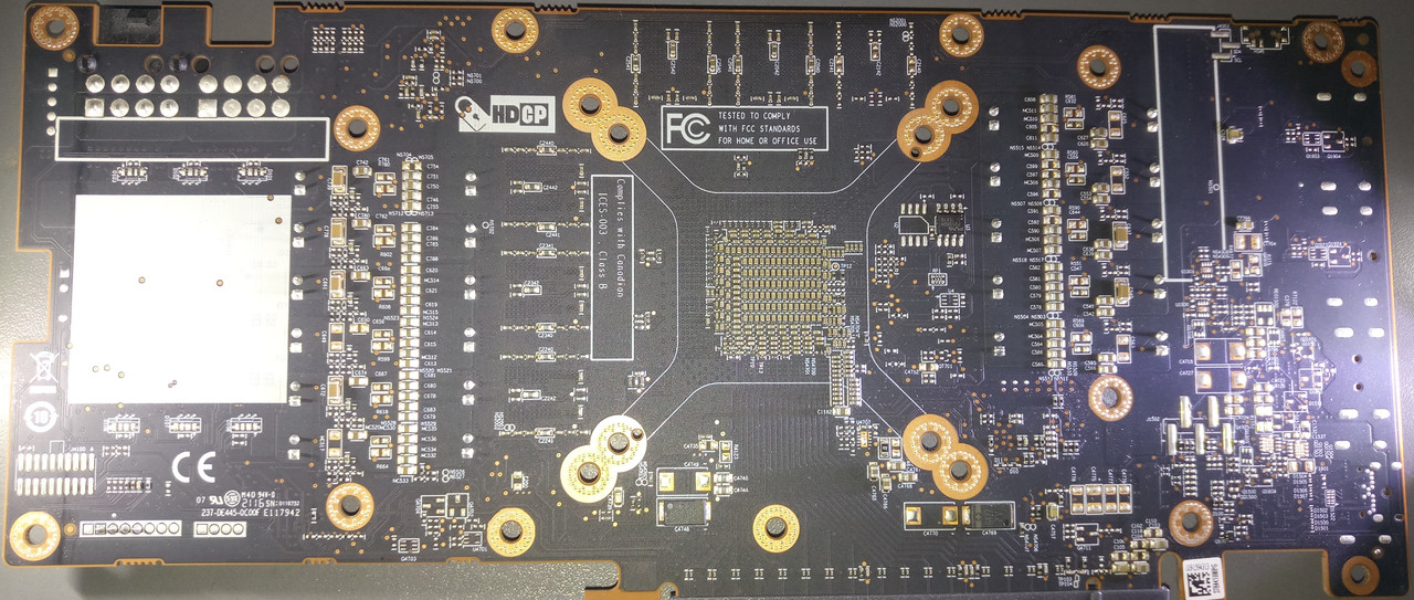

    I asking because I can get myself new one unused for half price of Rx 6600xt.
    From photo their pcb looks like Sapphire RX 6700 10Gb but missing video outputs.
    I have some experience with soldering, I only concern about what smd parts to gets and if I can Flash Bios on it ?
    Any one know list of needed smd parts caps/ resistors for HDMI and Dispaly ports ?

    Re: Sapphire GPRO X080 (RX 6700) anyone try add video output ?
    I get myself one photos
    For comparison Sapphire Rx 6700XT
    Any one can help identified missing components ?
      I borrowed from a friend Rx 6700xt to make some measerments
      Close up
      I recognized parts thanks to comparison to Rx 5700Xt board view
      GH15E - AZ1117CH-5.0 x1 BCD Semiconductor
      K27E 7 2n7002dw Sot23-6 x7
      MA 76 6 MMDT3904-7-F x3
      WCM 13 2n7002l x4 Nexperia
      1N x1 3 pady - I do no know what this is ???
      I have also some diodes any advice ??
      Top layer this can false identification due diodes read can be from mosfets
      bottom layer esd protection diodes I probably can go without of them due 5700Xt used 2 kinds of diodes esd131-b1-w0201 and esd5v3u1u-02lrh
      Resistor are easy to measurements and they are equal to used in Rx 5700xt
      Caps values I getting from Rx 5700Xt board view
          I think add top 2 display ports due schematic that I have from Rx 5700 full info and RX 6700 only info about resistors and capacitors, but they they have different values for capacitors on bottom display port and one of smd needed for HDMI is no longer available to buy, values of capacitors, resistors I getting from schematics.
          Before I order parts please check this SMD that I identified:
          K27E 7 - 2n7002dw - Sot363 - Panjit On schematics from Rx 5700 show 2n7002dw
          MA 76 6 - MBT3904DW1T1G - Sot363 - On schematics from Rx 5700 show mmdt3904-7
          WCM 13 - NX7002AK - SOT23 - On schematics from Rx 5700 show 2n7002e
          1N - SOT-416 - BC847T no longer available to buy On schematics from Rx 5700 show mmbt3904 and is different size Sot363
          GH15E - AZ1117CH-5.0TRG1 - SOT-223 On schematics from Rx 5700 show az1117ch-5.0
          Fuse
          B - 0.125A
          P2 - 2A ? - PPTC Resettable Fuse on Rx 5700 show 1.5A
          Caps
          100uF 0805
          22uF 0603
          1uF 0402
          0.1uF 0201
          Resistors all 0402
          0hm
          100Ohm * r100 on schematics
          500Ohm
          1.1kOhm
          2.2kOhm
          10kohm
          1mohm
          5mohm
          Can you check if my identification was correct ?
            Update:
            GPU chip have laser off sense pin for detection if monitors is plugged on all ports, I know because I put all smd *( even freaking 0201) and display ports on board and not worked and only after this I notice it I been fooled due all data signal pins are still connected and have correct resistance values :/

                  Looks like I not notice this strapping resistors next to core damm :/
