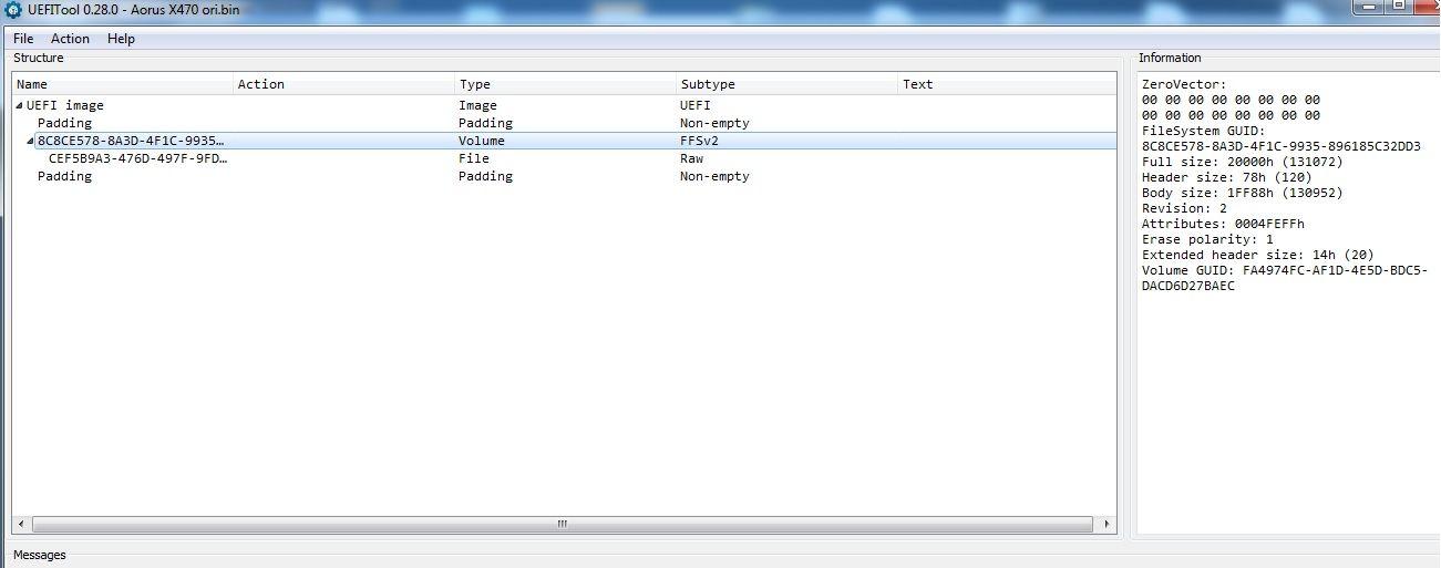

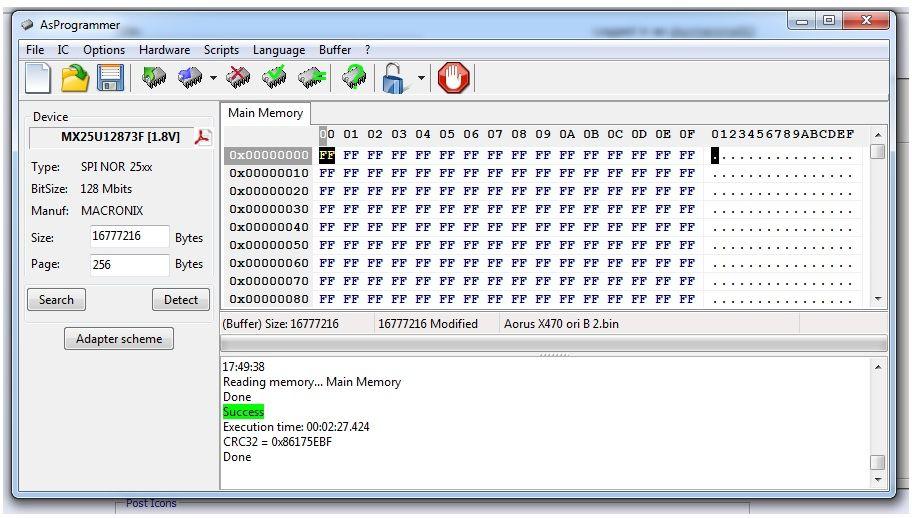

    I got a gigabyte Mainboard here, thats not powering on, i inspected the whole board for any physical damage but didn´t find anything. so i took my ch341 an read both of the bios chips these are both MX25U12873F.

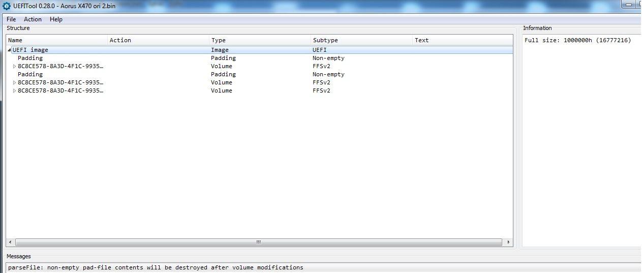

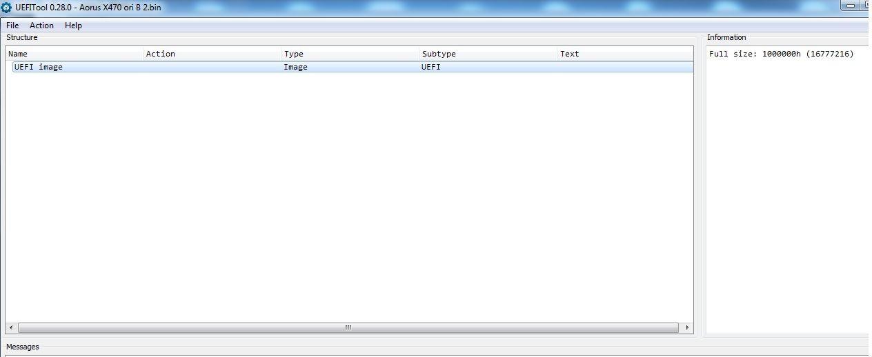

    i found out that the images dont match. do they have to be exactly the same? or is it possible that the second chip is only for a smaller image to repair the currupted first one? i´m very new to this and woul appreciate to get some help.
    Main Bios and backup bios are different in Uefitool and on second one a lot is missing...
    main bios
    b bios no information
    is this correct? i didnt found any informations about how this works exactly....
    board only flashes once if psu is turned on. if i start it its cycling all the time like in my experiences almost all boars had problems with corrupted bios...

    Re: Gigabyte Aorus x470 bios questions
    2 x 128 Mbit flash
    Use of licensed AMI UEFI BIOS
    Support for DualBIOS
    it dual bios , so should files be same size most likely not , and there's should be a way to enter dual bios recovery mode and cant find the exact guide but heres some info
    Try this:
    System powered off
    Press the power button
    Count to 6
    Press and hold the power button (shut off system)
    Press the power button again
    Count to 4
    wait 5 sec
    Press the power button and let me know if the BIOS recovery starts?
