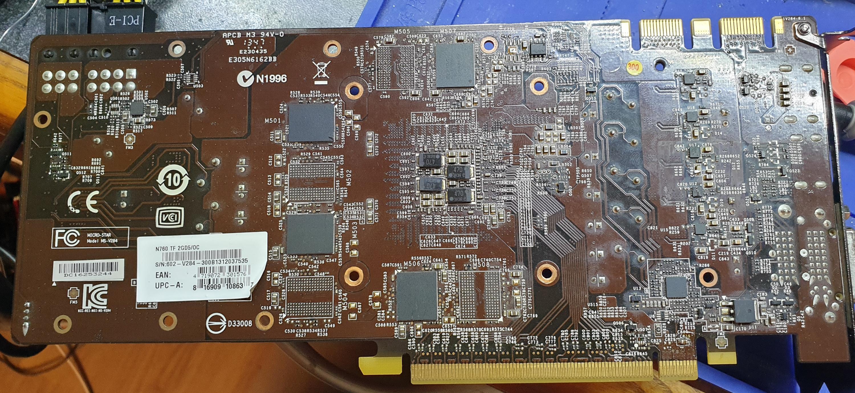

    This is a MSI GTX 760 2GB card MS-V284 ver 8.1
    On the GPU there are all voltages and GPU is warming but motherboard cant detect.
    (I dont have boardview or schematic.)

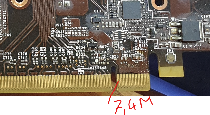

    Then I checked the resistance between PCIe pin 11 and GND and I measured 7,4 MOhm. Because this is the PCIe RST pin.
    I think it is wrong, because on any other card the value is infinite resistance between this point and GND.
    Does anyone have any info on this part of the circuit?
    Re: MSI GTX 760 2GB voltages ok but cant detect gpu
    It seems to be the the resistance is OK, because I have another card and that is similar than this. (Gigabyte GTX 670 2GB)

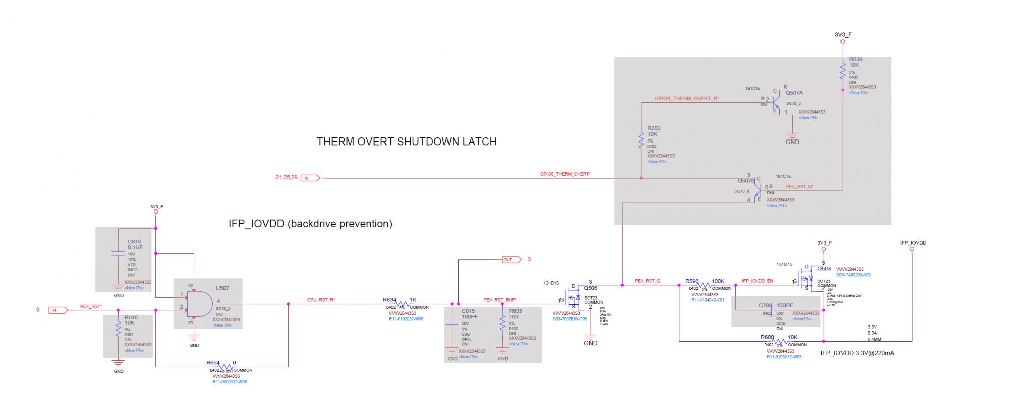

          So I found schematics but dont helped for me at the moment.
          On my card are some parts missing but it seems to be factory. I marked it on the picture with grey square.
          I measured the voltage on IFP_IOVDD point: 3,3V I think it is normal.
