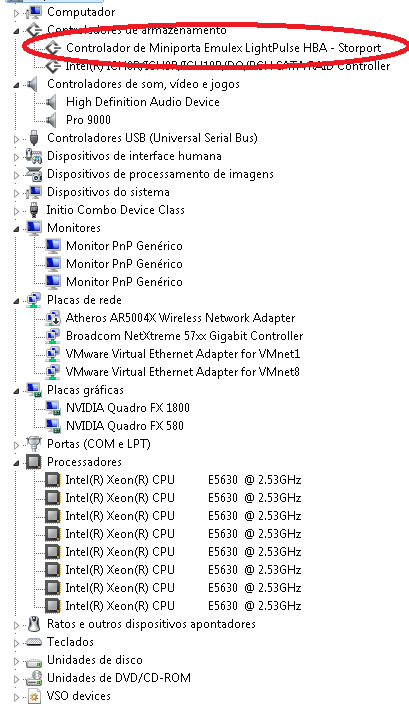

    Hi
    I bought a nice gigabit router with 2 fiber ports, the respective transceivers , 10mts of LCLC cable and some pci-e emulex LPE1150
    now, the catch , its the first time that i touch fiber stuff, in my grunt mind it should appear a new nic on windows and boosting my lan and file transfer to 2gb but it doesnt
    appear a HBA port no NIC, anyone have some experience on this field before i go swimming on pdfs and datasheets ?

    of course it should show up in windows as another nic... does it not?
    how are you testing throughput?

      Re: Ethernet over fiber
      Hi , nop , no new nic card just some Emulex lightpulse HBA- Storport
      ty for your quick response
          in device manager?
            wait a minute... i think the card you ordered is for storage, not networking.
            HBA and NIC are not the same.
              rrrr some pic from device manager
              but probably your are 100% right
              i have 3 nice cards to trash xd
                          now i know hard way, well must order NIC plain and simple and run from CNAs HBA and all that

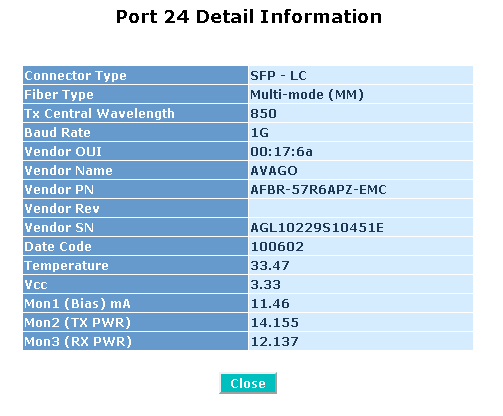

                              gsw-2494
                                That's a layer 2 managed switch not a router.
                                What transceivers have you got ?
                                It's doubtful you will see much of a speed difference between the fibre and the gigabit ethernet ports.
                                  Avago AFBR-57R6APZ EMC 4.25Gbps 4Gb Fibre Optic SW 850nm SFP Transceiver Agilent
                                      Here's the manual for your switch.
                                      https://cdn.badcaps-static.com/pdfs/...d5cebb8817.pdf
                                      It shows support for 1Gbps SFP transceivers.
                                      Have you tried yours in the switch to see if it's recognised ?
                                        Hi
                                        i thought it was 2gb ... so it wouldnt be faster than my gigabit connection
                                        mariushm , will review the info that you posted , it seams a good option those quad channel or 10gbs fiber...
                                        diif, its reconize the transceivers but @ 1gb wich now i see its normal
