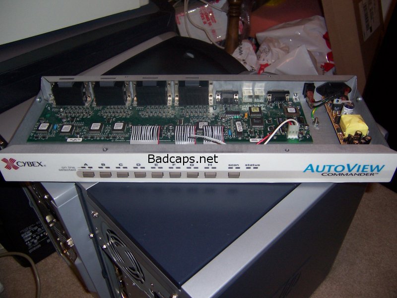

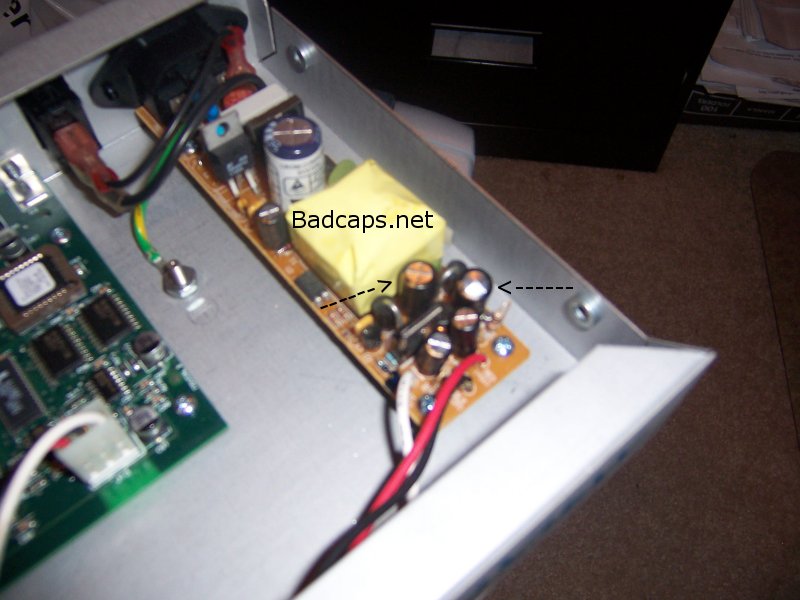

    Yup, this one from my own server array.... I noticed it was acting funny, KB was intermittent, and display was ghosting.... Open it up, some bad Lelon's in the power supply....
