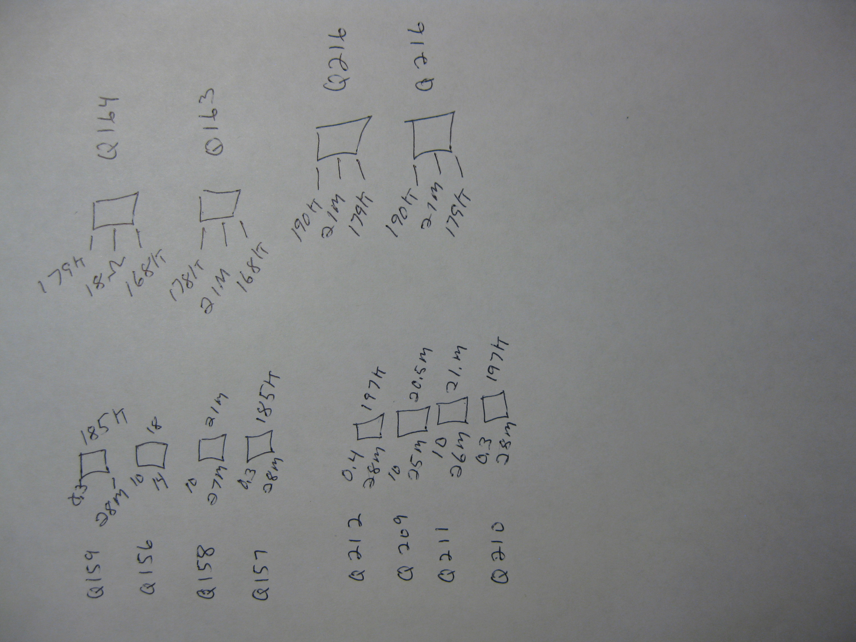

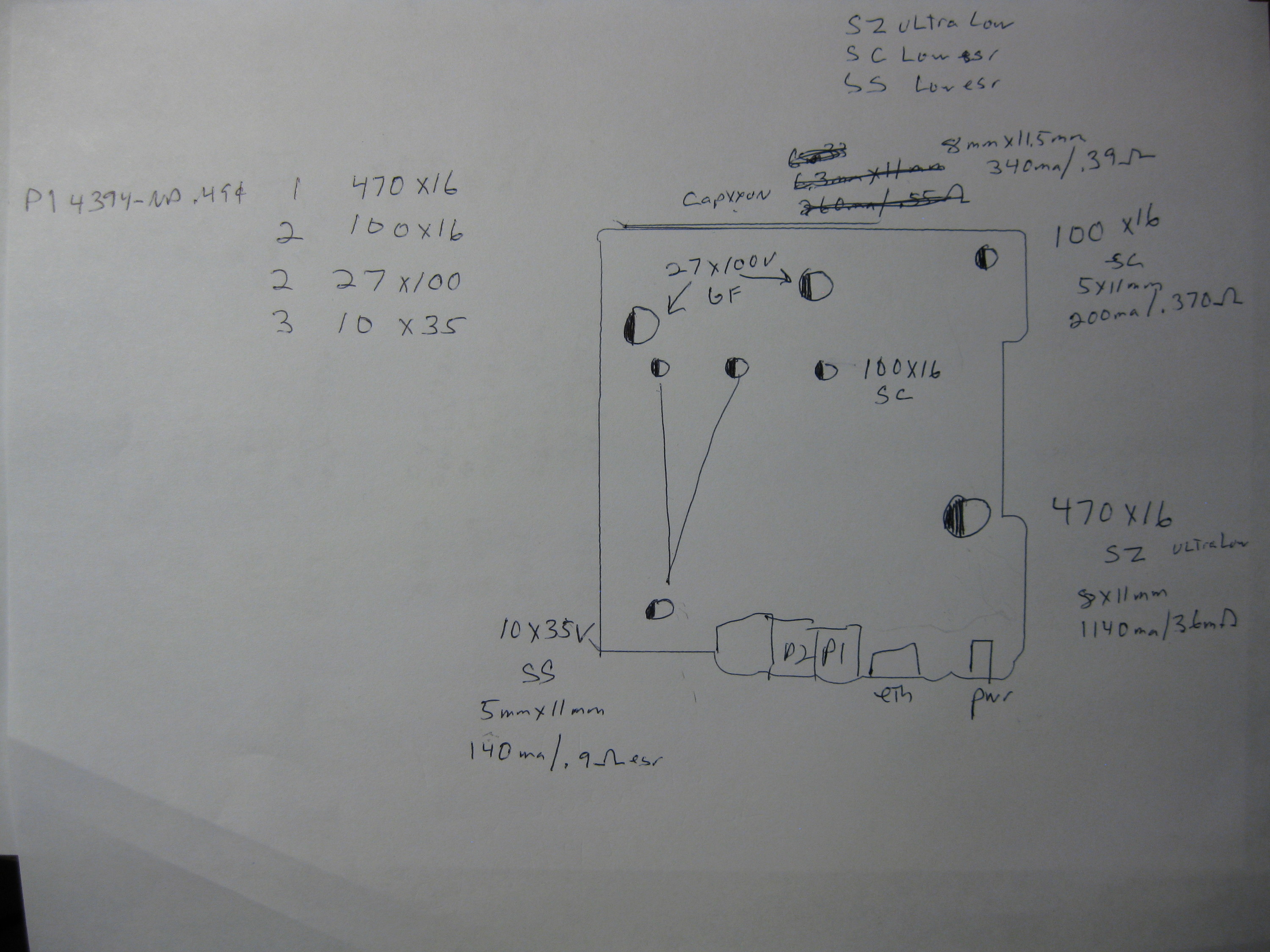

    Linksys PAP2 VOIP adapter had dialtone but with loud static noise. All caps are Teapo execept the two 27uFx100v which are Capxon. LOC pic has datasheet info if you can read my scratches. OHMS pic has readings to ground at top left screw hole in ohms. The readings are rounded a little but should still be usable.
    Started with visual inspection - all caps/everything looked normal to me. Plugged in power supply and felt for hotspots and found one! Started measuring ohms and looks like Q156 is shorted to me. Q164 has one odd reading but probably affected by shorted Q156?

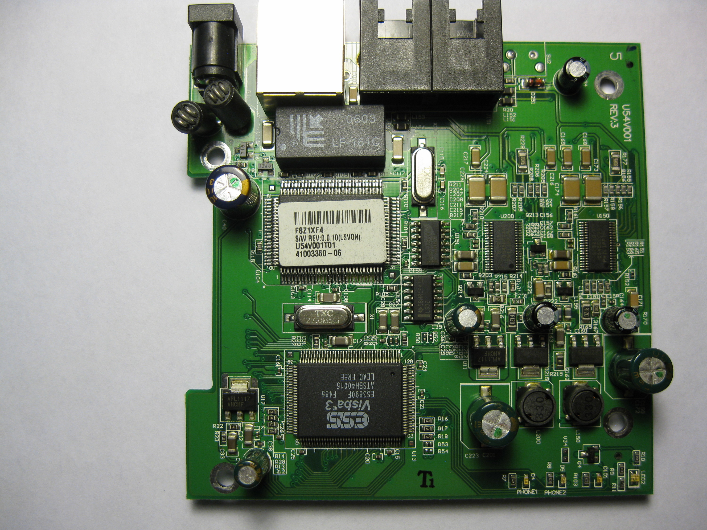

          Hello, just to register this here.
          Got one that would keep rebooting continuously. Red light, lan light, all lights on, then go over it again. The caps in the input side of power supply were ok.
          Could not get readings in the 1117´s, because the unit seemed to reset the power circuits.
          Inspired by an youtube video, discovered one of the coils open in the areas circled in red. Changed that, and the thing got to work again.
          I´ve edited nitelite´s picture to show where.

              Another symptom I noticed before the repair was the board had been running hot in a particular area above the pair of SMD coils (center RH side, note Rogfanther's picture.). Couldn't narrow down which component though since just touching the area was enough to make it crash go cold and would have to reset it each time for it to happen again. But after the repair that area would just be normally warm.
