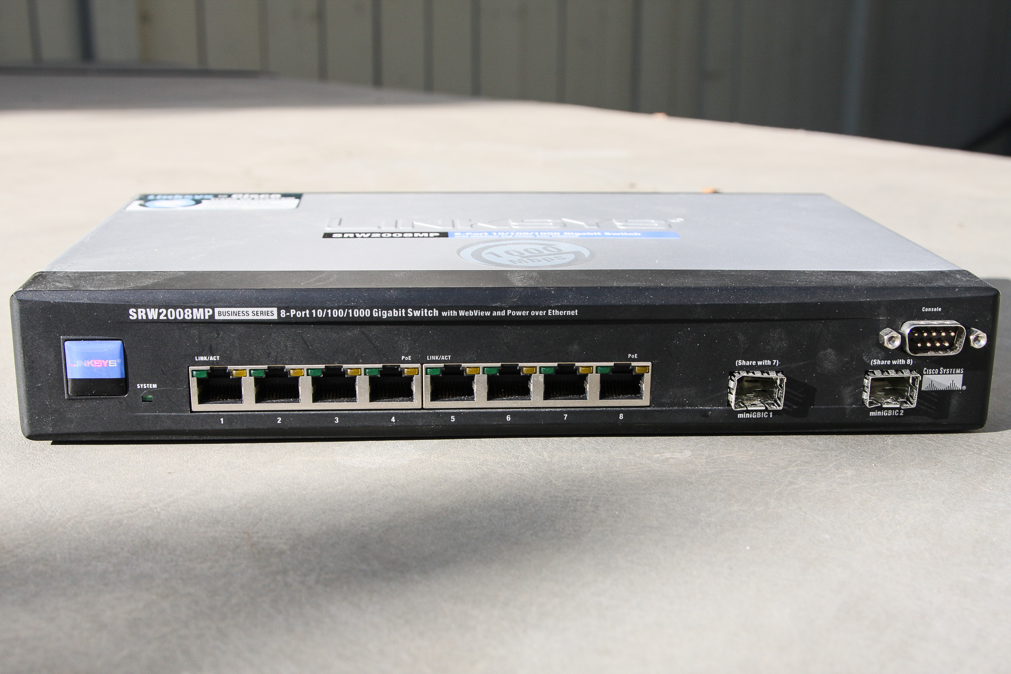

    A while ago I posted about taking a risk and purchasing some bad switches from a shady recycling company.
    2 of the switches are Linksys SRW2008MP 8 port Gigabit POE switches.
    Yes they're Linksys which I hate, but these puppies aren't cheap.

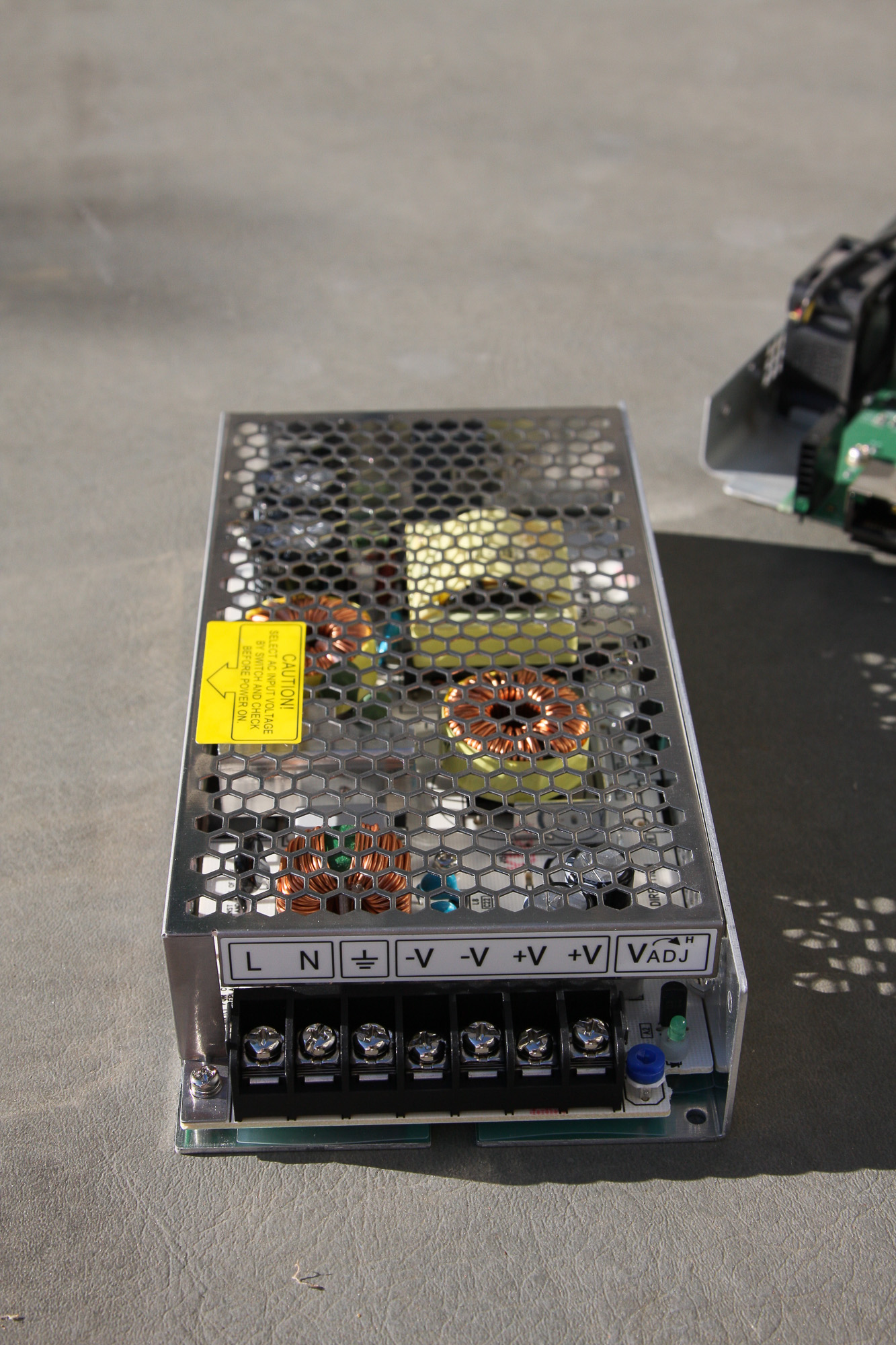

    They came with no power supply which I knew ahead of time, but I didn't know they needed 48VDC at 3.1A (I should have known, they ARE POE...)
    I'm guessing the original power adapters were crap quality.
    I finally got around to testing them, one works but has a noisy fan, the other will power a POE device but has no network activity.
    I purchased a couple of relatively decent quality, not too expensice TDK Lambda 48V 3.3 A power supplies.

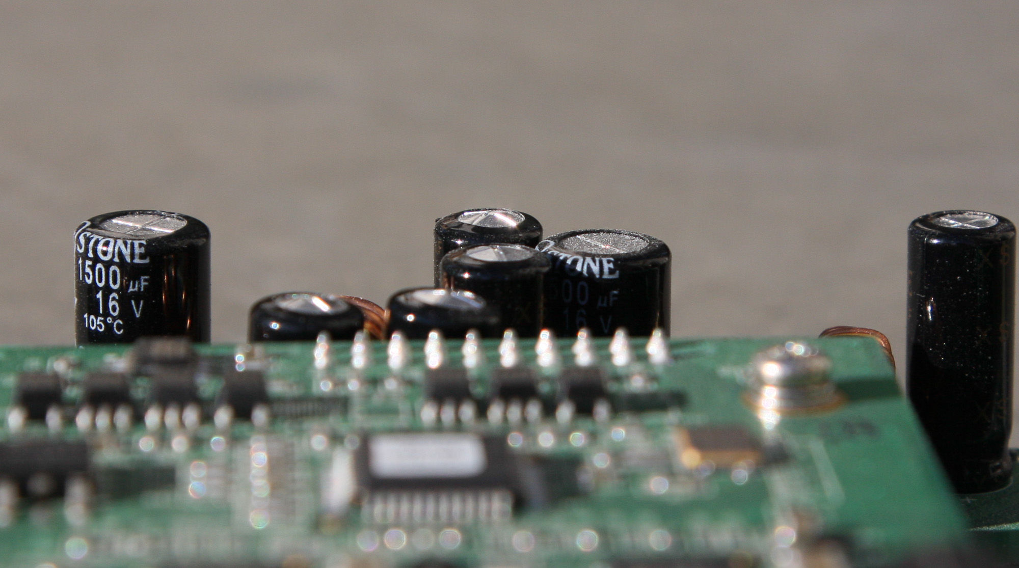

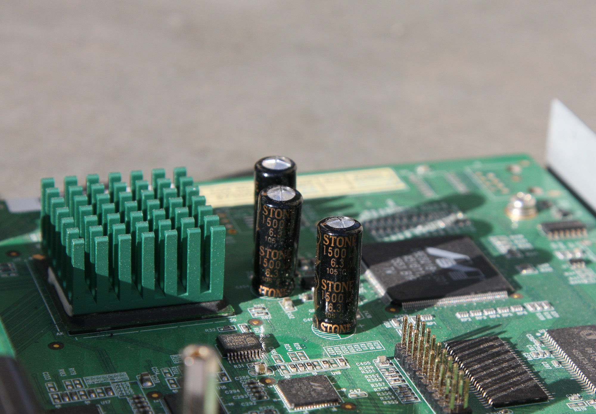

    Anyway, finally cracked open the bad one (a bit of a mystery, but finally figured it out) and looky looky, bloated caps! Might just be repairable!
    Will update once I've re-capped.
    P.S. Anyone seen these "Stone" caps before?

    Yep, those Stone caps suck... whoever decided to use them was stoned...
    • Uranium-235
      Comrade Glimmer
      • Aug 2007
      • 5042
      • US
      Re: Linksys Gigabit POE Switches
      I have a Linksys/Cisco SRW2048 that I bought from goodwill for $20, indeed 22 bad 'stone' caps. Stone seems to be what Linksys uses in most of their business equipment. I replaced them all with rubycons and the switch worked fine (was freezing before that)

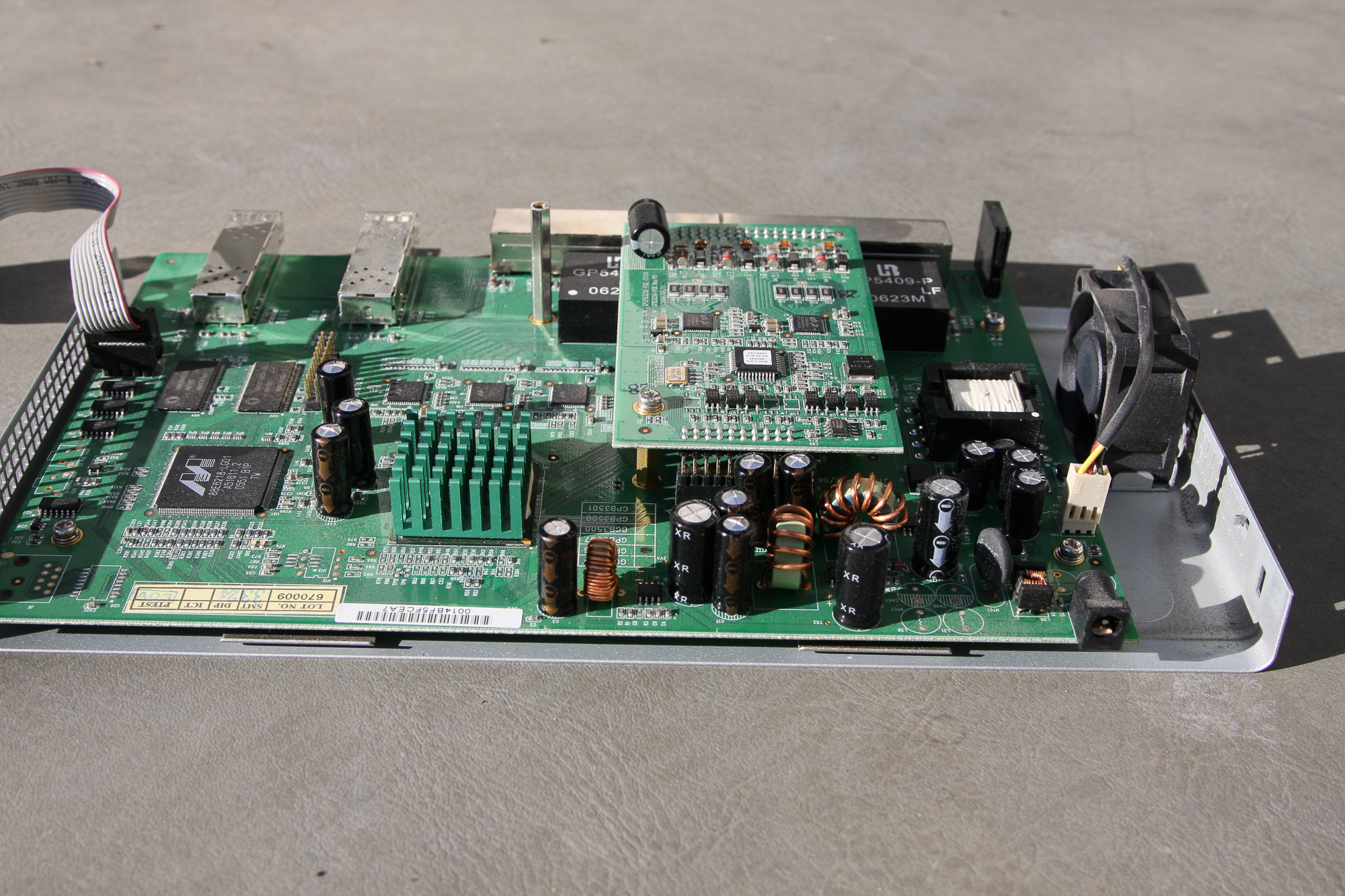

              Update:
              Recapped the dead one, and it's still dead.
              Opened the working one, and the caps were worse than the dead one
              Recapped the working one, and stole the fan from the dead one. Man, I think these were the most difficult board for desoldering caps I've ever encountered.
              I thought for sure I was going to damage the board trying to clear the holes.
              The dead one will power a POE device, but is otherwise dead. Some initial tests, the 48V is live to the POE module, but 12v 2.5v and 1.2v are missing.(2.5 and 1.2 are labelled on test points)
              No obvious faults, no fuses that I can see, and most of the low or 0 ohm resistors that might be used as a fuse seem good.
              Will try to get some photos tomorrow, and will look up pinouts of some components and check them. Hopefully it's a bad SMD FET or something available.
