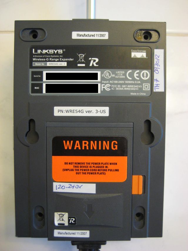

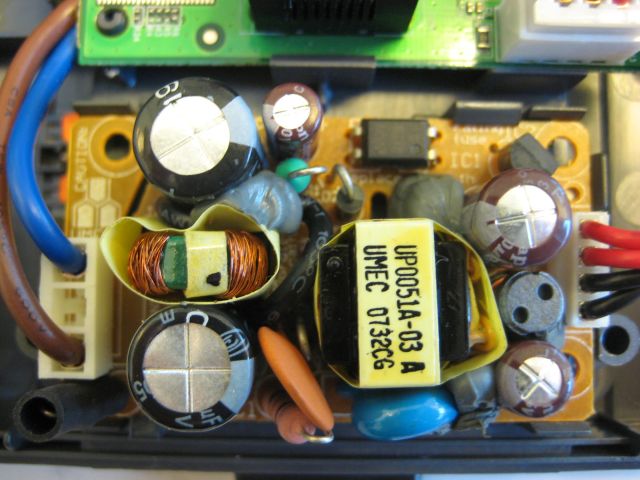

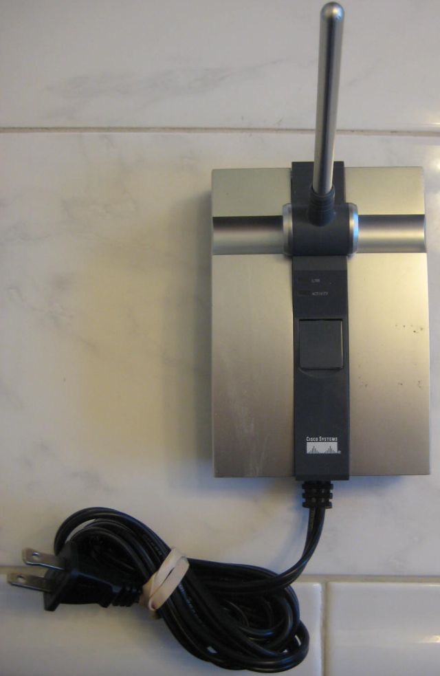

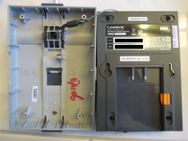

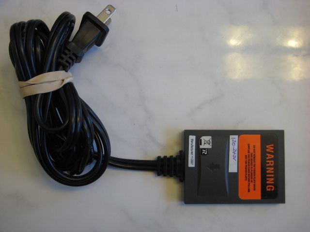

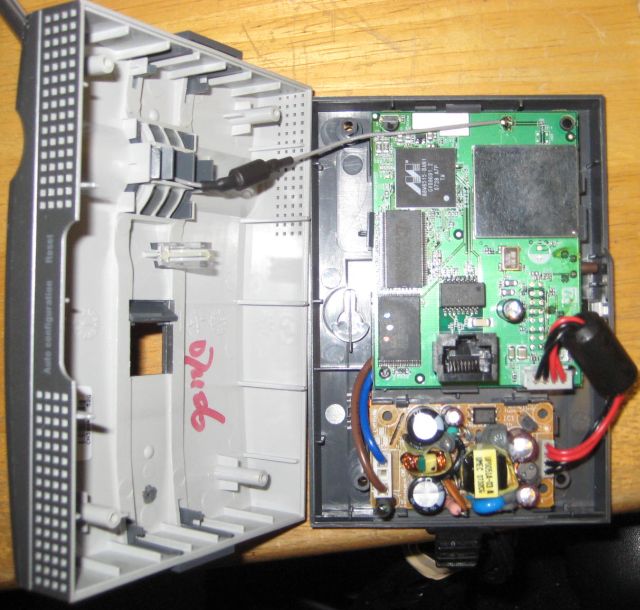

    Just got two Cisco/Linksys WRE54G WiFi extenders manufactured in November 2007 that failed within a month of each other. Both failed to power up. The sliding 'power plate' in the back is only a passive cord adapter. Opening the box requires removing four screws under the rubber feet. As shown in picture 'open', the WRE54G has two boards [1] the networking board [2] the power supply board. On both failing WRE54G, the power supply was about 2 volts, too low to power up the networking board that requires 3.3volts. Both failing power boards showed bulged output capacitors C8 (CapXon 25V 220micF 105deg) and C5 (CapXon 25V 100micF 105deg): these caps are the two caps on the right next to the red/black output wires in the picture 'power'. Replacing these caps solved the problem. Hard to imagine that Cisco would use these CapXon capacitors that are known to fail as late as November 2007.

      They just bought the power supplies from an OEM which used Capxon. I would say FSP but I don't see any FSP markings on it.
      Can't say I like the live cables going under the PCB with the low voltage stuff but it's insulated properly.

          What sort of circuit does this use? (2-transistor, or IC)
          I'm a bit surprised that there is only 320uF on the secondary!

            I guess it does not matter much, it has output of a few watts at max. Surelly I would recap it with twice as much at least And there is also one crapxon and a few ceramics on the data board.

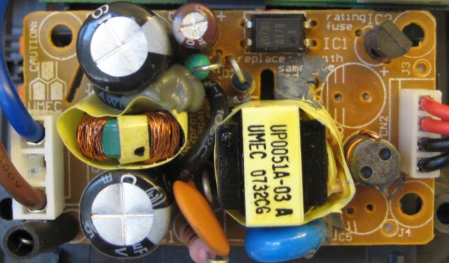

              I added some pics showing [1] the power board with the C3 & C5 caps removed [2] the ‘power-plate' slot and [3] the ‘power plate'.
              Power block: the power block is marked ‘UMEC' and uses an opto-coupler 817B as IC1, plus a reference voltage source AP432 717AL at IC2; I did not trace the schematics. C3 & C5 are on both side of an output choke CN2.
