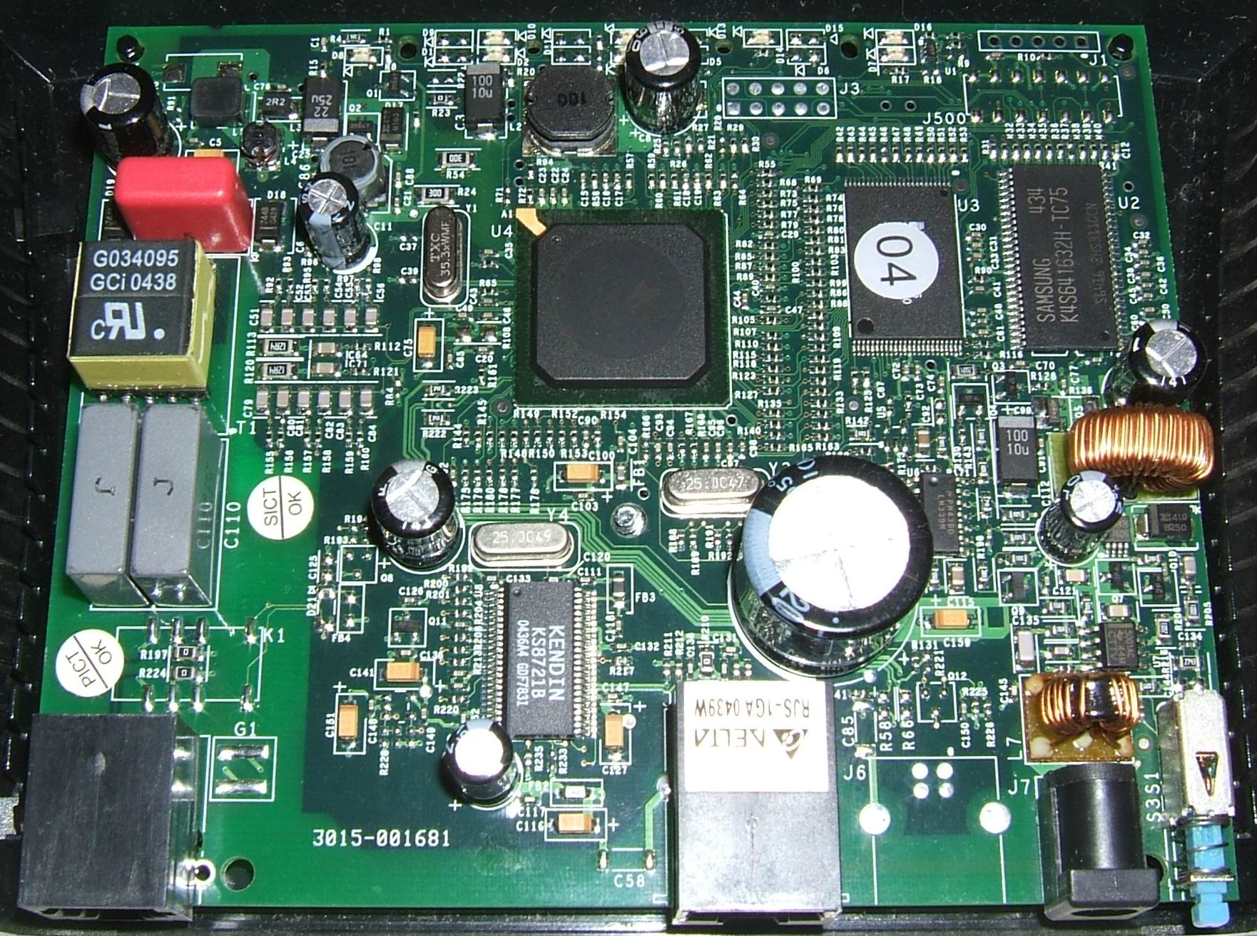

    I'm having difficulty figuring out how to open the case on this modem with destroying it.
    Q: anybody know how its done, safely?
    I'm thinking this one has bad caps.
    My internet service is spotty at 6mb due to distance from the central office.
    I do get 5.1 most of the team, but it craps out in the evenings.
    I switched out the modem with a 4100 model, and ran a direct cable from the MPOE to my router. Of course, it ran fine at 5.1 mb all night.
    I'm still thinking the 5100 needs a recap, but cannot figure out how to open it without destroying the case.
  • bgavin
    • Jan 2007
    • 1355
    Re: Speedstream 5100 DSL Modem
    I get to answer my own question:
    There is a single screw under the label on the back of the modem.
    There are six push-catches on the back cover.
    These are at each of the four corners. Push them in to unlatch the corner.
    Rear screw location
    Six push-in latch locations
    General board layout
    Other images are numbered -01 thru -16 on this page. All are HiRes.
    The board has two 18x18mm 2200/25v fattie caps H(M).
    Five 8x11.5mm 1000/6.3v, and one 6.5x11.5mm 100/25v. K(M).
    All are G-Luxon, none appear bulged or damaged.
    This unit runs pretty warm, probably in the 18x18 area near the 12v power input. Perhaps a forced cooling setup might be worth building for this.

        Caps can also dry out from heat. If you have a multimeter with a capacitance check, see if they are out of uF spec?

            Quite a difference between A02 and A08. A08 looks a lot more expensive to manufacture.
            Speedstream 5100 Part Number 060-E142-A02 030-5142-A02 3015-001681 0441
            C8: Panasonic 1000uf 6.3v NHG 8x12 Working Voltage WV=1.5v
            C9: Panasonic 1000uf 6.3v NHG 8x12 WV=3.2v
            C11: G-Luxon 100uf 25v SM 6.5x12 WV=11.75v
            C105: Panasonic 1000uf 6.3v NHG 8x12 WV=3.3v
            C114: G-Luxon 100uf 25v SM 6.5x12 WV=2.55v
            near C77: Panasonic 1000uf 6.3v NHG 8x12 WV=3.3v
            C112: G-Luxon 100uf 25v SM 6.5x12 WV=transformer voltage
            C89: G-Luxon 2200uf 25v SM 18x18 WV=transformer voltage
            Q6: IRF7606PbF MOSFET Micro8
            U7: TL5001AC PWM Controller
            U6: LM339M
            U4: TNETD7301GDU TI-AR7 ADSL to Ethernet CPU
            U8: Kendin KS8712B Ethernet Transceiver
            Nothing to fix here. Move along!
              I have an ancient 80's Fluke DVM, dunno if it has capacitance check or not.
              I recapped all the 1000/6.3 with MCZ 1000/10v. The operating voltage notes above were not known to me until after recapping, so the 10v capacity is wasted.
              I'm convinced the nightly slowdown is heavy traffic at AT&T, and not my modem.
