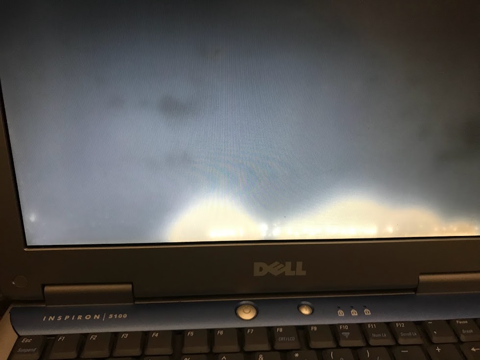

Dell 5100 laptop with bad video card and/or display (or what???)
  • 13mh13
    • Jun 2022
    • 10
    Dell 5100 laptop with bad video card and/or display (or what???)
    Laptop: Dell 5100 (2003). Note this is a different 5100 than the one I posted about in the 5100 memory/RAM thread elsewhere on Badcaps. I bought this (2nd) 5100 from local thrift store, for parts or possible full repair. I have no clue as to its history.
    When the pwr button is displayed, I should get the BIOS bootup screen (there is no HDD in this laptop). But I get a fuzzy, distorted screen:
    It should look like this:
    I'm getting no LED (coded) error message, and the other functions like battery charge and automatic power-off and no-memory detect are all normal. Just that display!
    Too bad I can't boot to the VGA output port!
    Anyway, on first hunch, please take a guess as to what the display issue may be?
    Last edited by 13mh13; 06-08-2022, 10:22 PM.
  • 13mh13
    • Jun 2022
    • 10
    Re: Dell laptop with bad video card and/or display (or what???)
    UPDATE:
    Connected an external VGA monitor and then did a Fn+F8 to switch to the external monitor .... and I have a good display.
    So I assume the LCD panel is toast? Or is it? Can it be some connector / corrosion issue?
