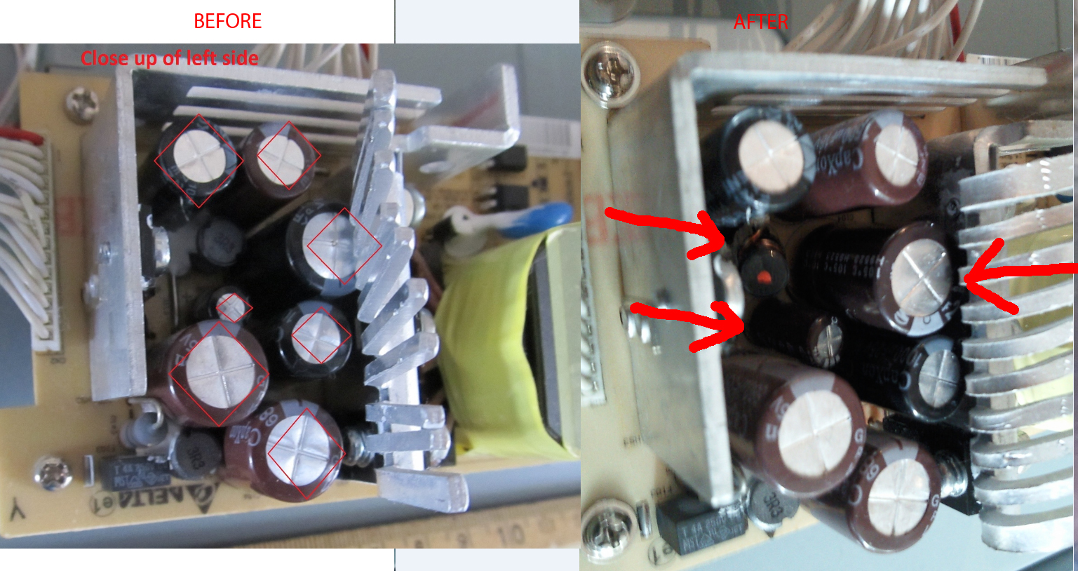

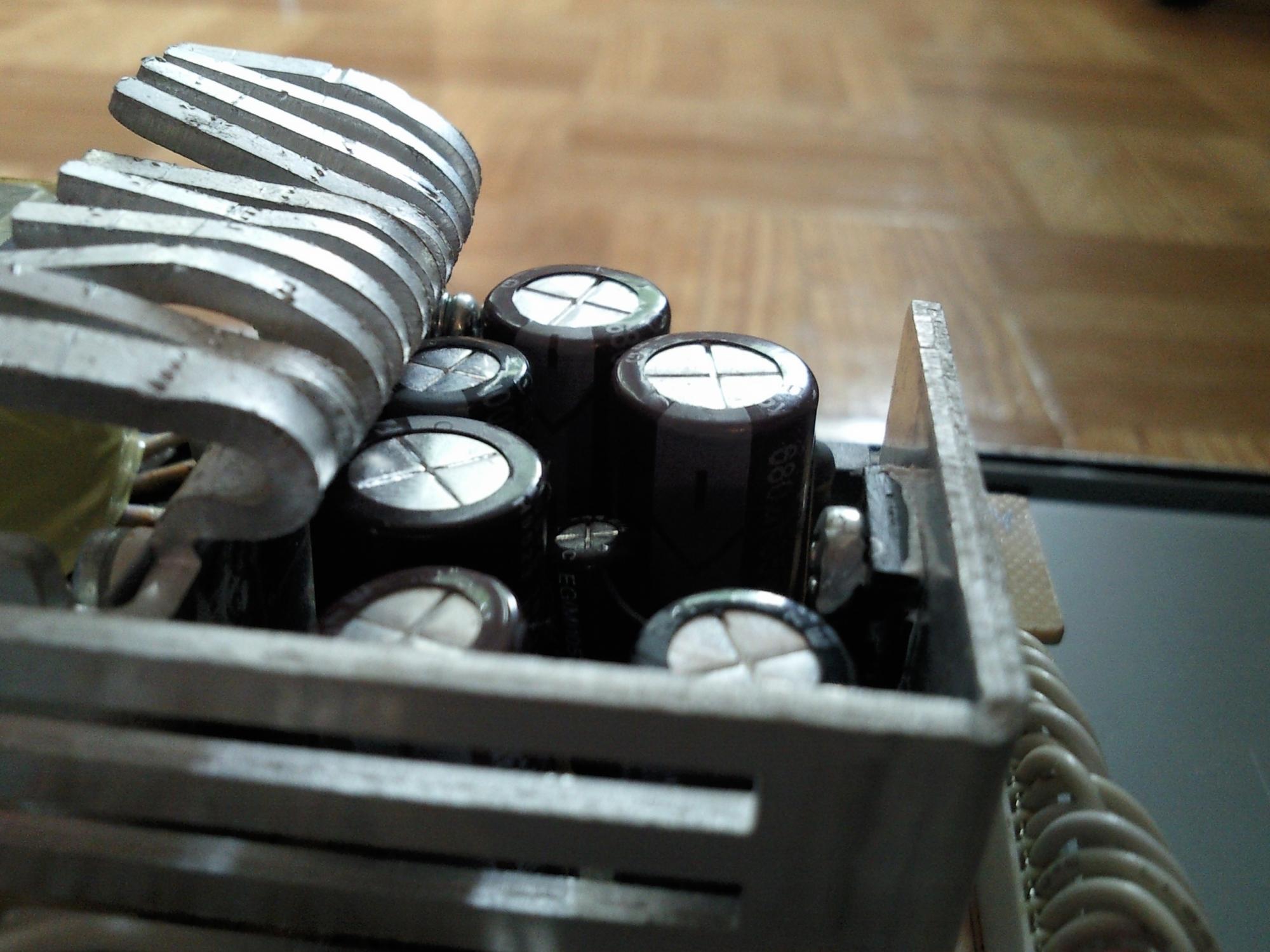

                                Re: Westinghouse L2410NM 24" LCD power goes on and off, blue light flickers
                                With cable to inverter disconnected, clicking is still present at about 4-5 clicks /second.
                                With cable to signal board and inverter disconnected, clicking is present at about 2 clicks / second.
                                first pic is before and after, the last two pics are after.
                                I took it to a shop since my soldering skills aren't very great. I'm not 100% sure what they replaced, but I pointed out the differences as best I could. They couldn't get it working and didn't charge anything.
                                  Oy!!! Well, at least they didn't charge you. In the second picture there is a small cap just to the left of the main SMPS transformer (DCGM 0723S). This capacitor is critical to proper startup.
                                  In the first pictures it appears an inductor has been replaced. It the first picture it's labeled 3R3, in the second you can see the windings.
                                  Also, one obviously bulging cap was replaced. What is the brand and series of the replacement?
                                  PlainBill

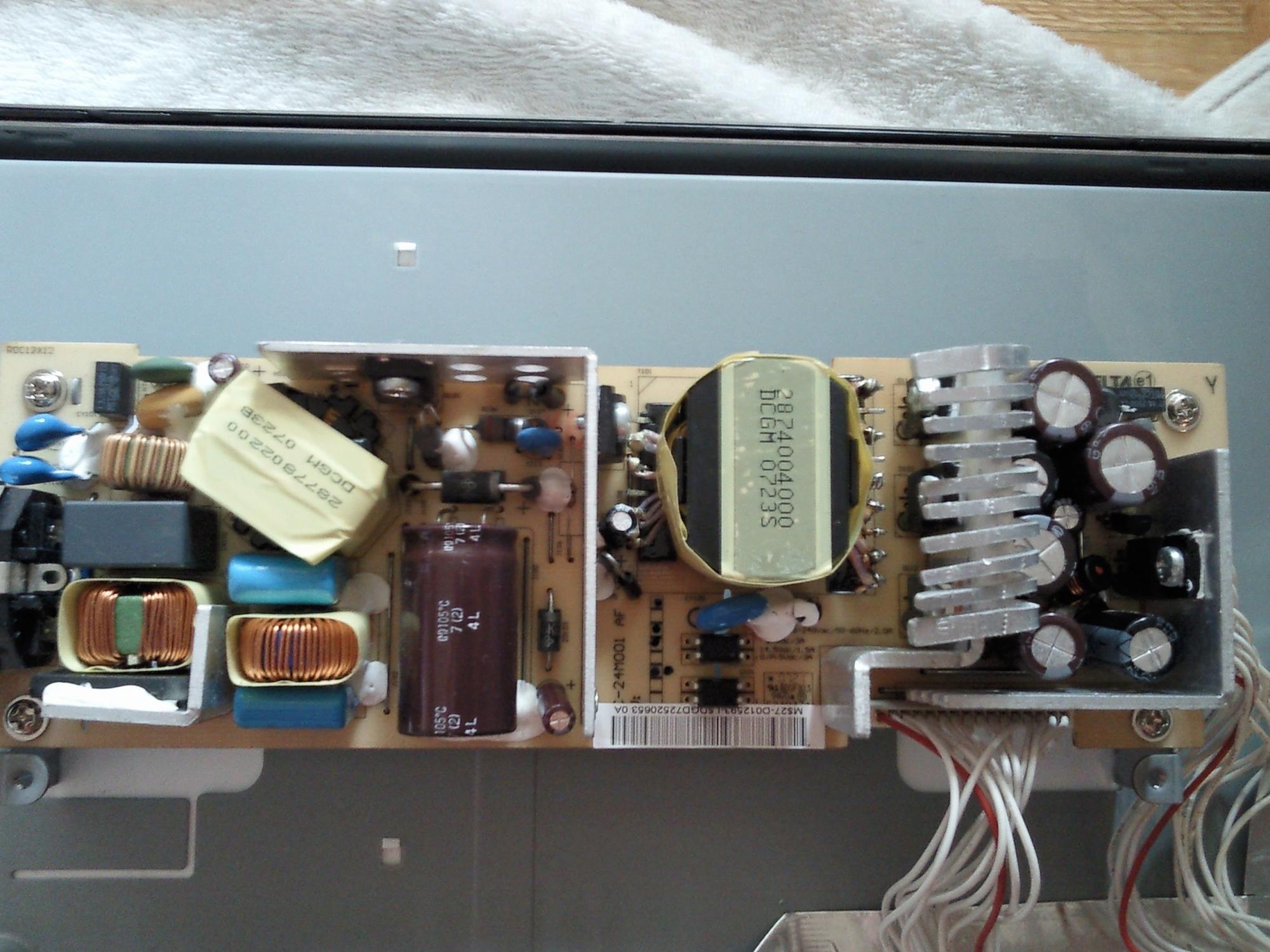

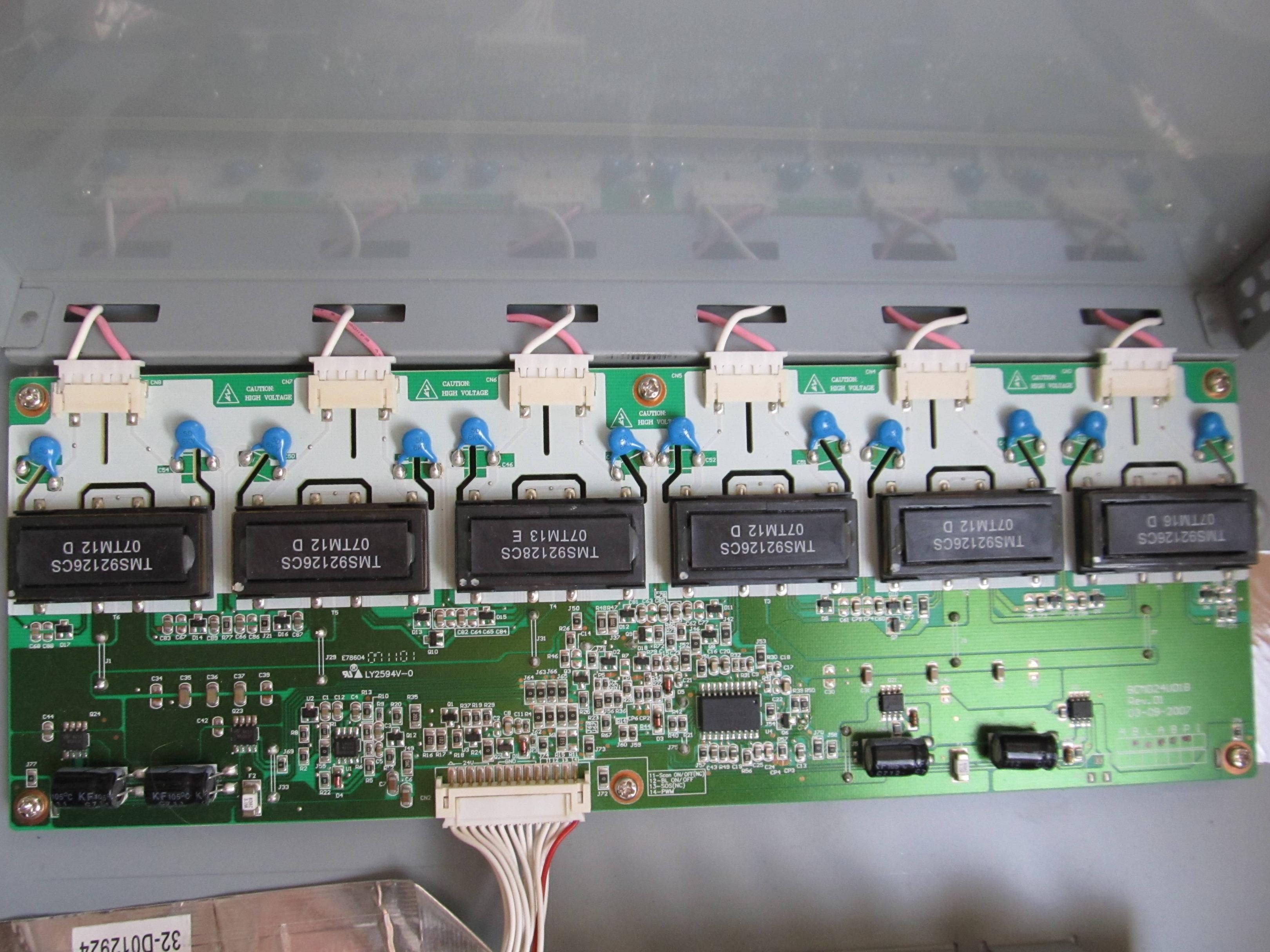

                                        Some good focused photos of the main and inverter boards would be helpful.
                                          Here's pics of the main board, inverter, and the new power supply. Thank you.
                                          Main Board:
                                          Inverter board:
                                          New power supply:
