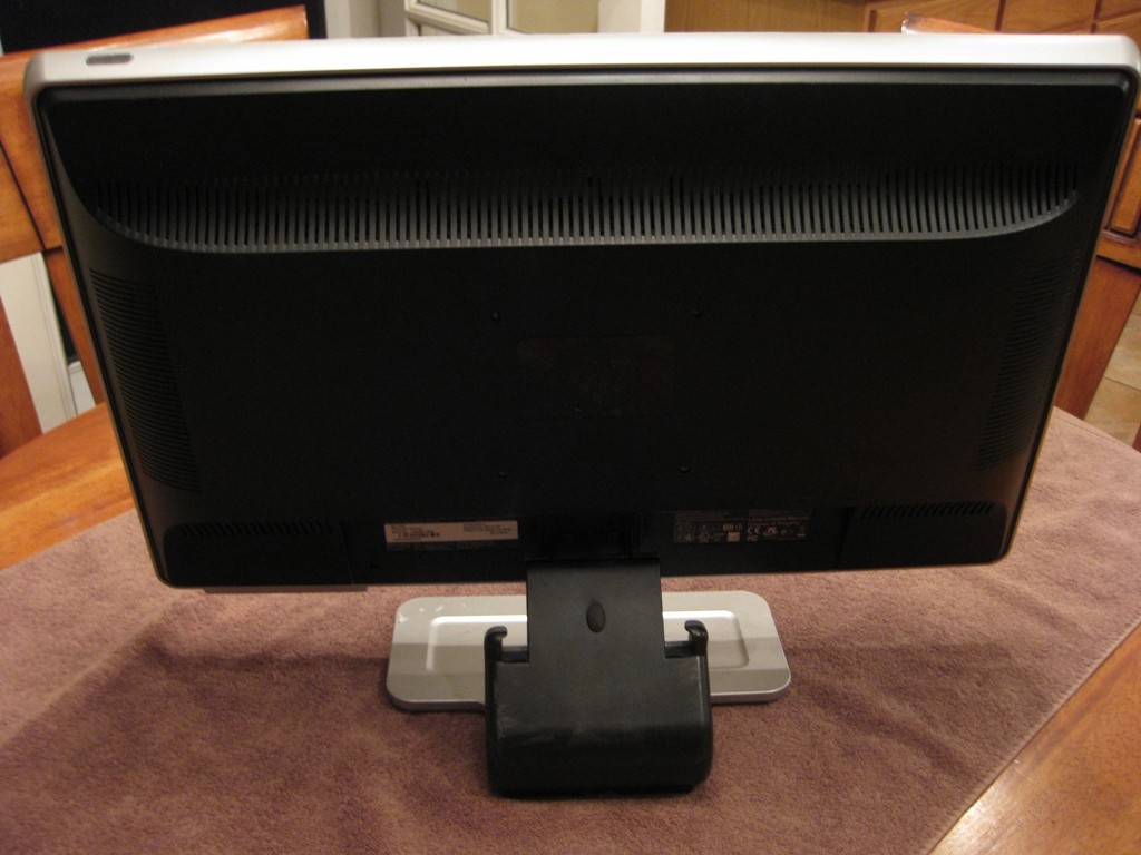

    I picked up this HP w2338h the other day. I've spend quite a bit of time trying to figure out how to open it up. So far, I don't see any way short of a hammer!
    If anybody has any experience with this, I'd appreciate it...

    it is most lickley like a hp w1907.
    look on the bottom of front bezel for 2 retainers that pop thru the bezel.Snap those out and gently work your was around the front of the monitor.
    I think I used a small hooked pic tool to work the bezel off.
    If you search w1907 you should be able to get a better answer

      Re: HP w2338h, need help opening it up
      Originally posted by sghill99
      II've spend quite a bit of time trying to figure out how to open it up. So far, I don't see any way short of a hammer!
      Be careful when opening because there may be fragile connections, but this video gives you an idea
      http://www.youtube.com/watch?v=Ul5LhuCT1y8
      You basically need to pry the thing apart.
      After it is apart, post clear focused pictures after reading
      https://www.badcaps.net/forum/showthread.php?t=1868

        Thanks much, I used both of your suggestions. I searched youtube for the w1907 and found this...
        http://www.youtube.com/watch?v=A8XV4L0klO8
        Shows how to pry off the front bezel...
        Thanks much guys (or gals)......
