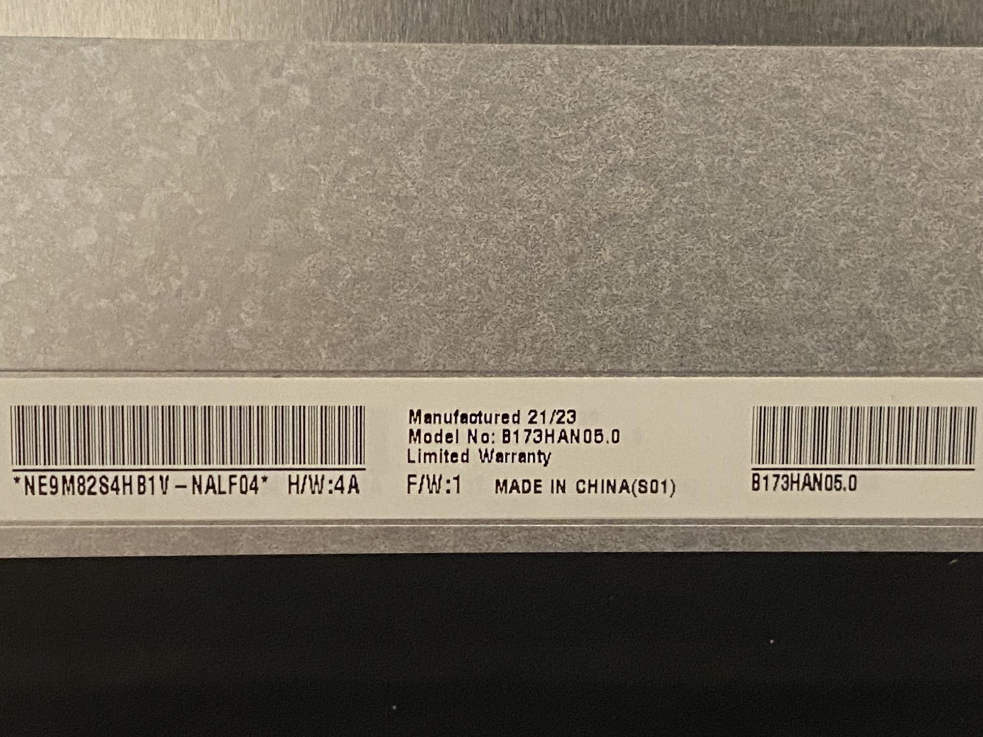

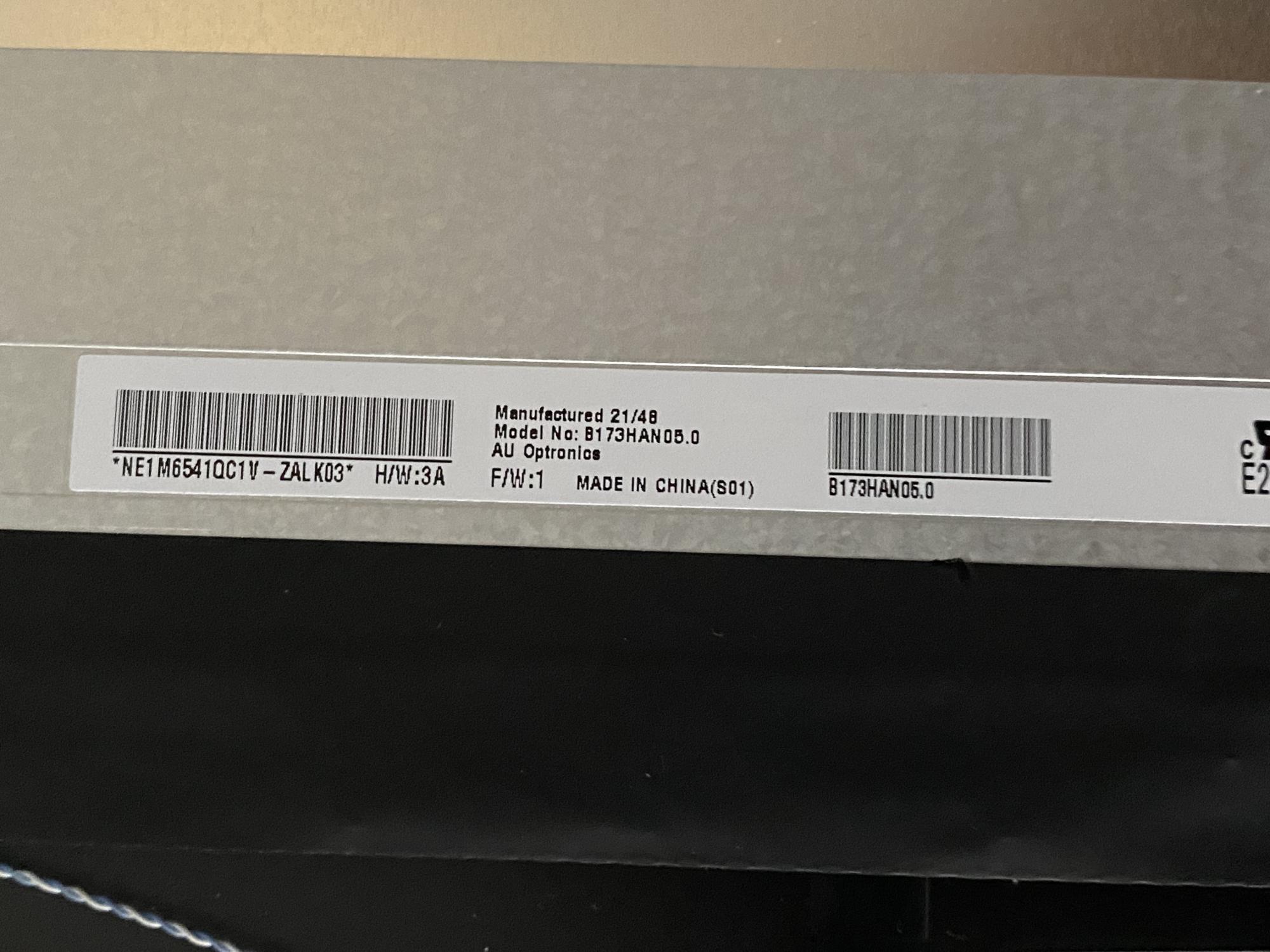

    I have this problem : replaced display B173HAN05.0 HW3A with B173HAN05.0 HW4A and the monitor doesn't run on 240Hz. Connected to laptop it's show 240hz on settings but setup on that refresh rate the screen is flickering black. If I choose 144Hz is running ok.
    With the original display, B173HAN05.0 HW3A, smashed, I don't have any issue.

    Re: Asus XG17AHP portable monitor
    Pictures of the new and old display
      I decided to return the new display HW4A to the seller and to look after HW3A .
      If anyone knows a store in UK who sells this model B173HAN05.0 HW3A, please let me know.
        Hi guys,
        Just a quick update : display model B173HAN05.0 HW4A doesn't support 240Hz when it's installed on ASUS XG17AHP, working fine at 144Hz.
