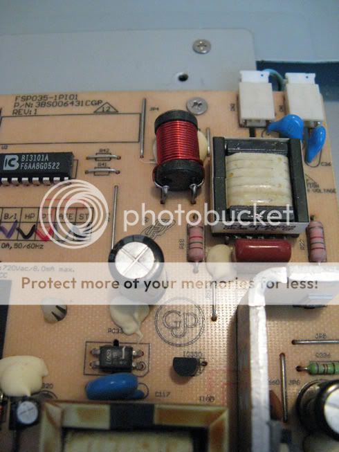

    Hi all.
    I have been frequenting this forum for a few months now, educating myself in the ways of the Capacitor.
    Using my new found knowledge, I successfully replaced all the Caps in the power/inverter board of my ViewSonic VX924 monitor.
    However, after doing so the symptoms persisted (screen flicking on and off).
    So I then decided to replace the power/inverter board with a new one via China.
    Only to find that this didn't fix the issue.
    Does anyone have any ideas as to what I can do next?

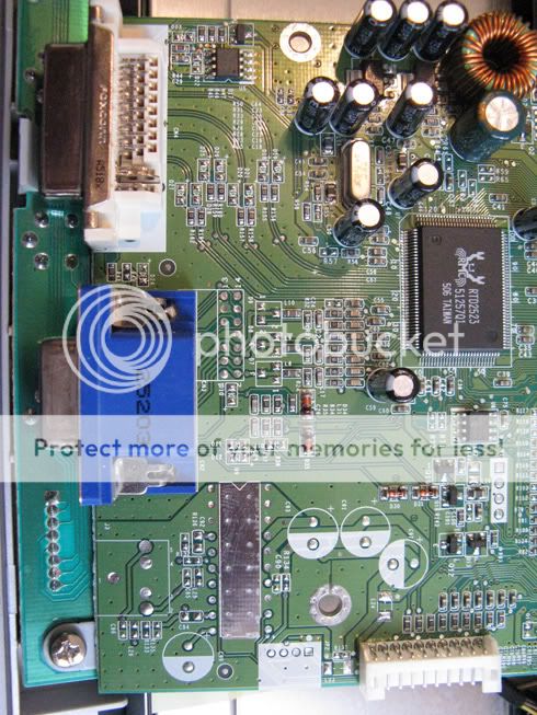

    I assume it might be the logic board which is at fault,
    this I have not touched.
    The main reason for this is I couldn't get to it properly due to bald screws.
    Thanks in advance,
    Tony.

      Re: ViewSonic VX924 - The Saga Continues
      Hi there retiredcaps,
      Thanks for the quick response.
      Regarding the symptom:
      The monitor seems to go to standby/sleep mode randomly.
      I can turn it on again, but it will turn itself off again randomly.
      Some times it will turn itself off and back on, either once or multiple times.
      When it is turned on, the power light should be green,
      but it is orange all the time now. Orange is for standby!
      Regarding the new caps:
      The Caps I used on the original power board were a mix of Panasonic and Rubycon, purchased from a reputable UK seller.
      But I have now replaced the original power board with a new/used one,
      as pictured.
      I was unable to upload the photos to your server using FAQs details,
      so have hosted them else where.
      Power Board Pics:
      Logic Board Pics:
      Hope the above images are OK.
      Thanks again,
      Tony.
        got a 12V powersupply with at least 1.5A handy? (2.5+A would be better)
        if so, you could "inject" it to the pinheader connecting the powersupply/inverter board to the logic board.
        or just solder 2 wires with the right polarity to the cap right next to the pin header.
        that way you can determine if the logic board is OK or not and make sure it's not the power/inverterboard's fault.
        if it still randomly goes into standby mode, it's most likely the logicboard.
        identical PSU/inverter board as in the Belinea 101910 and the viewsonic VX910 (and possibly a lot more monitors)

                This board looks very familiar to me.
                Maxdata/Belinea 19" TFTs use the exact same one. I repaired many of these, Sucess rate was high.
                Caps: Throw out each any any on the PSU. Ive used Rubycon ZL 470/25V, Rubycon AXW (later Panasonic ED) 100/400V, and Rubycon YXF for the small one.
                For the logic board, replaced the large Teapo with 470/25V ZL as well.
                The small cap on the PSU board (iirc 47u) is dry usually, and causes the PSU to do strange things like not starting or sometiomes shutting off !!
                Also resolder every large component, especially the power transistors/diodes. FSP typical RoHS soldering, cracks all the time.
                                So, seeing as the power-board is not the issue,
                                is it likely the logic board at fault, and if so can this be replaced easily??
                                G.
                                  Have you replaced any capacitors on the logic board? IIRC i have had to replace them on both the power and logic boards.
