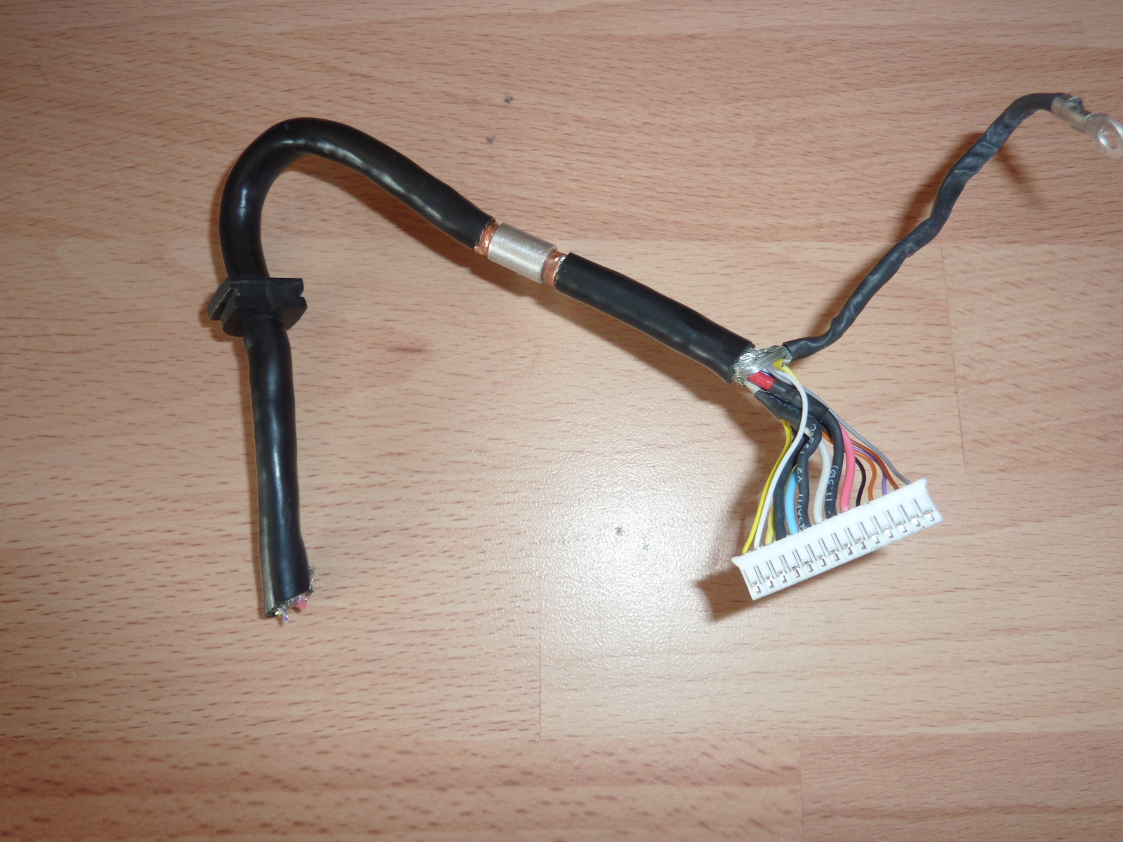

    Help please, I have a Hewlett Packard L1702 with a cut video cable.
    the connector is a 14 pin connector (see picuure). I have worked out that
    pin 2 = V-sync
    pin 3 = H-sync
    pin 4 = Blue return
    pin 5 = Blue video
    pin 6 = Green return
    pin 7 = Green Video
    pin 8 = Red return
    pin 9 = Red video
    pin 11 = DAT-DCC
    pin 12 = CLK-DCC
    I can not work out what is pin 1, 10, 13, 14, (RXD, TXD, VGA-CON, PC5v).
    I have found a service manual but the connection is not the same this one.

    See this:
    http://www.theavguide.co.uk/view_page.php?page=18
    Don't you have the necessary pins already?
