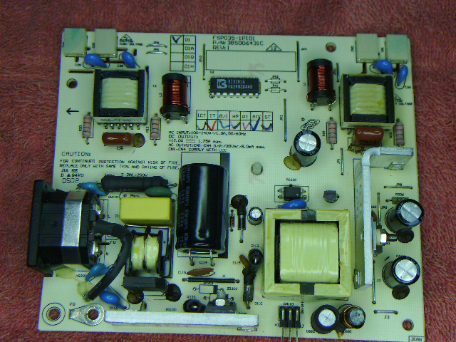

    I am having a power problem with my VX910. The green light on the power button will light up however the screen remains blank. After a few seconds the screen will give an image for maybe 1 second. Once that image appears it quickly vanishes and the monitor power cycle through this process repeatedly.
    From what I've been reading online these monitors seem to have quite a few issues with bad caps and other power issues however I don't know which parts should be replaced.

    Open up the case, post pictures of the power supply board - top and bottom. (Note the link to the proper procedure for posting pictures in my signature.)

        I'd like to beleive that all problems come from the power board however this is not true. There is a digital processing board that is in this monitor also. Whenever possible, post a pic of it (front/back) also.
        What type and values are the caps on the power board?

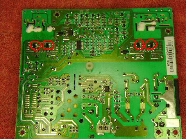

          Not an exact match for the symptoms I am seeing, but check the transistors I have circled to see if they are shorted.

              Is it ok to test the transistors while still on the board? I had done some initial testing after getting your reply and the readings I was getting were rather odd. It seemed like however I placed the leads on my meter I always got a reading from it.

                OK, a newbie. We can handle that.
                Yes, you can test the transistors without removing them. Here is the procedure I use:
                Set the DMM to the lowest ohms ohms range - typically 200 ohms.
                There are three pins on these transistors (in the picture above, the pin at the left connects to the middle pin on the right). Numbering the pins on the right 1 - 3, measure the resistance 1 to 2, 1 to 3, and 2 to 3.

                  I numbered the pins from the bottom to the top like I have below.
                  -3
                  -2
                  -1
                  For the transistor on the far left of the picture I got the following readings
                  1-2, 16.8
                  1-3, 8.9
                  2-3, 25.2
                  The next transistor ( second from the left) gave me these readings
                  1-2, 25.4
                  1-3, 9.1
                  2-3, 16.9
                  The two transistors on the right side of the picture do not produce a reading when connected from pins 1-2 and 1-3. They do however produce a reading of 168 Ohms when connected at pins 2-3.
                  I have attached a picture of my meter in case I may have a setting incorrect. Better to get something like that sorted out now rather than later.

                    Good idea posting the picture. You did the measurements properly. That 9 ohms sounds a little high, but the comparison to the other side indicates there is a problem.
                    If these transistors are the ones I expect, they should have the letters DK on one end, and Qx on the other (x can be any letter; on mine it was H). The actual part number is Rohm 2SC4672 and they are available from both Digikey and Mouser for about $.75 each.
                    Check the transformers, capacitors, etc. The service manual for a Belinea 101910 fits this monitor.

                      now that you say it, i remember where i've seen those insides.. in my own Belinea 101910
                      caps are the primary suspect.
                      if you have an external 12V power supply with at least 1.5A, you could try to hook it up to the powersupplie's output pins while it's connected up.
                      sort of like this (notice the 2 wires going into the connector between the PSU and controller board)
                      that way the monitor should turn on.. easiest way to test if the inverter part of the powersupply and LCD controller board are OK.
                      i think the pins were labeled. if not, follow the traces from the pins to the cap right next to that pin header (on the power supply board!) which connects both boards. that's your "12V injection point"..

                        Thanks for the help, ordered the transistors and hopefully will be able to report a successful repair.
