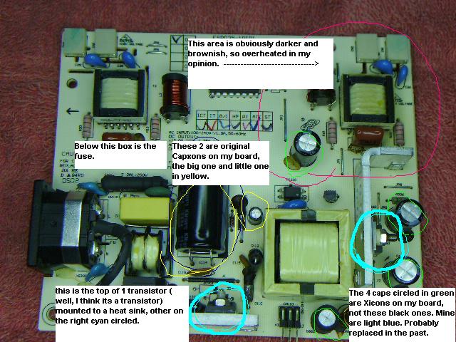

          Also, looking at this board a little closer, I'm thinking these caps have already been replaced once. Well, the Xicon ones anyway.
          Xicon? Are they blue or light blue by any chance? If so, perhaps someone has recapped it indeed (with the wrong type of caps, that is). If I'm not mistaken, Radio Shack sells those Xicon caps - and they are definitely not suitable for monitor repair.
          • ajsemtb
            • Jul 2010
            • 79
            Re: Viewsonic VX910
            Yes they are blue and the 35v ones instead of the 25v ones I've been reading about.

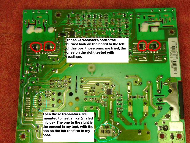

            And RetiredCaps, I don't have access to a camera right now, however, in the 5th posting of this thread are pics from PlainBill with the transistors boxed in Red. Those are the ones to which I'm referring. Also, I did a test on the transitors that are attached directly to the heat sink, and I'm not sure which leg is actually which, but number 1-2-3 from right to left when upside down I'm getting these ohm readings:
            1-2 the number starts at 1k and starts climbing, and doesn't stop
            1-3 .1ohms
            2-3 is 4.7m and counting down...
            Honestly, I have no idea what his means.. LOL
            1-2 15.71m and counting down
            1-3 9.05k
            2-3 14.94k and counting down
            Also, I found the fuse, it was heatshrinked in black but I'm getting a reading of .2 to .1 ohms on it as well.
            https://www.badcaps.net/forum/attach...1&d=1280705628
            https://www.badcaps.net/forum/attach...1&d=1280705635
              1-3 .1ohms
              If pin1-3 on the transistor reads 0.1 ohms when it is out of circuit, it is definitely shorted (bad).
              The fuse is okay at 0.1 or 0.2 ohms. Some multimeters have a lower resistance for their probes.

                  Ok, well I'm sorry again, but I didn't remove it from the circuit... I thought I could test these still installed to the board. :/ SO, this all being said, which caps do I need to buy, and when I type in the search engine at the digikey or mouser or whatever the other one was, there are 600 options that all say the same thing for different prices. What specifically should I buy for caps and the tiny transistors on the bottom of the board? What has been used in this installation before and has worked? The parts range from .29 to 2.89 which is a heck of a swing, and I would like to do this repair for less than buying a new power supply board.
                  Regarding the transistors mounted to the heat sinks, I'll remove them tomorrow and retest and post results.
                  Thanks again for all your help, I'm learning a lot as we go along.
                    Not only are they not suitable for monitor repair Xicon's light blue GP caps are 85C rated. Only their radioactive green GP caps are 105C rated and even those aren't suitable since they're GP.
                    Definitely a Radioshack special you've got there.
                    When measuring the transistors be sure to use the diode check function on the meter and not the resistance function. You're testing for voltage drop not resistance.
                      You can test transistors in circuit, but sometimes depending on how they are laid out, the results may not be 100% accurate so you need to remove them and test them out of circuit.
                      You need to make a list of the uF V, height and diameter of each capacitor and then follow PlainBill's instructions at

                            I didn't replace the really big one or the tiny one right next to the big one. I replaced the tiny transitors on the bottom. There is a difference now, as the screen at least flickers ever 2 seconds when the light blinks now. That is new. I hear a clicking each time it tris to turn on though.
                            When I installed the transitors, I tested them compared to the pair that I think work, and they gave me the same readings. Well, after my test, I think they shorted again, because for voltage they were at .270 and now they are .023. So that sucks.
                            The little cap is sometimes called a startup/run cap. It is usually in the 1uF/2uF 50V range or something like 22uF/50V. That cap doesn't have to bloat to be bad.
                            The clicking sound maybe the SMPS trying to startup. The little cap helps the SMPS startup.
                            Which leads to ... replace the little cap. That may solve the problem?
                            If the transistors are shorted again, resolder all the transformer pins (the 2 yellow things marked with T). Remove the old solder and resolder with fresh solder.

                              Quote from ajsemtb: I think someone said to change out the 2 ceramic capacitors... What are those and what do they look like? Also, what is the white "square" thingy on the top of the board that has a matching one on the other side?
                              If you're talking about the "square" units wrapped in yellow tape, those are the inverter transformers, which generate the high voltages required to light the backlights.
                              As for the two capacitors: I think what the person is talking about are the brown (or dark orange) caps directly below each inverter transformer. From memory, I think they are polypropolene caps stamped "154" and rated at 250volts. These caps have a tendency to fail and might be the cause of your problem.
