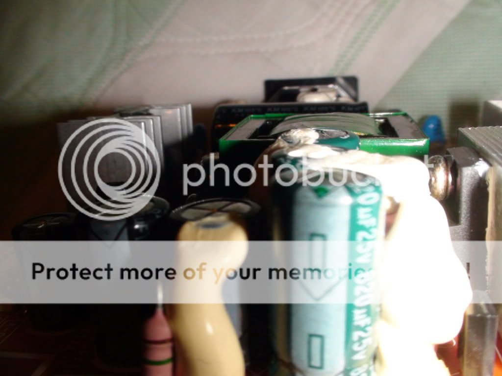

      I looked at the lcd board and it looks like three green capacitors are swollen. but im not sure if that would cause the problem.
      I do hav a soldering iron because I fix other electronics like psp's 360's ipods phones and just resoldering wires. But I have never fixed a monitor before.
      here are the pictures:

        Replace all the caps with low ESR name brand caps. Check the FAQ for acceptable ones and sources.

          Is it okay to have a more Microfarad capcitor then the orginal one that was bad but have the same amount of Voltage?

            Yes, but don't go overboard. If the original is an odd (read "less likely to be found as a stock line") like 820uF then go for 1000uF. But normally there is no need, and sometimes it will catch you out as the size will increase and it won't fit in the original space.
            The main things are:
            • 105C, low ESR, quality brand/series
            • no lesser voltage rating
            • no lesser capacitance
            • check dimensions

              thanks I just ordered three caps.
              How do I know where the fuse is located on the board?

                The fuse is the brown plastic cylinder next to the AC jack.
