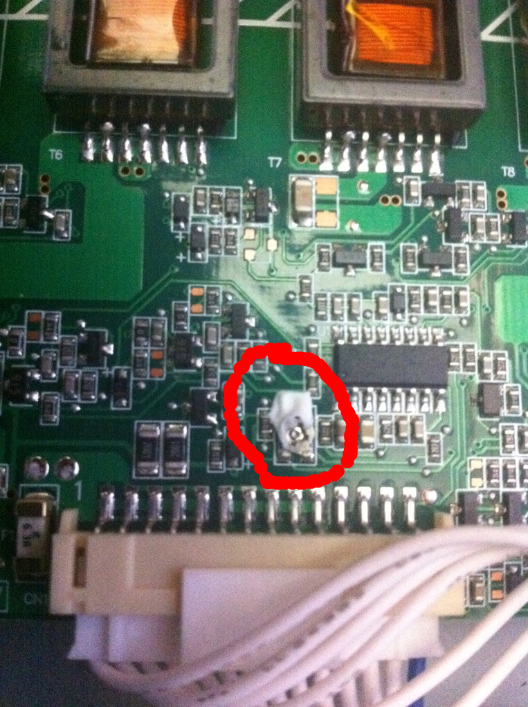

                                  i noticed this...not sure what it is or if something was supposed to be there. monitor was never opened

                                    Re: Samsung Syncmaster 245BW
                                    It looks like a pot covered with goop. Manufacturers frequently do that.
