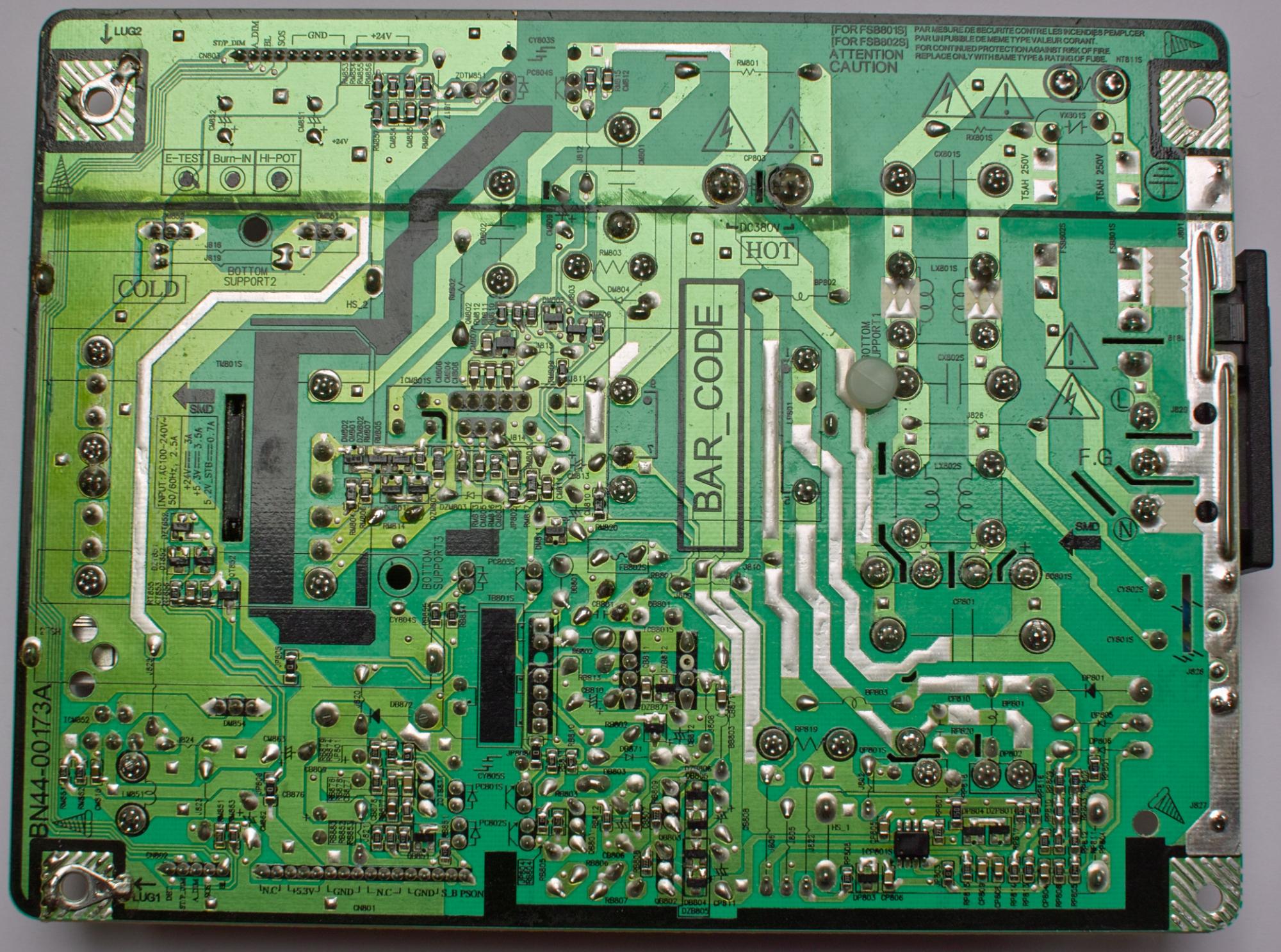

                              Let's try working through this logically. I've attached a picture of the bottom of the power supply. Note the area outlined in blue. That contains the control line for the main power supply. Unfortunately the contrast is poor, and I can't trace the signal path.
                              Step 1. Using the Gnd pins within the blue area, do either S_B or PSON change voltage when the front panel power button is pushed?
                              Step 2. Above the area I circled is a long white label. Above that are the words 'HOT" and 'DC380V'. And above those are the solder pads for two leads. Understand what those mean - there is 380 VDC across those points. That is more than enough to give you a painful jolt, so BE CAREFUL!!!
                              The left one of these appears to be ground. Use that as the reference (ground) point for the following test. Back at the area in blue note PC802S. That appears to couple the control signal for the power supply. Does either of the two right hand pins of PC802S change voltage when the Power button on the front panel is pressed?
                              If they do, I will need better pictures of that area.
                              PlainBill

                                #175
                                Re: Samsung Syncmaster 245BW
                                I provided some better photos. In my case I measured the QM802 and althought it should be a npn transistor from my readings I would guess it's a pnp transistor. So I think I should replace it.
                                I'm from germany . I would be glad for some pointers on where to get the replacement. So far I just found shops which only sell huge amounts.

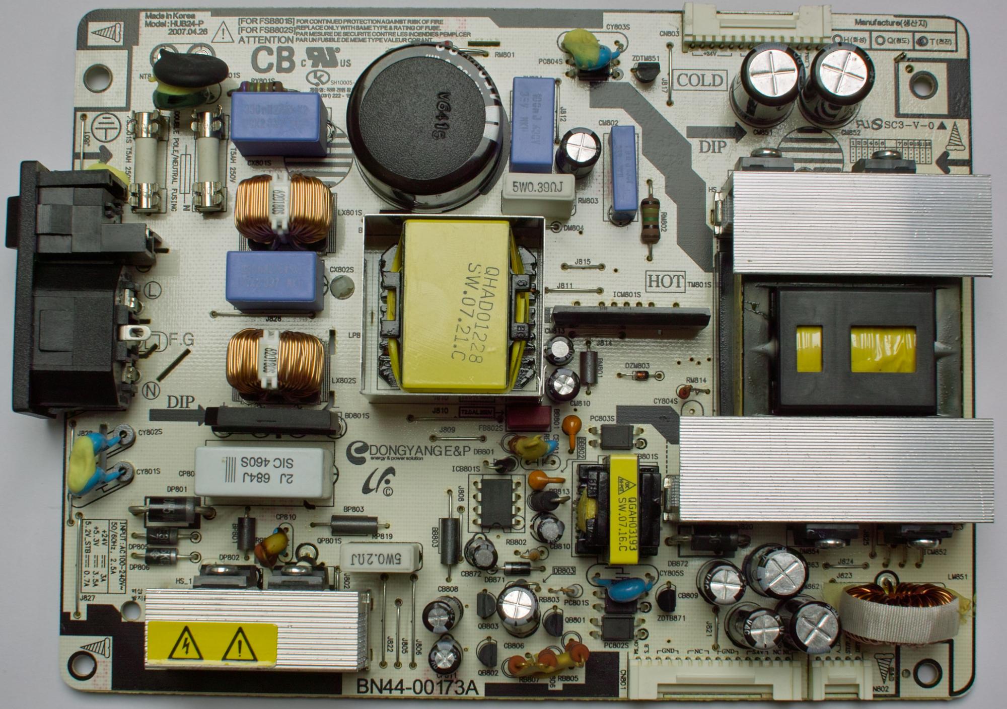

                                • bonney
                                  • Oct 2008
                                  • 74
                                  #176
                                  http://obrazki.elektroda.net/73_1280397270.jpg
                                  Drawing of PSU
                                  • bonney
                                    • Oct 2008
                                    • 74
                                    #177
                                    http://obrazki.elektroda.net/22_1280397270.png
                                    and F9923L
                                        since no one has answered yet, I did the tests. In my case, I don't have 24V.
                                        Yes they do. Standby is (as the name indicates) always at 5,2V. PSON shows 0V when the power button is off and about 3,6V when ist on (blue light).
                                        Althought there are no marks on that picture i just followed your instuctions. When the power button is off there ist just around 30V sitting on the bottom pin. When power button is on (blue light) there is also 30V on the upper one.
                                        PlainBill
                                        In a few hours from now I will provide a macro shot of this area. I just need daylight.
                                        I hope I could help.
                                        Soon I will get two more broken TFTs. I'd be glad to find a solution. I'm still checking. After reviewing my results I have to corect my previous remark about tne QM802. I confused emitter, collector and base. The transistor seems to be OK.
                                          Good work. No further pictures are necessary, thanks to bonney who provided a schematic.
                                          In an earlier post you asked about RB813. The measurements you made, the function of the resistor (current sensing) , and the fact that the standby supply is working indicates the resistor is good. Not all resistors have color bands.
                                          I'm going to have to study the data sheet extensively to determine the meaning of the various voltages.
                                          PlainBill
