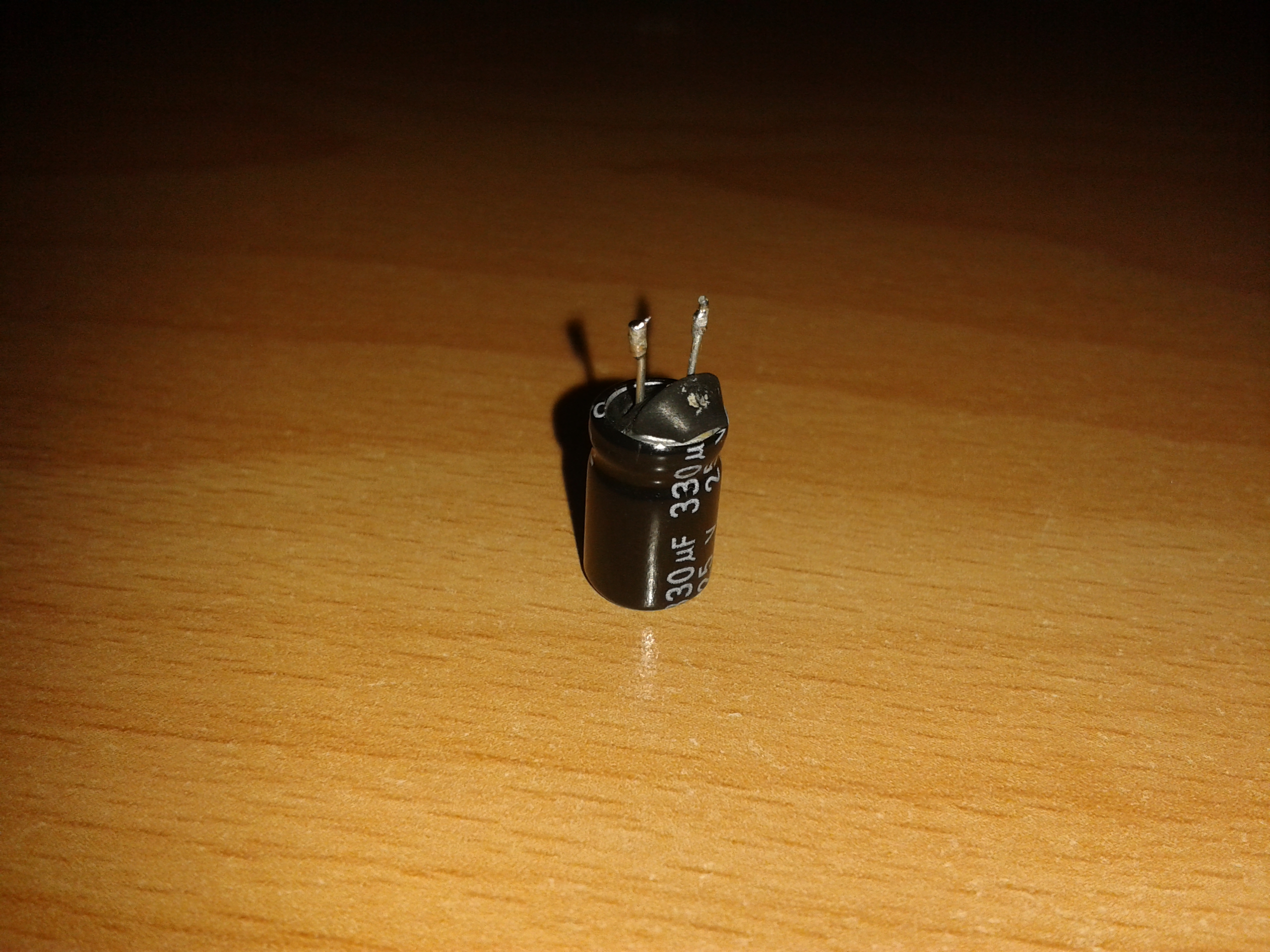

                                        Hi guys, i have the exact same problem with mine 2232Bw as you guys in this tread, bulging caps and all, so when i found this tread i decided to repair it just like the explenation here and that wonderfull youtuub video that explanes it wonderfull it really does, i went to a local electronics store in my city and the store dude sold me three 820uF 35V caps and one 330uF 25V cap, he told me the higher voltage wouldnt be a isseu, when i got home i started, it all worked beautiful, the old ones out the new ons in, perfect i thought but.. when i turned it on a small explosion in the back of the screen occurred.
                                        ok so i opend it up to see whats happening in there when i saw the smallest 330uF cap had blown up between the two connectors and one of the new bigger caps had a bulging top, so i replaced all the new caps with the old ones, turned on the monitor and it works just as before but offcourse with the flickering but at least i can use it for the weekend.
                                        now,. i dont think i did anything wrong here but what about the caps that dude sold me? they have to be wrong right? see pics below.
